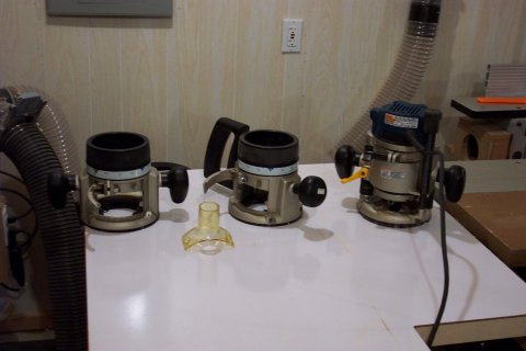

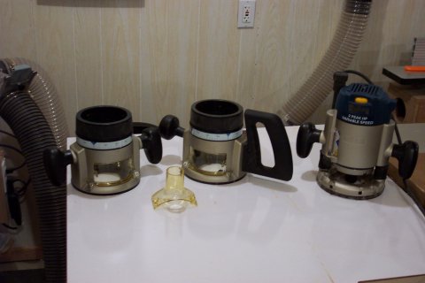

      Which of the following three bases is/are different from the kit you own? I'm not aware of any other version than what's shown below.
      Front view:
      Back view:
      The dust extraction fitting shown above mounts (via screws) to the back of the standard and D-handle fixed bases. I included it in the photo so that there's no confusion about whether either of the bases look different from yours.
      Each base has exactly the same hole pattern.

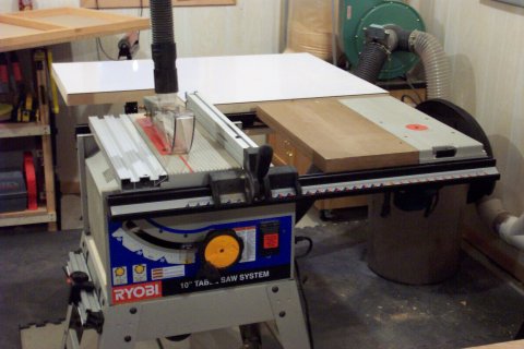

      You could always slide the rails of the saw all the way to the right, like this (pardon the mess, it was a busy shop day today)
      The piece of MDF that you see is just a filler table to occupy space. This would give you enough room to change the bits the way you would like.

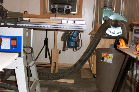

      Note that in the preceeding photo, that I have a different router (RE180PL) hanging from the table. I was using the 3-base kit today with bushing guides so that all I had to do was swap the motor in and out of the bases.
      There's plenty of room for a wrench between the router and the saw, there.
