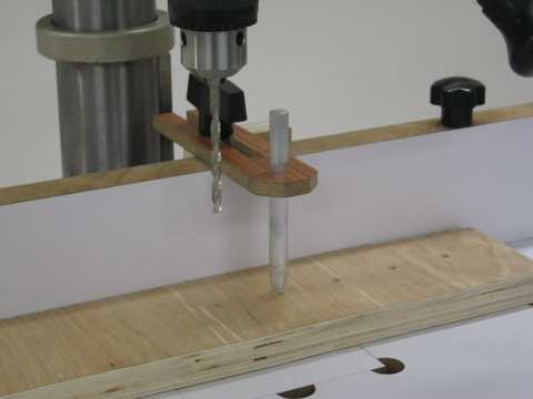

      A jig is whatever contraption you may come up with to help you perform an operation easier, faster, more precisely, or safer.
      For example., below is a picture of a jig I made to drill a row of equally spaced holes. By indexing the metal pin to the previously drilled hole, I ensure that next hole is always same distance from previous. Distance between holes is set by sliding the block jig mounts to along the fence, distance from board edge set by moving the fence, and then sliding the arm out.

        Not to sound ignorant (cause I am) but in such a case, couldn't you just measure and mark with a pencil where you wanted the holes ? I mean, the time it took you to think of and make the jig, wouldn't it be faster ? But I guess after the jig is made, you can use it multiple times which eventually makes things go faster and more precise. Again, I'm showing my ignorance in wood shop know-how as I've never used one obviously. I notice you have plastic knobs on the jig to tighen etc. Which means you pretty well have to be an inventor of finding the correct knobs or whatever to go with the wood jig you fabricate. Man, I'm far from being there. I really envy you seasoned craftsmen. That said, you had to start somewhere too I guess, but I'm sure most of you were a heck of a lot younger than me LOL. Better late than never I guess. Thanks scorrpio for the picture and explanation.

          That's part of the idea, yes. But the payback is quicker than you might think: the additional time and effort spent to make the jig is often offset by the time it saves the very first time you use it.
          There is, however, one very important additional reason to use jigs, which is that they will often save you from screwing up a very expensive piece of wood. You put the effort into, and make your mistakes on, the jig. When it is right, doing the work on the actual workpiece becomes almost an automatic, paint-by-numbers exercise in which it is much more difficult to make a mistake that would ruin the piece.
          BTW we all tend to use the word "jig" somewhat generically. Technically, the drilling jig that Scorrpio shows is not a jig, but a fixture. Jigs generally attach to the workpiece itself and move with it. Fixtures generally attach to the tool itself, as an extension of it. One way to remember the difference is, "A jig slides, a fixture guides." I personally equate the "fix" in "fixture" to "fixed," i.e., it doesn't move.

            I would say the accuracy increases with jigs. Marking 10 holes very accurately and drilling those holes is not easy. With this jig if you are off then you are consistently off. If you test on scrap then you are assured that you can repeat the process.
            My problem I don’t take the time to make the jigs.

                Trying to mark things like that is inherently mistake-prone. Easy enough if spacing is say, 2". But what if I need 1 7/32"? Try going over a 4-foot board, with a tape measure, adding these fractions in your head. Then, you'd have to slide a combination square to every mark in order to mark a point proper distance from the edge. And what if I am making a set of kitchen cabinets, and want all of them to have identically spaced shelf-pin holes?
                The jig itself was not long to make - I'd say an hour or two tops. And once you start doing things in your shop, you'll have sufficient amount of various odds and ends to use for jig materials.

                            When you move to the next hole, do you just pull the pin up part way and move the board. I'm assuming you do not have to loosen the knob each time cause that would require you to reset the arm in exactly the same spot each time.

                              All knobs stay put. Pin is sliding in the arm hole. Lift pin, slide workpiece till pin drops into just drilled hole. Pin end is ground to cone shape, but is not pointed - so it leaves no scratches. The arm is made from laminate flooring, very tough material with good wear resistance. The hole lets the pins slide free, but there is no wobble. I suspect wobble will eventually develop, but before that, I'll modify the jig - enlarge the hole and epoxy a short piece od 3/8" I.D. aluminum tube into it.
                              Great thing about this jig is that I can save about any drilling setup by drilling two holes in a piece of scrap. Then I can restore the setup in seconds at any time later.
