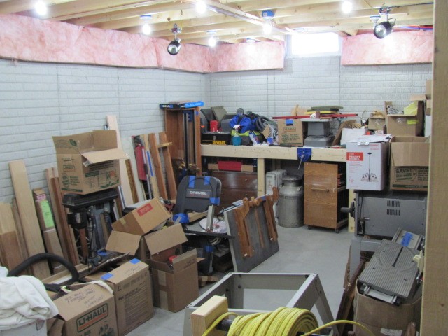

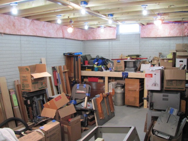

                      When I built my new shop (12'x22') I lit it with screw in LED lights. I arrayed 17 lights with each light covering about a 4' diameter area. I used GE Brite Sticks at 780 lumens each. It's worth noting that the daylight version is far "brighter" than the cool white version even though both were rated at 780 lumens. I was able to light the entire shop for less than $78 (boxes, bases, & bulbs). SWMBO complains that the shop looks like LasVegas, but I can see stuff very well with no shadows. Unfortunately, GE has stopped production of the Bright Sticks, so I will have to find an alternative in the future. I also have four 75 watt indoor floods on swivel mounts for color matching finishing.
                      Jim Frye
