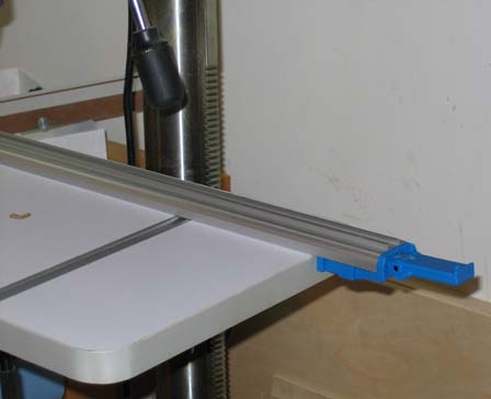

                I received my 2 36" clamps from peachtree the other day. The quality looks fine to me (Pic #1).
                I was a little concerned at first because I had to try it out right away and was playing with it in my kitchen on a formica countertop. If I pushed it hard from the side it was possible to make it slip a very little bit even when in the second position. However, when I took it into the shop and clamped it to wood it was very solid even with the lever only locked in the first position. And I'm talking about pushing at a direct 90 degree angle to the middle of the clamp, something that won't be happening in normal use. And I agree with earlier posts that position 3 will probably never be needed, but it's good to know it's available.

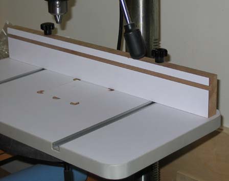

                One of the reasons I jumped on this deal was to use 1 of them for a makeshift fence on a Grizzly drill press table that I got a great price on (thru this forum) awhile ago. I liked the table but the fence was too high for the handles on the Hitachi B16RM drill press I have (also great price thru this forum). The knob on the fence forced me to keep the table lower (Pic #2) because the handle would bang into it as I rotated it otherwise.
                Anyway, the low profile of this clamp is perfect for just aligning stock and the simple needs that I have for this drill (Pic#3). I can make/buy accessories like a stop block as needed. Of course, 36" is way too long for the width of my table, but it doesn't interfere at all.
                I'm sure I'll find plenty of other uses for these. Given the price, I'm very satisfied with the purchase. Here is a simple walkthrough on how to use these from Emerson Tool's site: http://www.eemersontool.com/id10.html

                  You noticed too! Bad enough the fence is too high the danged knob of all places also has to be right where the handle swings.
                  I think my grizz cheapo DP table is going to be history one day. It's also too small front to back.
