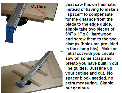

    These just got even better.

        You know, I saw that picture on the site but I didn't pick up on the functionality of it. That definitely makes things easier. I really could have used this setup last summer when I built a walk-in closet system out of melamine. Many cuts with a circular saw and measuring back from the cut line to allow for the distance to the blade.

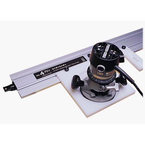

              On the page showing their saw plate, it looks the same as the trugrip soild one, see image below.
              Yeah, I saw that too. That's the old picture that they provided their affiliated vendors years ago. Notice the circa 1985 Skill saw. It was changed to the flatter black plate with the larger cut out to address the safety issue (per an e-mail response from the company). Here's some of the line up http://www.eemersontool.com/id22.html
