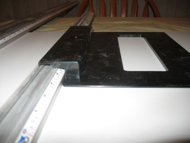

                            The ones in the link I posted above from Amazon, these from Peachtree, the ones from Rockler and the ones from Woodcraft with the green handles are all the same. Made by E.Emerson Tool Co. http://www.eemersontool.com/ .These are similiar in design but better quality than the TruGrip by Griset.
                            Keep in mind, these are marketed as edge guides moreso than panel clamps. The actual clamp is only about a 1/2" tall which isn't ideal for clamping, but they could work well on short stock.
                            These straight edge/clamps are both similiar and different to the EZ Smart guide system by Eurekazone. Similiar since the real benefit comes from using the circular saw or router mounting plates that E. Emerson makes in conjunction with the edge guide. There's a channel on the top that accepts the mounting plate wihich prevents the saw or router from moving the slightest bit from the cut line (the only drawback to the homeade sawboard which requires you to keep the saw or router pushed up tight against the fence - not at all difficult but a possible problem nonetheless.) Using the saw plate or router plates results in a perfectly straight cut. I use the router plate with the guide and a straight bit to joint large panel edges. Silky smooth results Different from the EZ Smart since you have to compensate for the blade/bit distance from the guide edge. The EZ Smart lets you place the guide right on the cutline. The arguement as to which one is better takes place here http://www.bt3central.com/showthread...ighlight=clamp I bought them after reading Scott's rationale.
                            I bought the double wide 8' which is really 102", the double wide 4' which is 54" and the regular 24". If I was to do it again I would get the regular version of the 4 footer from Rockler for $29. That is a GREAT price. I paid $70 from Amazon for the double wide and it really isn't necessary. .
                            These are quality made, lightweight aluminium guides. It would be best to dedicate a cheapo circ saw with a good blade to use with these guides and make the appropriate spacer so you can quickly line up your cut line. Push down on the handle. Done!
                            Greg
                            PS: FYI. For clarity purposes I removed my Circ saw from the mounting plate. You CANNOT cut it crooked if you tried

                              Wow, what a great response. You covered just about everything I wanted to know about these guides. The people on this forum are great. Thanks for all the info Greg (and pictures too). I'm looking forward to getting these.
