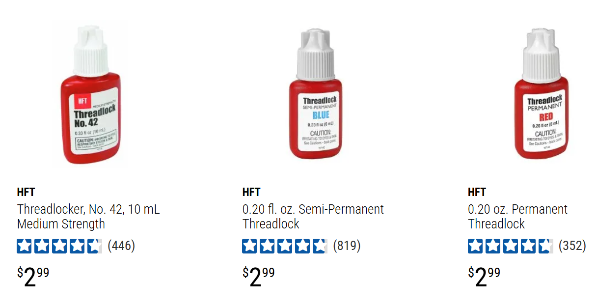

        Originally posted by d_meister
        FWIW, Harbor Freight has their own threadlocker in two strengths. Only one showed up in a search:
        https://www.harborfreight.com/search?q=thread%20locker
        Interesting they have 3:
        I'm confused as to the relative strength. Is the #42 medium strength stronger or weaker than semi-permanent "Blue"?
        Int he Loctite lineup, they have 222 purple, the weakest, 242, is blue which is the medium (semi permanent) they offer, the stronger being 262 red (Permanent)
