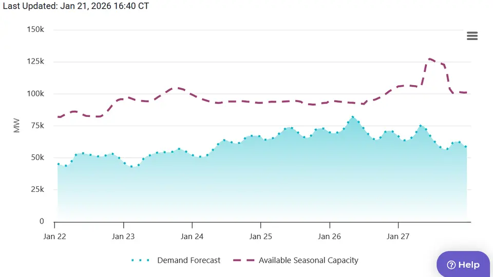

    Going to have a cold Norther come though Friday Night, Saturday, Sunday, Monday and Tuesday with temperatures down to the 21-22°F at times.
    In Feb 2021 we had a deep freeze that lasted 3 days and put much of Texas without electric power.
    Well, the grid operator ERCOT has said their forecast shows we have sufficient power margin. THis will be OK with limited outages due to falling iced-over trees and such.
    Click image for larger version  Name:	image.png Views:	5 Size:	107.2 KB ID:	862525
    However what killed the grid in 2021 was not insufficient planned plant operations but unexpected loss of power plants due to extreme weather - one of the big ones was the natural gas supply being cut off because heaters for the gas water condensation filters either failed or worse, were disabled by localized rolling blackouts. Gas companies did not know that they could apply for no rolling blackout status if they simply filed a form stating they part of the critical energy supply.
    Anyway, we hope they learned the lessons of 2021.

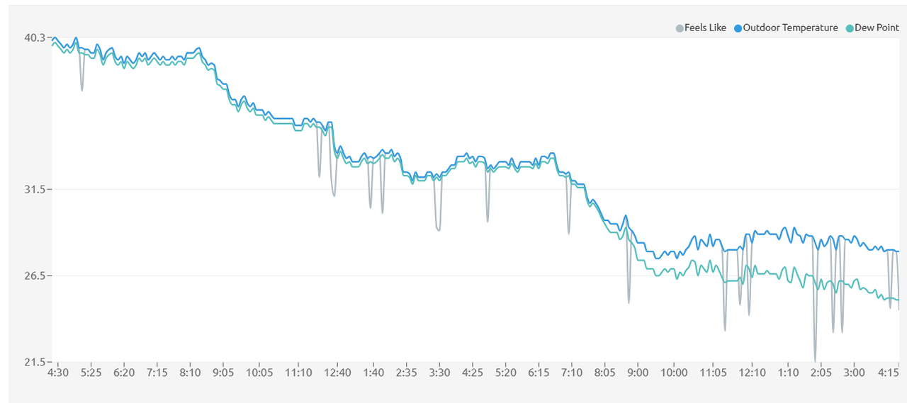

      temperature dropping all day long (Sunday afternoon 4 PM), never warmed up. Going to be 22 tonight.
