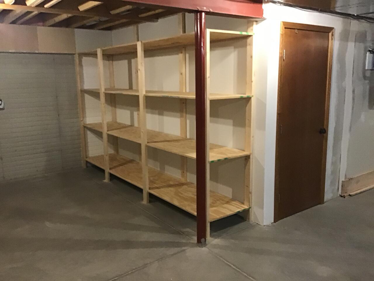

GETTING OLD So I'm building a 12' long basement shelf unit for LOML to store the enormous number of books she's collected and the plastic tubs they're stored in. It will be 3/4" plywood with 2x4 uprights. 10 prime 2x4s was no issue getting from HD to home with the Sport Rack roof bars. 3 sheets of 23/32" BC plywood required a couple of Homer Helpers to place the 3 67 pound sheets up on the racks because I wasn't up to the task. Getting them down by myself at home was still a challenge, gravity being in my favor. I'm going to need help getting them down the stairs to the basement. Getting old is a booger.

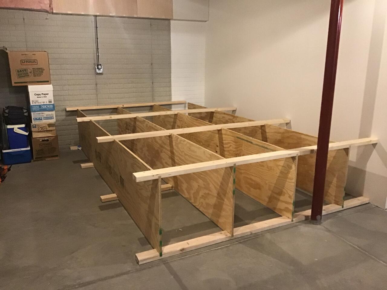

I may have built myself into a corner, so to speak. I have the shelf unit built. I built it on its back on the basement floor in front of where it's going to be placed. Now I have to raise the top up and shove it back some to finish the back side. The completed unit weighs about 250 pounds, so I will need help. I'm thinking of using some pulleys to get mechanical advantage, but may have to wait until I can get a couple of offspring over to supply the muscle.

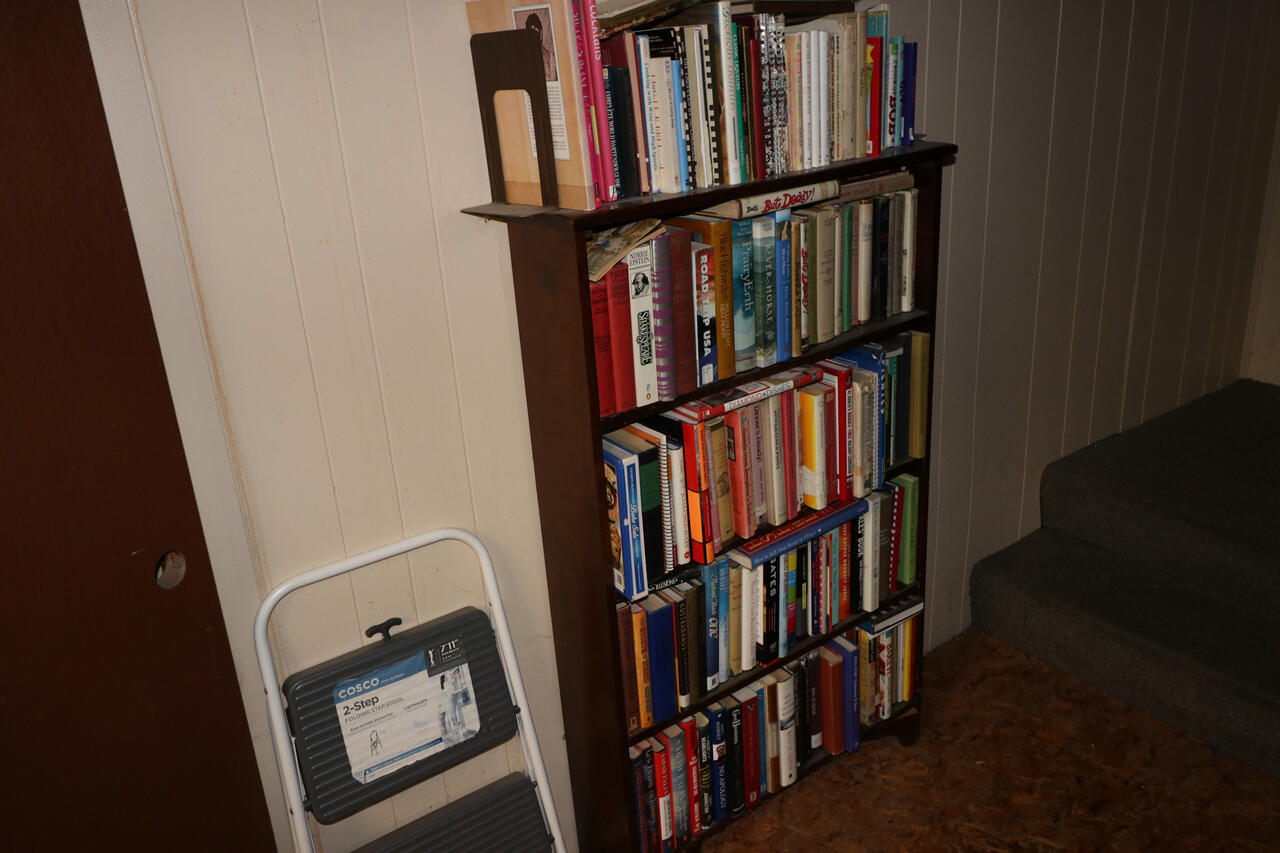

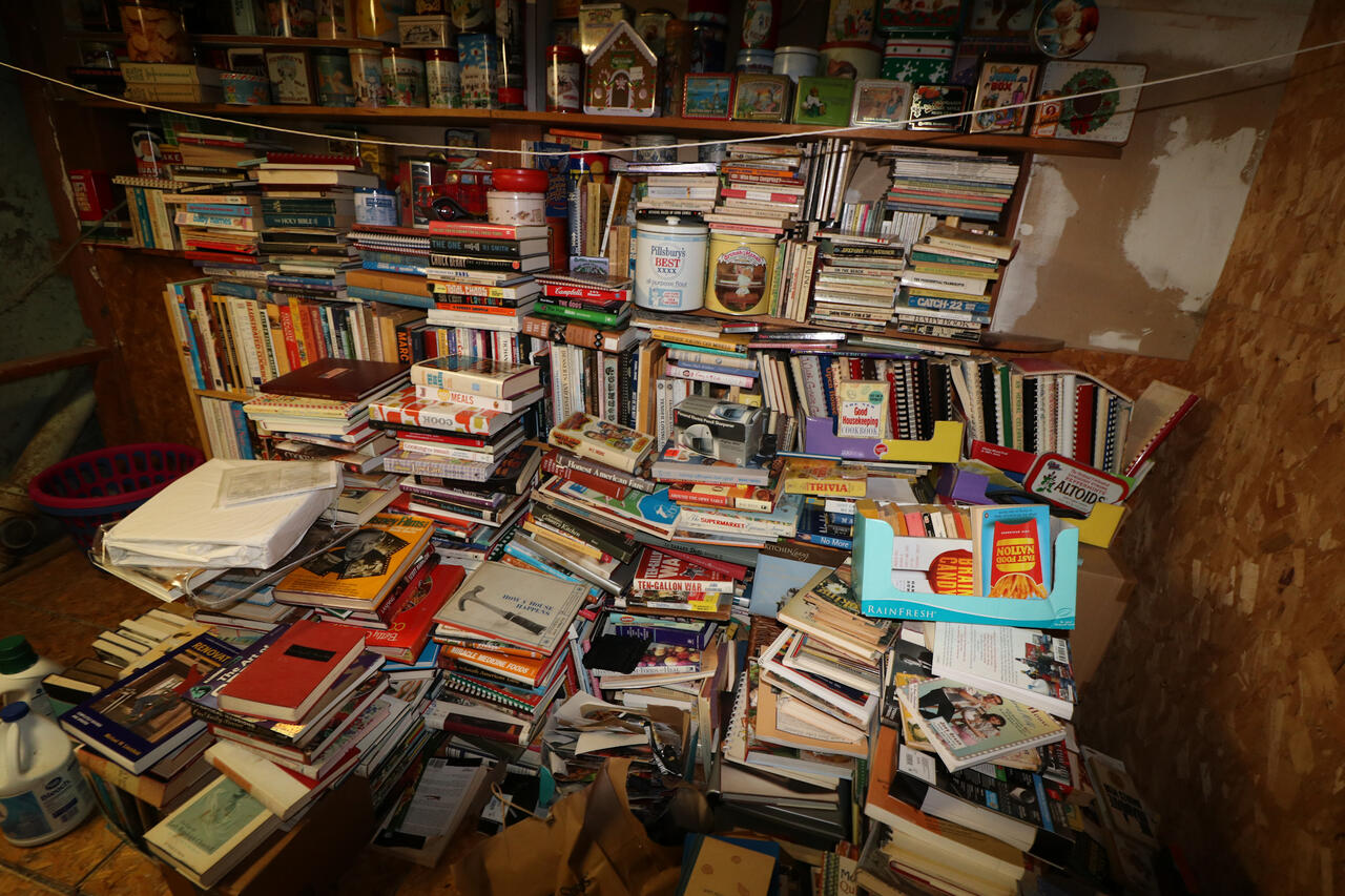

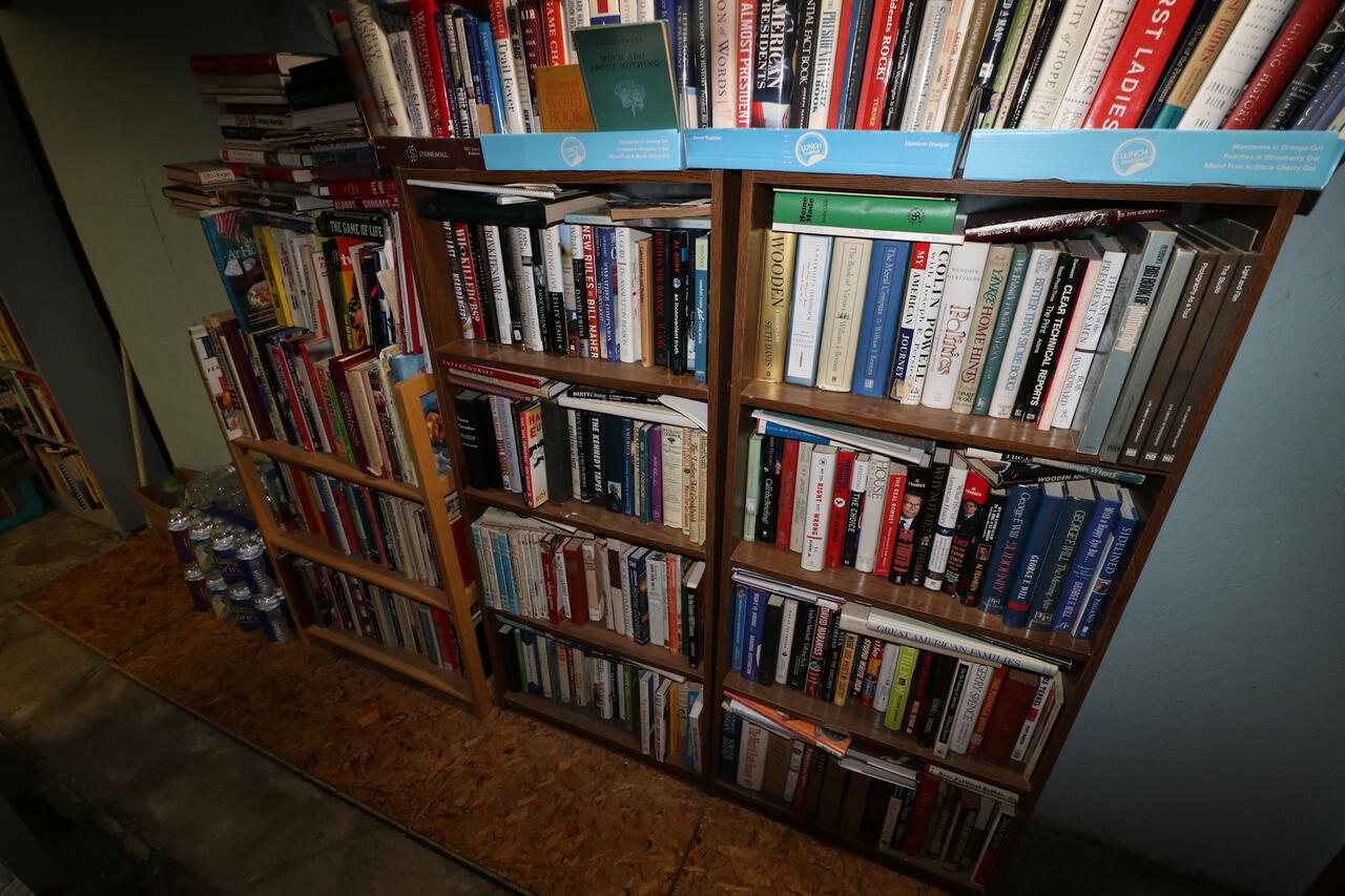

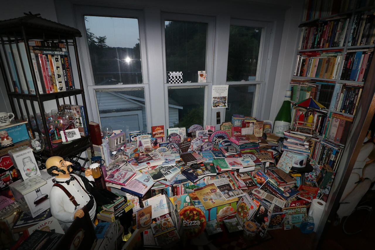

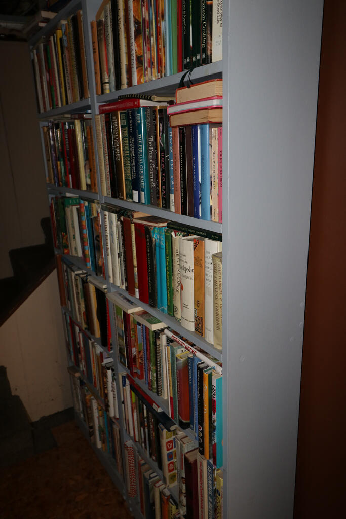

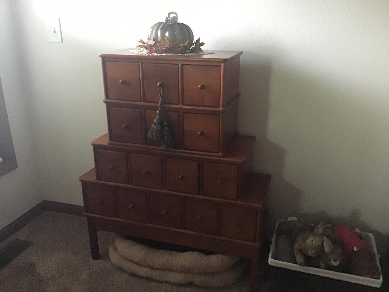

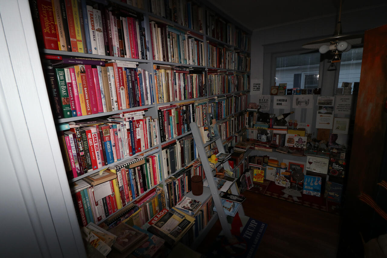

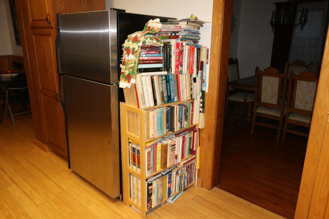

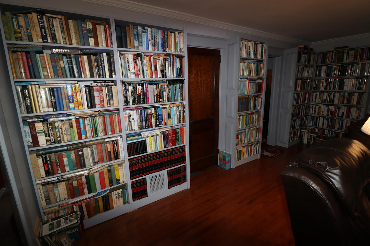

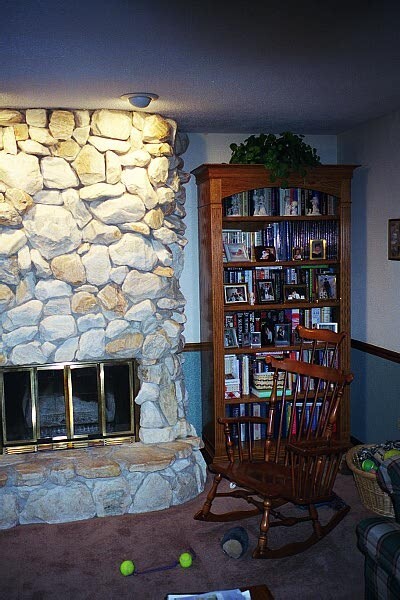

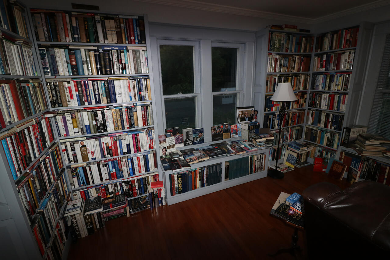

The last eight pictures are in the basement, the main library and the cookbook room are on the second floor (first six pictures), the eighth is in the kitchen, and the last two pictures, marked "Attached Files" are duplicates, as I didn't know how to get those back off the posting.
Oh, and I forgot to post the wife's Sports books or her DVD collection!
Before I built the main library and cookbook room I did some reading. With the exceptiong of picture #4, all the bookcases are built along load bearing walls. Picture $4 crosses the kitchen below it, and that has a major beam across the ceiling. But, I built a truss behind the 12-ft length of the bookcase to be sure.
Every horizontal area is level, and the bookcases are anchored to the walls, not just standing on the floor. I inspect the structure a couple of times a year to ensure that nothing has shifted or gone out of level. I completed this about 16 jyears ago, nothings moved.

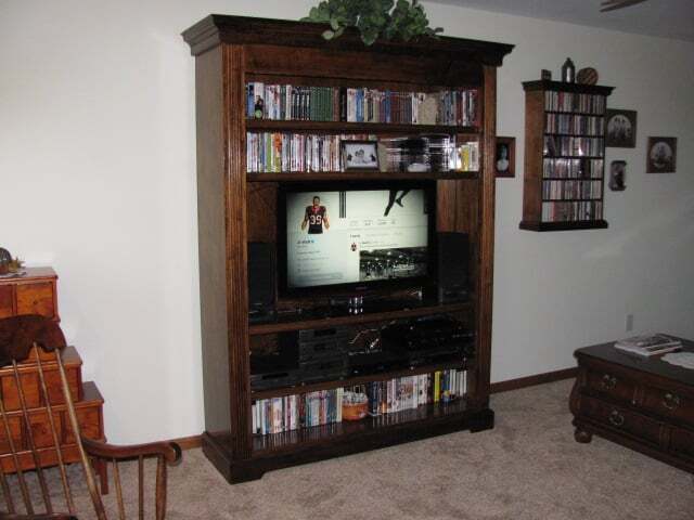

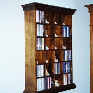

Well foolish me. A long time ago, I made a wall hung CD cabinet designed to hold 288 jewel boxes, thinking we'd never accumulate THAT many CDs. That cabinet filled and the CD collection also now fills the 15 drawer apothecary cabinet next to the 60" wide entertainment center which has three shelves stacked two deep with DVDs and VCR tapes.

Well, I got the shelving unit upright today, by myself. I have always done stuff by myself and so many projects require some thought on how to accomplish a task singlehanded. I adopted a housemoving technique. Jack it up, block it, raise the jack, and repeat. Once I had the piece at more than 45 degrees, I was able to finish tipping it up vertically. Now I can finish the backside that was on the floor. Not bad for a 76 year old feeb!Jim Frye

Finally finished the shelves. All that's left is to sweep the shelves and the build area. Then there's that just awful mess in the shop behind the white wall. Was really disappointed as the unit ended up an 1/8" too long. I had planned to leave space between the I-beam and the shelf upright for drywall at some future date. Not gonna worry about it till I need to.

Spent time yesterday loading the shelves with all of the stuff that used to sit on the floor and still have about 25% of the shelf space left over. Love it when a plan comes together. Unfortunately, I over torqued my knee (that's due for replacement) and have spent the time since hobbling around with arthritis rub and a heating pad. Guess that's another sign for me.Jim Frye
