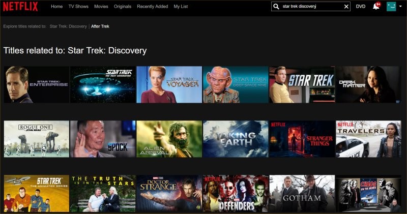

            I setup Netflix on our loaner TV last night. I'm using my US credentials through the local ISP (no VPN yet) but I'm wondering if I'm seeing a region difference or not. It's hard to tell because I don't think the remote control works well for this Netflix app (the TV runs Android).
            Can someone check for me? Is the new Star Trek Discovery series available on US Netflix? I don't remember seeing it a week ago back home. When I watched it, it says it's a Netflix original series which I know isn't right because it started on CBS. I'm kind of excited because I've been really wanting to see it but didn't want to pay CBS. The first few episodes have been really good. On the flip side, I don't see Altered Carbon on here.

              I searched for "star trek discovery and came up with this: Click image for larger version

                I signed up for NordVPN last night. Easy enough to use. I haven't taken the plunge in getting a hardware VPN but Nord allows it. It also allows you to run 5 simultaneous connections using their app. Some other VPN services only allow one connection at a time.
                Anyway, I definitely get different Netflix programming here which is kind of nice because I am really liking the new Star Trek Discovery series. If I want to watch US Netflix, I just jump on the VPN back to the US. You do take a hit to your internet speed, though. On Speedtest.Net, I'm getting roughly 2/3 the speed of what I get without the VPN for both download and upload--still fast enough for streaming, though.
