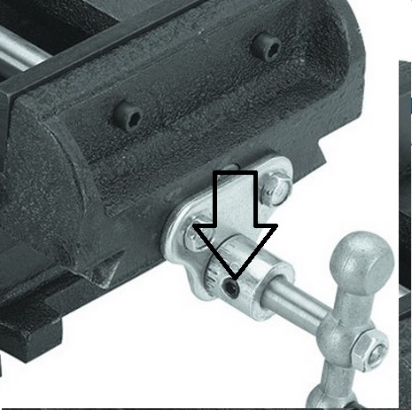

        you might also check the set screw that holds the end of the threaded rod where it pushes and pulls the moving jaw. It that is loose there can be considerable slop. You would normally tighten it just to the point where it keeps the threaded rod from turning then loosen it a hair.

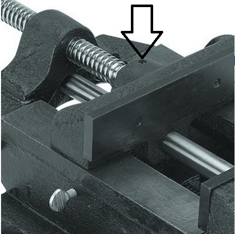

                • 21974
                adjust where indicated?
