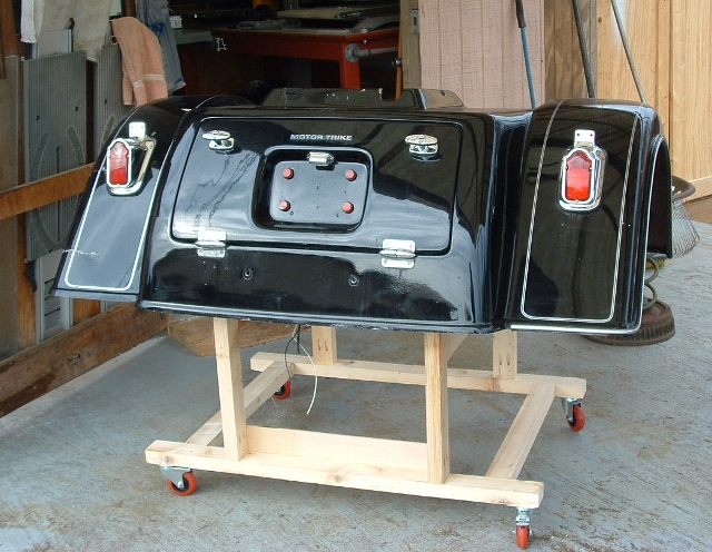

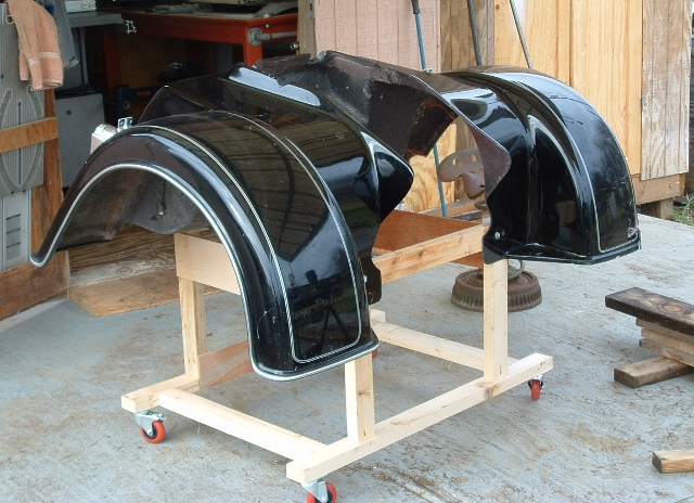

                The framework and rear axle are still in the truck but I got the stand for the body mostly done yesterday. I added some braces and the casters today, then mounted the body. After I got it positioned where I wanted it i used a centering bit to mark the positions of 2 of the front body bolt holes. Then I moved the body out of the way and drilled through the frame and inserted T nuts from the back side. After the front was bolted in place I repeated the process for the mount holes in the trunk floor, then bolted it to the frame at all 4 points.
                The frame is all from scrap wood and assembled with glue and pocket screws. The braces are ply and glued in place. The rear mount is angled so the trunk floor sits flat on the surface.

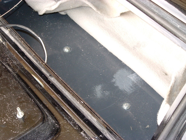

                2 bolts hold the front of the body tight against the frame and 2 more secure the trunk floor to the rear mount surface. When it is ready to paint I will remove the washers and leave the front bolts backed out so the shoulders suppport the body.

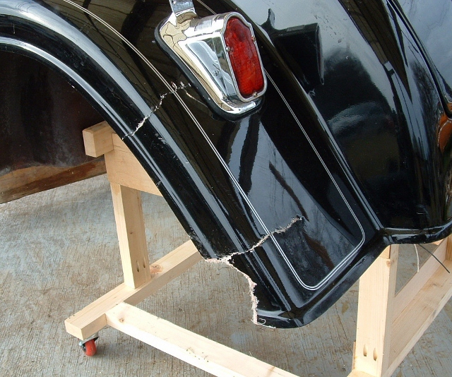

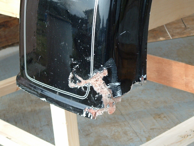

                Overall shot of the damage where it brushed a guard rail on the left side. Three cracks and both corners of the wheel well are broken off.

                After fixing the 3 cracks I will build a mold from 'Kitty Hair' to to clamp to the outside of the rear corner and build it up from the inside.

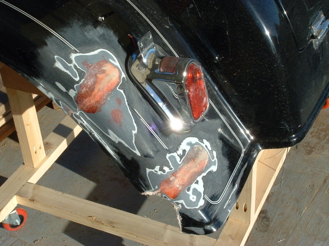

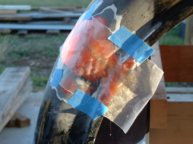

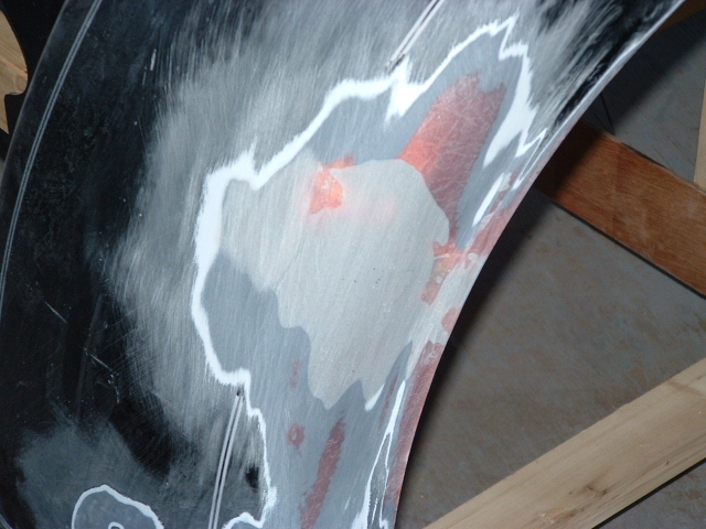

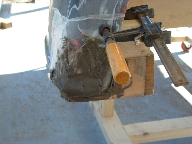

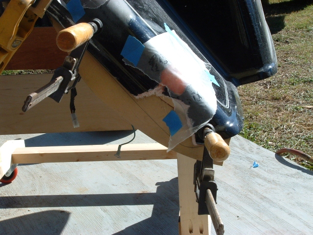

                  Went to HD today, picked up some fiberglass supplies, and got a good start on the body repairs. Worked over the outside of the 3 cracks and started on the damage to the front of the fender well.
                  After grinding/sanding through the gel coat and into the fiberglass around the cracks, I clamped some MDF blocks is place to hold the cracked areas in the proper position. I glassed in 2 layers of mat and, after it cured, remover the clamps and repeated the process on the lip for 2 of the cracks.

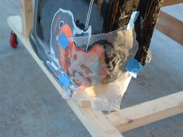

                  On the front of the fender I cut away the edges of the broken areas so it would lay flat, taped the lip in place and repeated the steps to the front and side.
