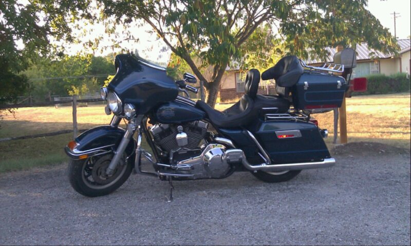

    As too many years add up, handling a 900 pound motorcycle is getting to be more of a challenge. Problems with my left knee make it hard at stop lights sometimes.

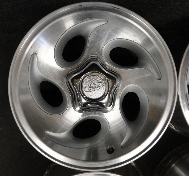

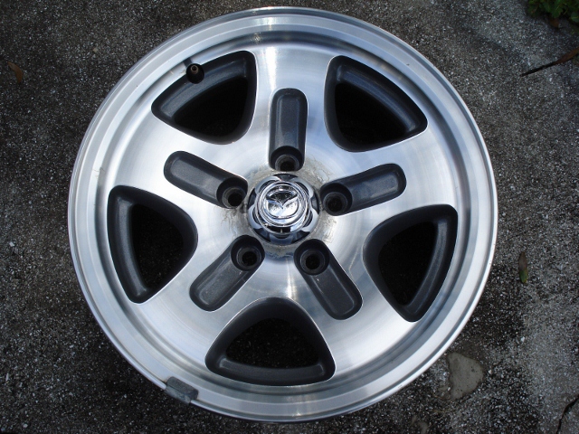

    I called Motor Trike in Troup, Texas and found the difference in the kits between this one and one for my '02 is the rear pulley that I can buy from them for $150. Richard also told me the wheels are a 15" x 7" with a 5 on 4 1/2" (5 on 4.114.3mm) lug pattern. This is about the most common lug pattern used and includes the Ford Ranger/Explorer and Mazda B series trucks. I found 2 wheels I liked that should be easy to find in a junk yard for ~$50 each.
Name:	Ranger Wheel (640x596).jpg
Name:	Mazda wheel (640x480).jpg
    In either case, I will modify the center cap to display either the Harley logo or maybe a Marine Corps seal. Une of my neighbors makes custom knives and has a metal lathe if I need to fabricate a new center cap. This will probably be needed if I go with the Mazda rim.

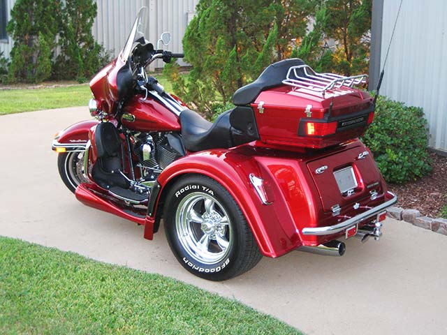

          I like the color of that trike.
            C-Man, I have the stock floorboards, both rider and passenger. What is in the picture that I won't have is the fiberglass piece that runs under them. It is an expensive option that I'm not sure I even like the looks of. The only real advantage to them is they can be set up with an extra set of driving/fog lights.
            I have done some, but not a lot of 'glass work. Enough to feel confident in making the body repairs myself. Plan is to grind some from the inside and reinforce the cracks with 2-3 layers of cloth. Once that sets hard I will sand down the outside and add one layer of cloth to smooth and bind the damaged areas them top it with gel coat. There is a wax additive that goes in the gel coat that rises to the top when it is applied to seal it from the air so it will cure. The body is made with polyester resin which is a little easier to work with than the epoxy resins.
            Chiz, I am going to stay with the original color of my bike, Luxury Blue.

            I'm with you on the wheel choice, but most everyone seems to like the symmetric look of the Mazda wheel. Like the wife said, it's my bike and my decision. I could be happy with either one and the final choice will probably come down to the one that has the center cap that is easiest to modify. Either way, the background will stay grey to match the upholstery.
              What are the two diameters of the caps?
                The center (logo) section of the Mazda is 1 5/8". Haven't measured the Ranger cap yet. May do some junk yard digging on Monday to get some more measurements.
