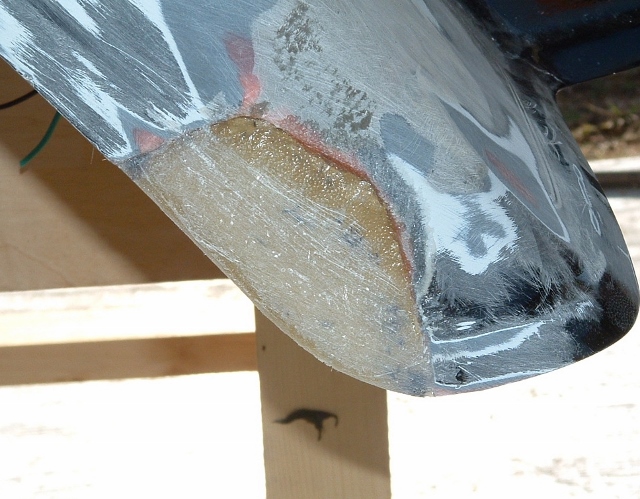

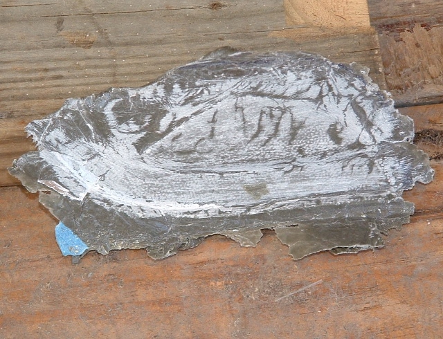

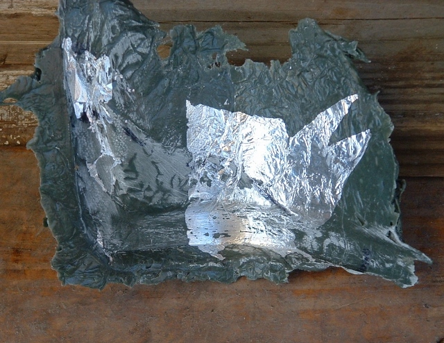

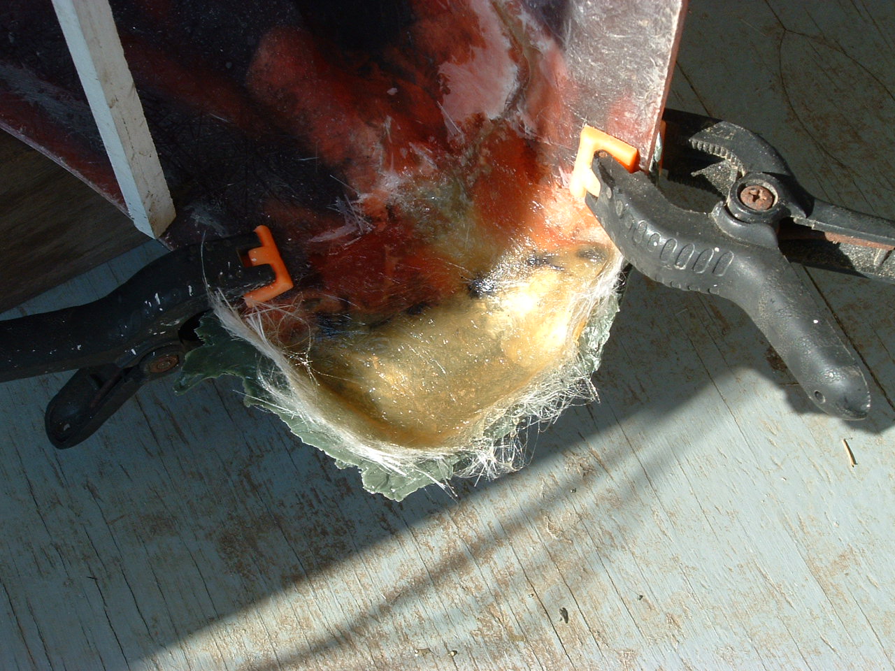

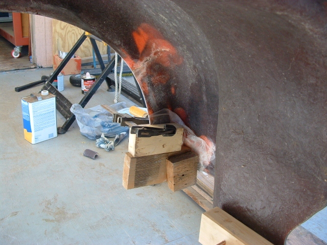

    Another update.
    I got more work on the body yesterday. finshed the molds for the broken areas and got the first of the 'glass laid in. The edges didn't come out as sharp as I had hoped so I will have to use some reinforced bondo to build them up. The joint is overlapped on the inside about 1/4" and will be overlapped more with a couple of more layers to build thickness and strength. The oustide was ground out along the joint and filled with mat to fill minor gaps and add some strength before I closed up for the night.
Name:	Front Mold .jpg
Name:	Front Patch.JPG
Name:	Front Patch 2.jpg
Name:	Rear Patch 2.jpg

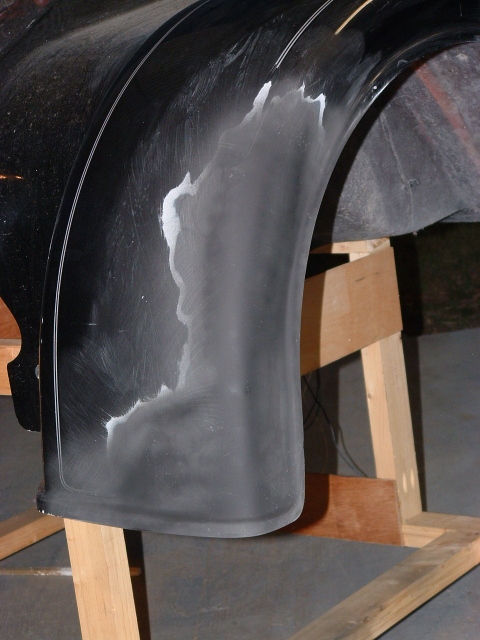

        Finished the fill work on the 2 cracks and got most of the fill worjk done on the patched areas. Still a lot of shaping to be done on the corners. This is tedious work because it all has to be done by hand trying to match the good areas on the right fender well. If you look close you can see the pencil line scribed on the front to mark the inside of the flat area.

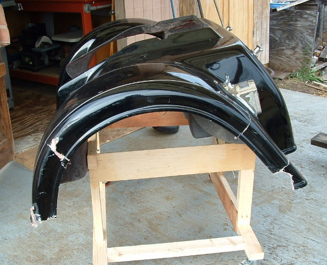

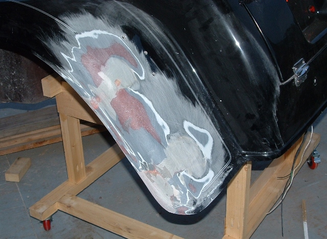

              There is still a little bit to do, but it is close enough to show off! On the outside the only thing left it to do is block sand the repairs with 220 grit, use a gel finish coat to fill the pinholes and deep scratch marks, then sand the rest of the body down for painting. On the underside I still have to clean up some rough areas where it was cracked and build the thickness up on the fiberglass. That work doesn’t have to be pretty.
              It’s not perfect, but I am happy with it.
              Repaired front corner and front crack.
Name:	Front Repair Outside 2.jpg
              Repaired rear corner and rear crack.
Name:	Rear Repair Outside 2.jpg

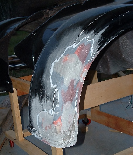

              The damage when I started.
Name:	Trike body 3.jpg
              And the results.

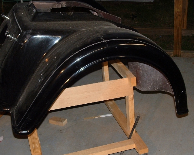

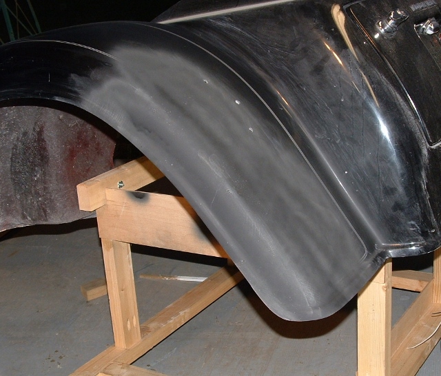

              For comparison, this is the right (undamaged) side.

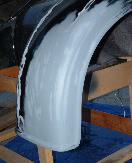

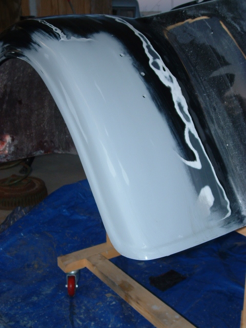

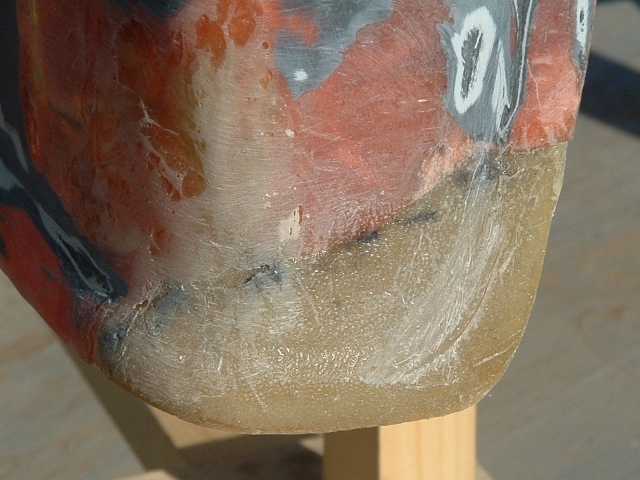

                            Another step forward.

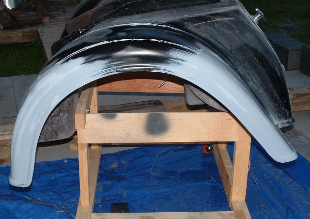

                            Haven't been able to get a lot more done between work and some bad weather. Did coat the repairs with the gel coat to fill the pin holes is the glass and today I bought the primer filler that will be used in the final paint job. Anything used from a rattle can has to be washed off with acetone since the solvents in the urethane paints will eat them.
                            I laid 3 coats of primer over the repairs and wet sanded it with 500 grit. A couple of pin holes showed after sanding that will be taken care of along with a pin hole I found in the original body work. The prime did its job and filled all the sanding scratches.
Name:	Front Repair Outside 3.jpg
Name:	Rear Repair Outside 3.jpg
Name:	Left Side 3.jpg
                            After taking care of the pin holes, I am ready to remove the pinstripes from the right fender, wash it down with acetone to remove all the wax, strip the hardware off the trunk door, and wet the rest of the body. if I can get the pinstripe tape here in time, I hope to lay the paint next weekend.

                              For a cleaning, have you considered that acetone may remove primer and putty?
                                #45
                                I used rattle can gloss black enamel to check for pin holes and sanding scratches. The acetone will wash off that and rattle can primer that I used earlier, but doesn't affect the Bondo or fiberfglass. Not sure how it would affest this primer. The entire left fender was cleaned/dewaxed with it before I started the reapirs so it won't need washing with it again, just a final sanding with 500g before the final paint job. The rest of the body will get wiped down before I start to sand it.
