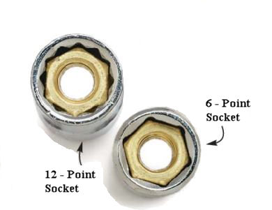

                Here is a pic showing contact areas of 6 and 12-point.
                      That picture does not show the contact area.
                      Edit: if you look closely, it does show the contact area. The only part of the nut in contact with the socket is the corners.
                      To fit over the bolt head, a socket must have some clearance. As a result, when torque is applied to the socket, the socke turns or "cams" slightly. The only place a socket under load contacts the bolt head is at the corners or points - which is why a 6 pt socket cannot apply more torque than a 12 pt socket.
