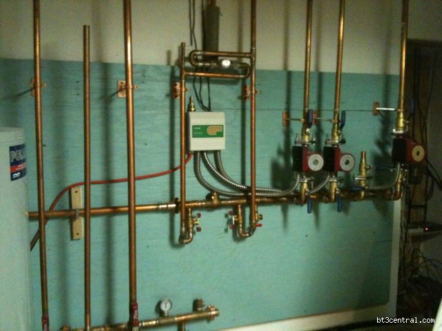

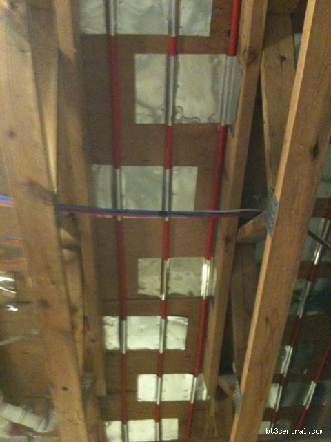

                          We installed a radiant floor retrofit in November / December of this year. So far we love it. I’ve attached a photo f the ceiling in my office where you can see it. I still haven’t gotten around to sheet rocking the ceiling in my office or the laundry room, the rest of the basement and garage are done.
                          1. So far we love it.
                          2. I’m glad it is done. We did it ourselves and it was more work than I ever anticipated. We installed 4200 feet of PEX with only two kinks. This was done by my wife and me, our three teenage daughters, and some help from friends and neighbors.
                          3. I think it is too early to tell if we’d get it again. The reason we did it is the south side of the house is about 60% glass. On sunny winter days, that side of the house is really warm, and consequently the heat never ran for the rest of the house. We would end up with 10-15 degree differences between the sunny rooms and the NW corner of the house. On cloudy days, the North wing was warmer since we’d tried to balance forced air heat. The radiant system has four zones so we can individually control the heat in the north wing, the master wing, the kitchen dining room area and southern exposure. Since we finished, we had a variance of no more than +- 3 degrees from 70 in any area of the house. I installed 18 min/max/average thermometers.
                          4. Since we’re on propane and we switched from electric water heat to propane water heat at the same time, I can’t really say. My electric bill dropped about $120 a month, 1/3. We did have the coldest winter we’ve had since we moved to this house and we used no more propane than we have in previous 5 years. We are also heating water with propane now.
                          5. Total cost for materials was about $11,000 and another $2000 for plumbing help. The plumbing related to the heating was about half of what they did. The rest was for other remodeling stuff that was going on at the same time and I figure while they’re here ….
                          6. We have a basement and it is 1100ft sq finished. We have everything in place for a fifth zone, but we didn’t put it in there yet. When we do, we’re going to run 1x4 sleepers on the concrete, run the PEX in between, fill the remaining cavity with sand, and then put ½ in sheathing over all of that. I’ll lose a little over an inch of headroom, but since the house was built with trusses and there are not bulkheads in the basement. I’m still contemplating adding a ½ inch rigid foam under the sleepers
                          7. Most of the house has either ceramic tile or hardwood. Eventually it will all be one or the other. We still have 80’s deep pile carpet in the master wing since we haven’t remodeled that area yet. It seems like the temps are more consistent where we don’t have carpeting, but the carpeted areas haven’t been remodeled and subsequently the insulation in that wing is not the same. Also, it’s above the garage which was un-insulated last year because we had to take down the ceiling to install the radiant. The ice storm over Christmas kept the insulation crew from getting up our driveway until late March.
                          The company we went with for the do it yourself installation is www.radiantec.com They were very helpful. I put three years of planning into this and probably spent ten hours or so on the phone and hundreds of emails over that time.
                          The pipe is held up by aluminum plates that help distribute the heat.
                          The manifolds came mostly assembled. I still ended up with nearly 500 joints I had to solder and only two leaks when pressure tested.
