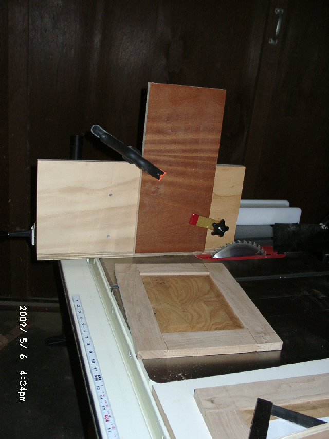

          There's no reason your hands should have to be near the spinning blade in order to raise a panel.
          I made the simple jig in the photo to hold a panel upright. When I made the panel in the photo, I used spring clamps, which held the panel onto the jig but allowed some movement. A holddown works much better because you can make it very tight. My jig rides against the fence rather than in the miter slot, so I had to move the fence to the left of the blade since my blade tilts right.
          This door is for an over-the-sink cabinet in my new shop. Made of elm. Still needs to be finished and attached to the cabinet.

                              Jack Ellis, thanks for the photos. Certainly something to think about if I decide not to buy the bits. Your jig is kinda what I had in mind. Again, thanks.
