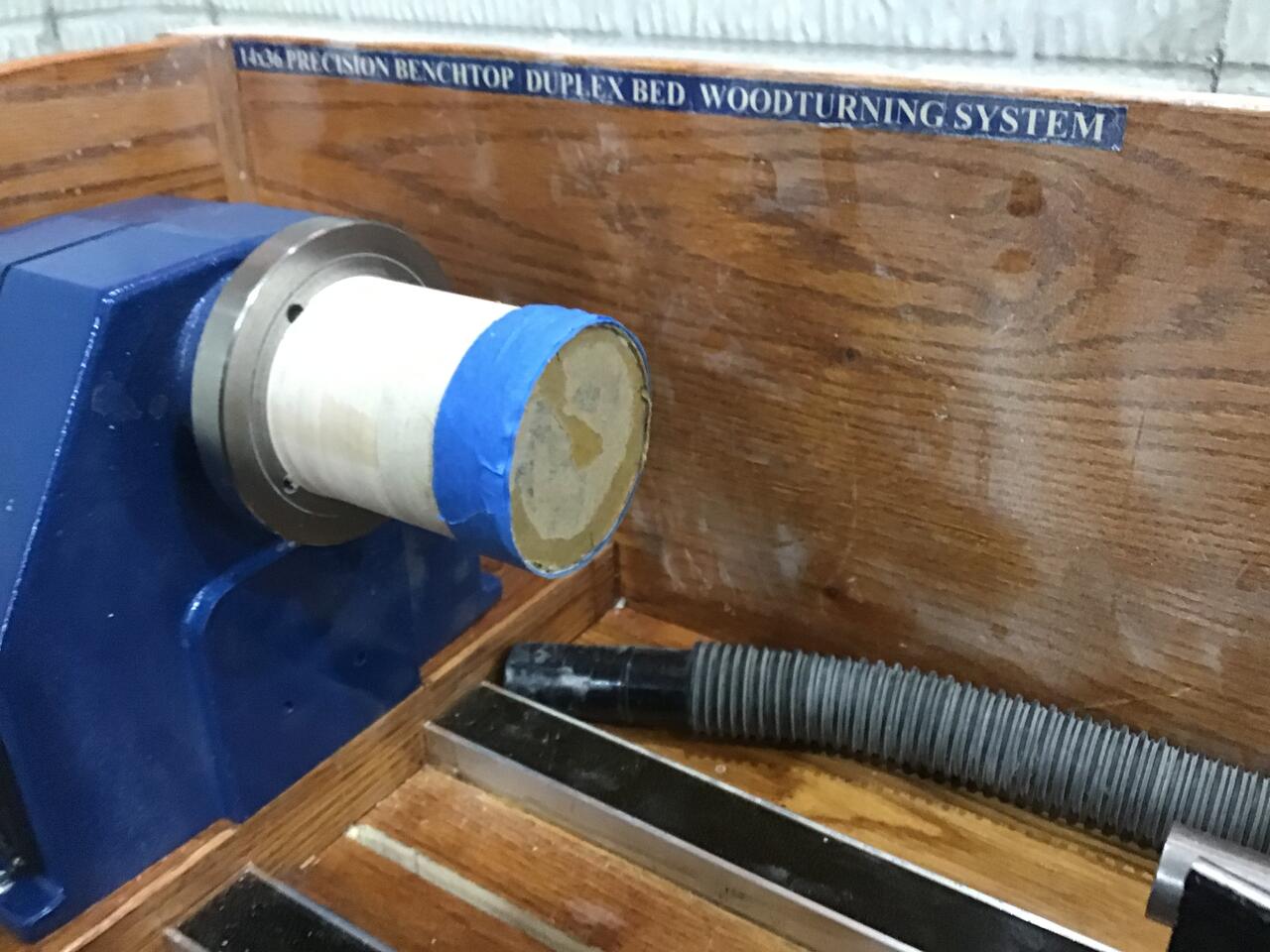

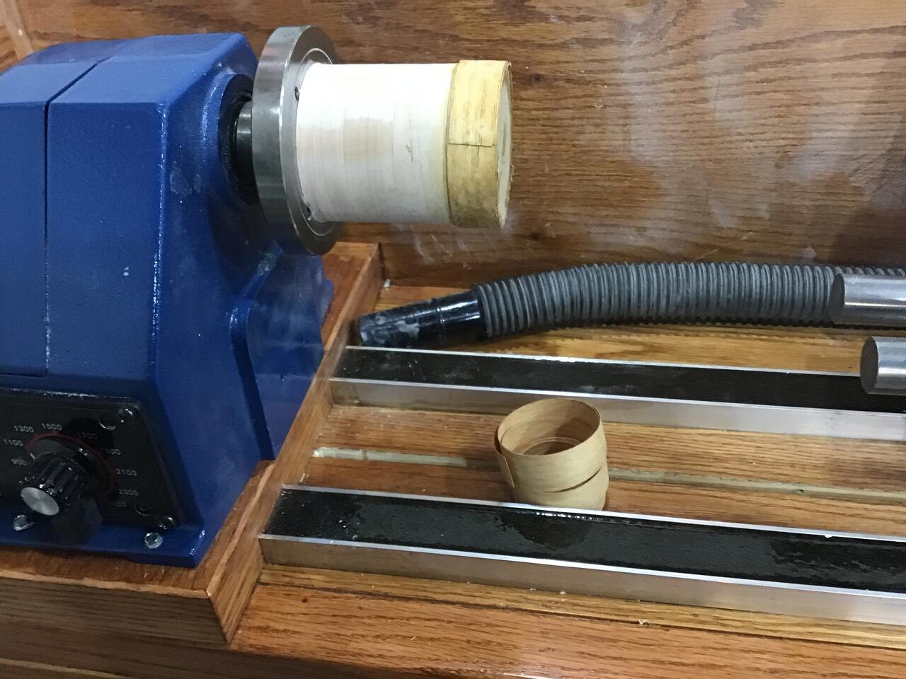

    I have turned the faceplate mounting block down to being concentric with the faceplate and am now building up the bowl end to be a tight fit in the bowl recess. I'm using thin strips of red oak that I ripped on my BT300 many years ago as an experiment. The strips are 1/64" thick and have been hanging on the shop pegboard for thirty years just waiting for a use. I have learned a lot from this error in bowl turning. I turned the faceplate block between centers instead of mounting it on the faceplate and turning it round. Had I done that after I turned the base recess in the bowl blank, I would have saved a bunch of time. As my Grandmother used to say: "The hurrier I go, the behinder I get". Click image for larger version

      I turned the veneer end of the faceplate block down to where it is a snug fit in the bowl base recess and redid the paper glue joint. Hopefully, it will be good to mount back on the lathe so I can start hollowing out the inside of the bowel. At least things look concentric now. Fingers crossed.

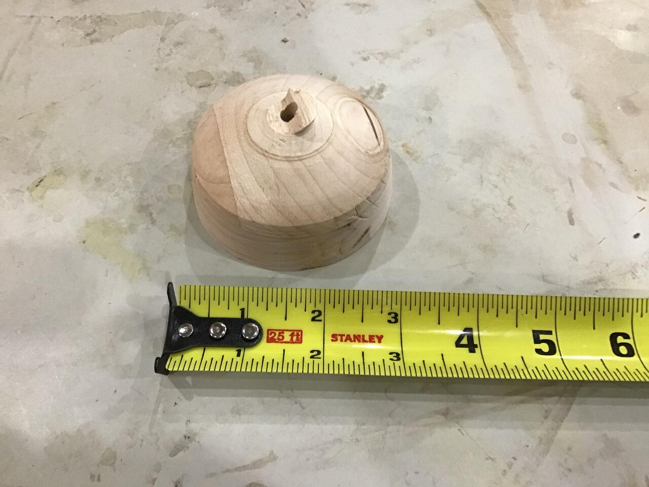

        Had a bit of a breakthrough today. I finally figured out how set up the slow speed grinder and how to properly grind the deep flute bowl gouge. And then actually got to using the tool properly. The badly dried brittle hard maple, combined with the somewhat marginal power of my lathe, makes hogging out waste a, well, a waste, so I'm limited to light cuts. Actually, I have learned how to use the gouge with shearing cuts and repeatedly filled the lathe with long spaghetti shavings that clogged the vac hose! The paper glue joint is holding strong. A 12" dia. workpiece is still a sizable mass, but it's workable. I think I might learn this new skill and ultimately enjoy it. It's pretty quiet and time flies making shavings.

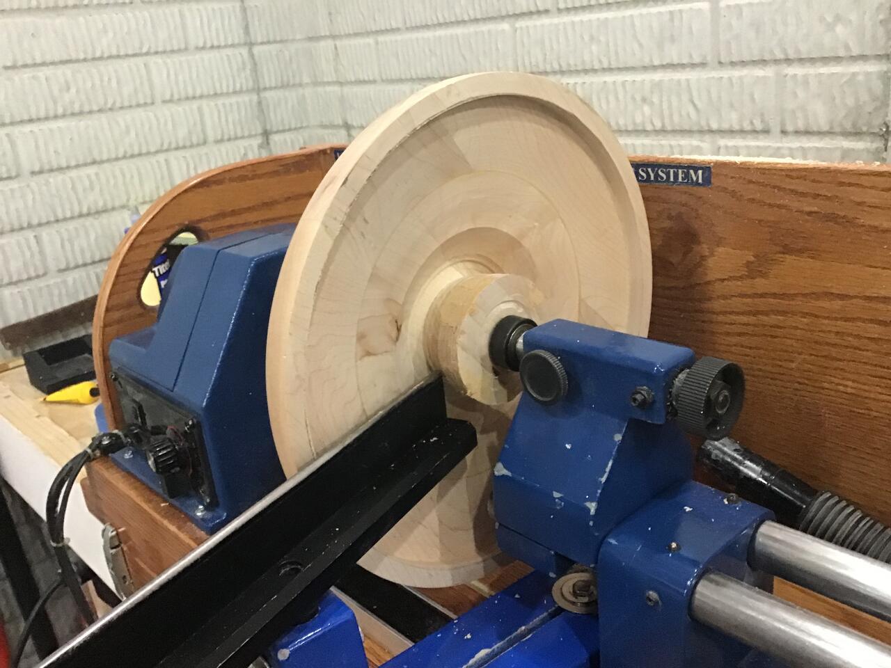

            Work continues on hollowing out the interior of the bowl. So much material to remove. I've got the rim down to where it turns to follow the exterior shape and am working the center down to the bottom around the center support for the tailstock. While the shop assembled lathe is working well, this piece is clearly approaching the upper limit of the design's capability. Still working in half hour sessions due to the thumb arthritis.

                I'm "working" in two half hour "shifts" now. It takes that much time for my thumb to start complaining and for the shavings to build up around the work area now, so it seems like a good time to take a break. Just finished a turn and can't believe how much material I removed this time. Couple of more days and I'll have to start worrying about wall thickness.

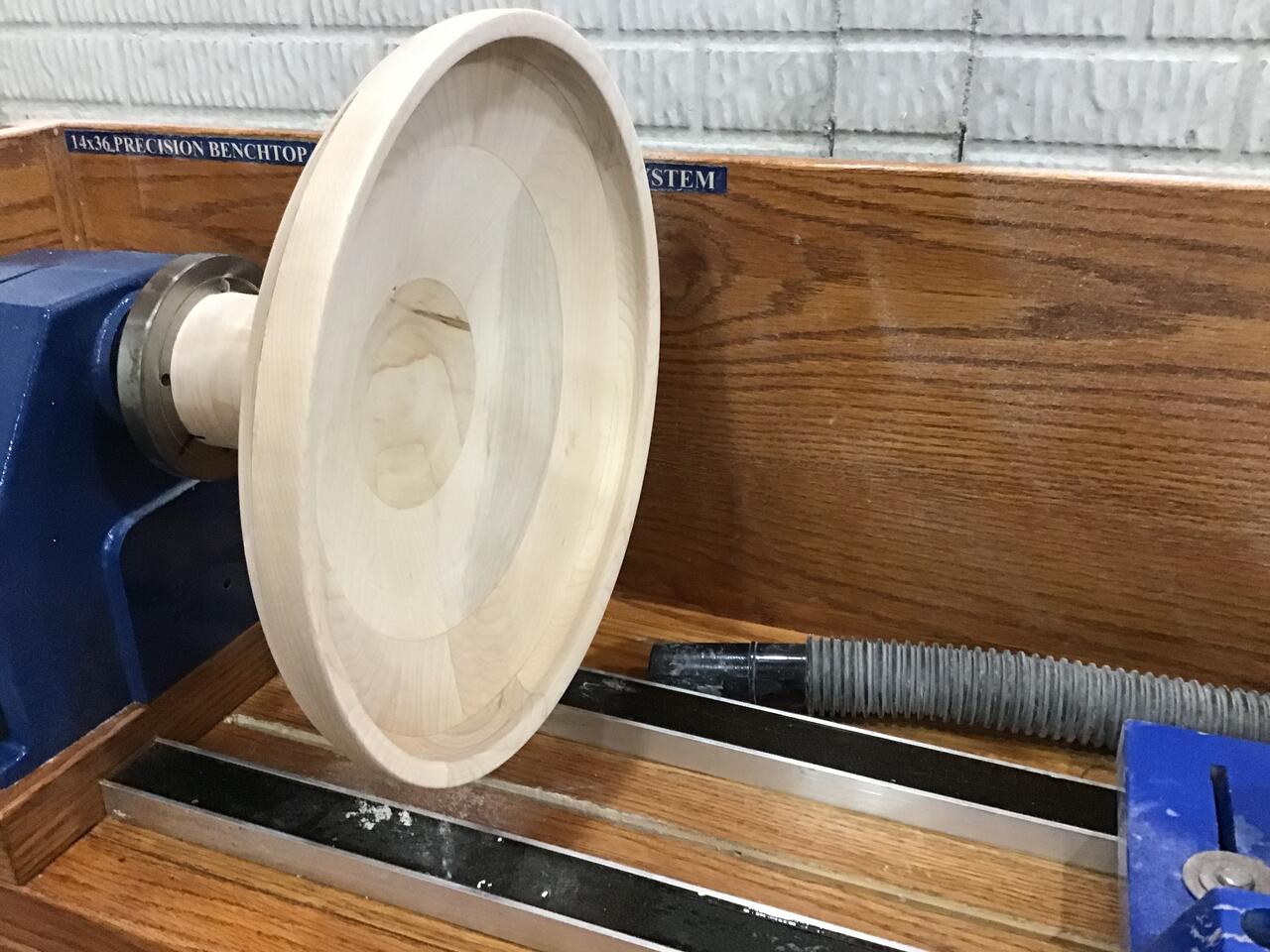

                    Well, I got the interior hollowed out to the designed profile and will start smoothing it out with scrapers. Almost down to my desired 3/8" wall thickness. Will sand the interior to finish grits and then part off the center support pillar and finsh the bottom. Never done that before and feeling a bit of trepidation. Hopefully, I can pare it down enough to just snap it off.

                    Finished sanding the bowl to 220 grit and have started to remove the center support and this will be a real challenge. I made a huge mistake when I reversed the blank to hollow out the inside. Since my only mount is a faceplate with screws, it left four holes on the inside face of the blank and in my lack of experience, I copped out of turning the center support as small a diameter as possible and turned it outside of the screw holes until I got beyond them. Now I have to part off a 2"+ diameter center support down inside the bowl instead of a 1" diameter one. Another lesson learned.

                      Parting off the center support has been challenging (as expected) and I have been creating mistakes by trying to do too much at one time, and have dinged the interior of the bowl with my haste. Fortunately, I left the wall thickness of the bowl a bit thicker than the planned 3/8", so I have some wiggle room once I get the center post removed and the bottom flattened. I should be able to sand the mistakes out and still keep the designed shape.

                        Got the support column parted off and the residual remains on the bottom turned down to a flat area. I had a catch when the center support let go and have it mostly sanded out. Next up is final sanding, applying the Danish oil finish to the bowl, and removing the paper glued faceplate mount on the bowl base exterior (my next area of trepidation).
