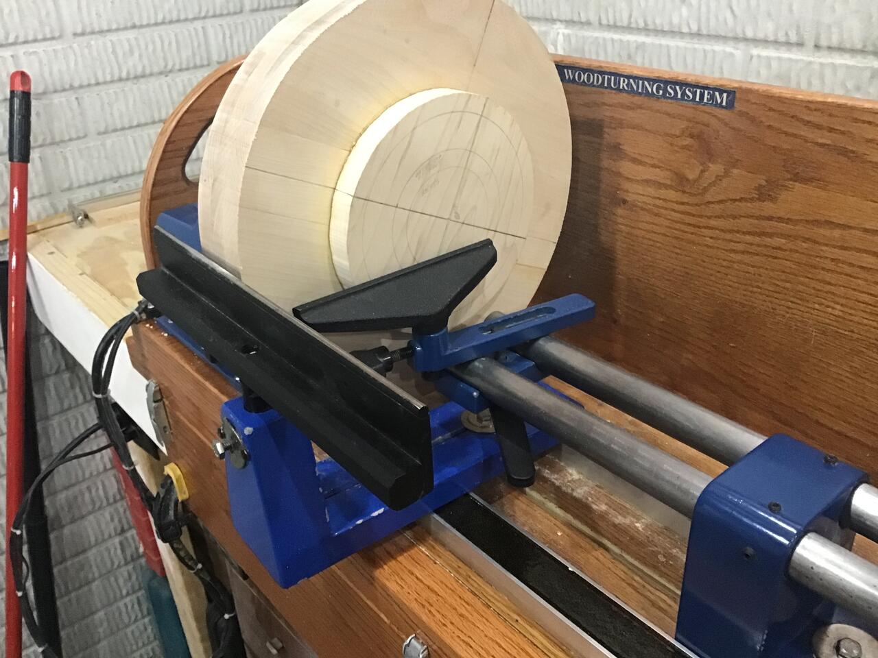

    I've been spending time learning to turn a bowl. I started assembling the bowl blank on February first. The arthritis in my thumb limits my time at the lathe to about 20-30 minutes at a session, but I'm getting better at it. I have learned to handle and sharpen the bowl gouge so I'm not tearing things up every time I touch it to the work piece. Another thing I've learned is that I probably shouldn't have used hard maple as my first try, but I will press on. Patience is a virtue here. More as I progress with learning this new woodworking skill.

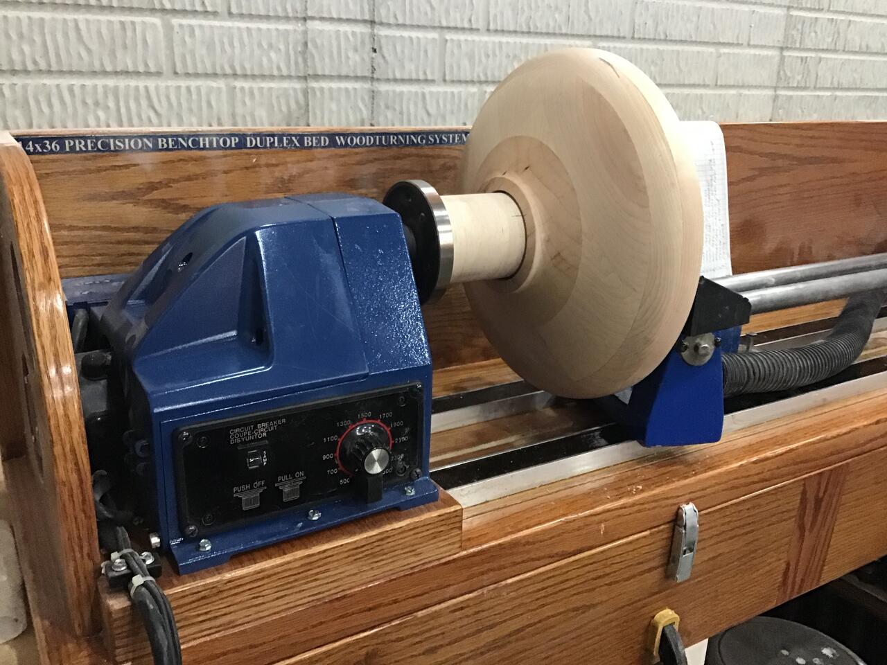

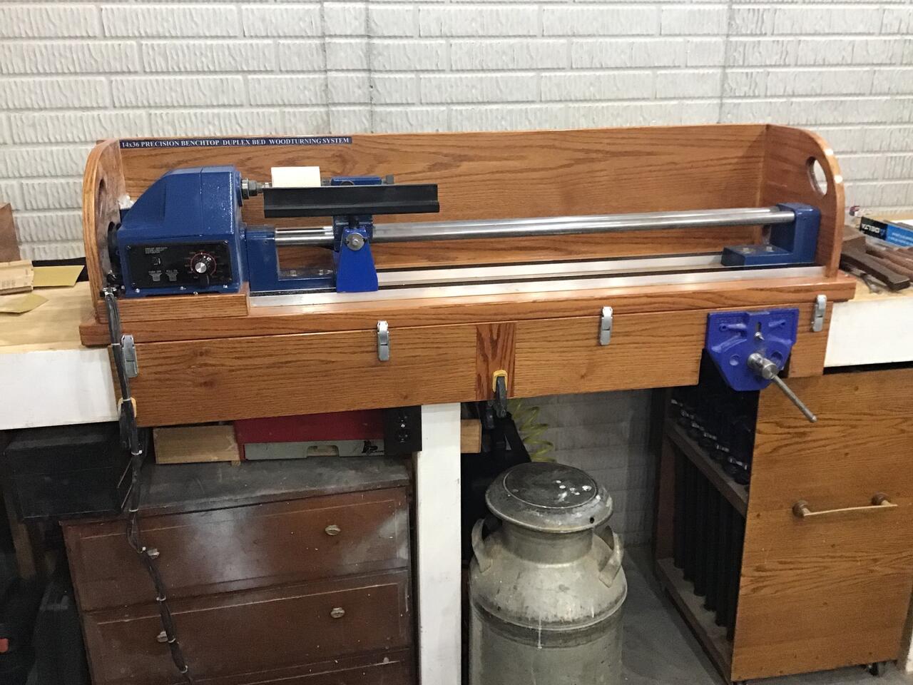

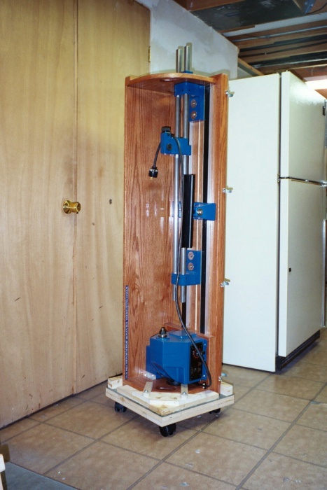

    Well, I almost have the outside of the bowl roughly shaped. I made inner and outer templates to guide the shaping. A little more gouge work and then I can sand it before reversing to do the interior, which has me a bit concerned. I don't have anything like a Nova chuck and am using a face plate to mount the workpiece on the lathe. Oh, and here's a picture of my shop built lathe that I'm using.

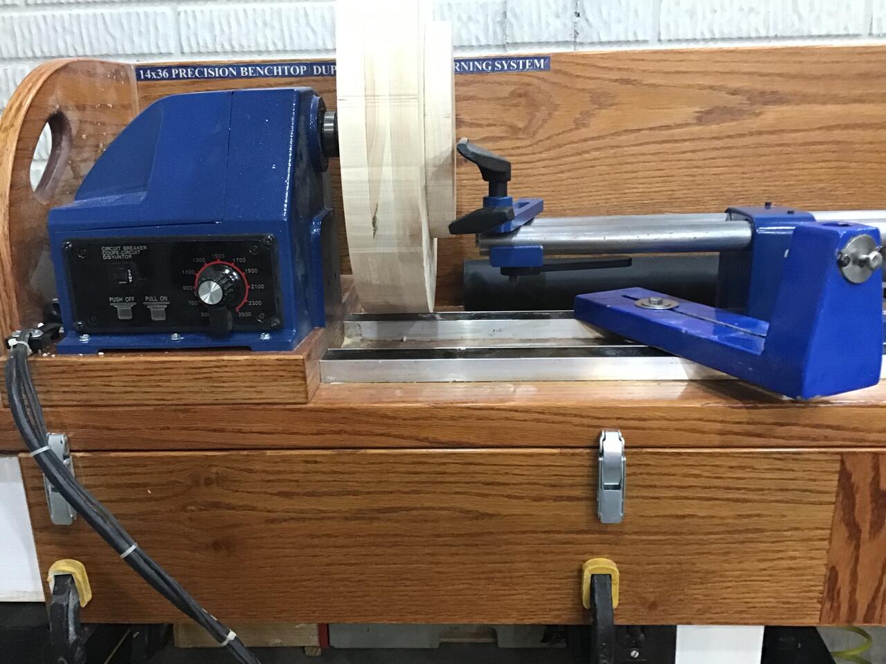

            I have my variable speed 6" grinder/hone set up just to the right of the lathe. It has an 80 grit aluminum oxide wheel on one side and an 1 1/2" wide charged cotton wheel on the other side. Makes it easy to step aside and get a new edge quickly. If this exercise goes well, I may invest in some new tools. I currently have a Craftsman carbon steel set and a Delta HSS set. This is all sort of a shoestring setup to see if wood turning was something I would like to do other than a necessity. When I put this lathe together in 2001, I had neither the budget, nor the space, for a dedicated lathe setup. The design I came up with is somewhat of a benchtop unit even though it weighs 120 pounds, but I ended up spending less than $300 building it. It stores on a rolling dolly made from a laminate countertop scrap and clamps to the fixed work bench that is bonded to the basement walls and floor for vibration absorption.

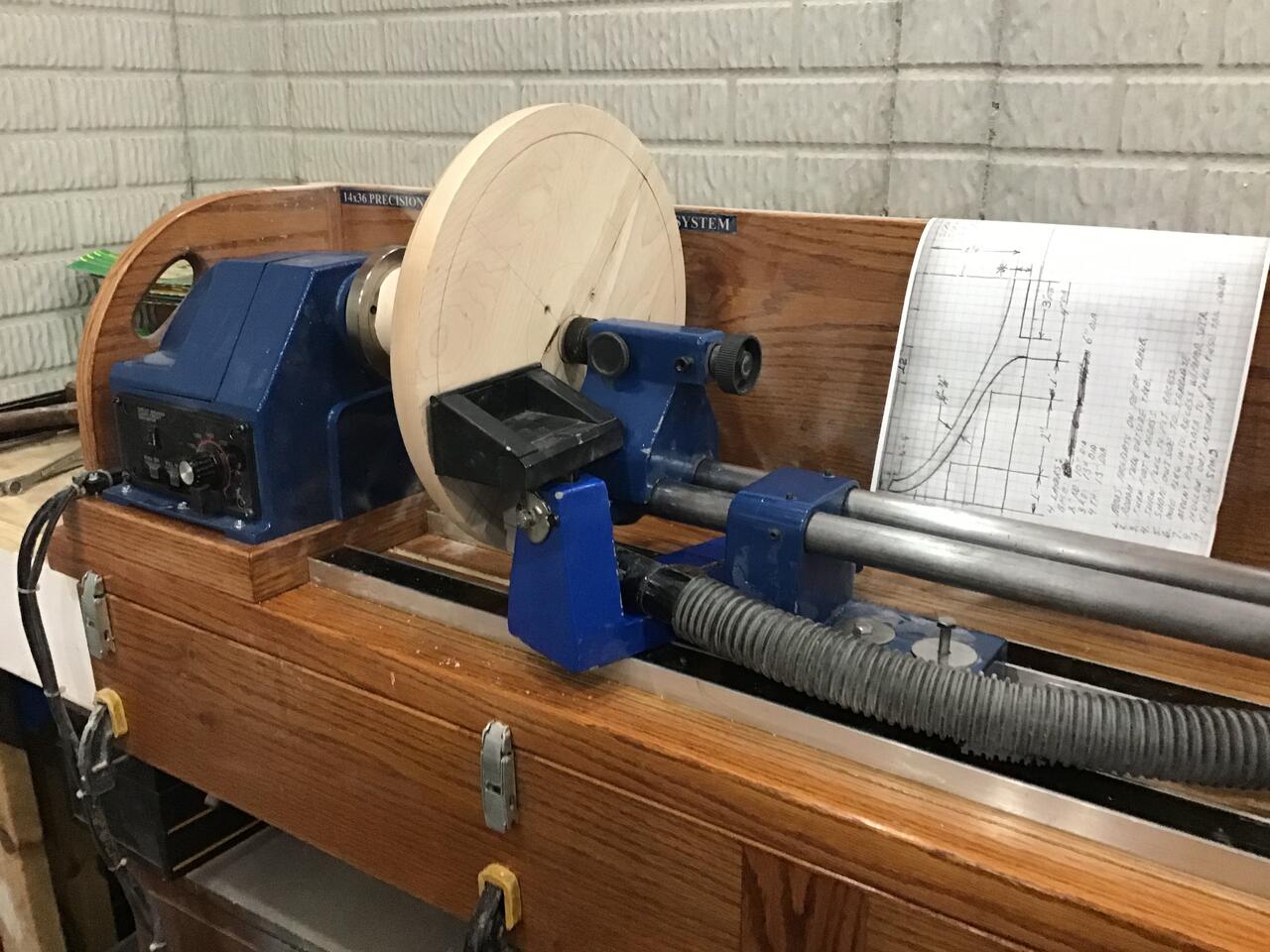

                        Well, it took a few hours, but I was able to get all of the catches eliminated and the outside of the bowl is ready for finish sanding. I was able to save the shape, but lost about a 1/8" on the overall diameter to accomplish that.

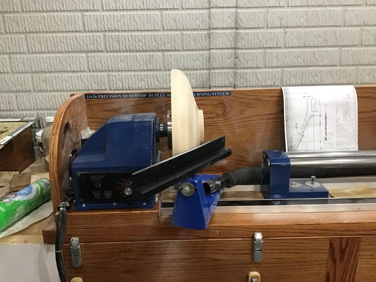

                          Finished sanding the outside of the bowl to 220 grit and have started the process to mount the faceplate on the bottom recess so I can start to turn the inside of the bowl. Since I don't have a bowl chuck like a Nova chuck, I will use the faceplate mounted on a glue block that is glued to the bowl base recess with a brown paper bag separator. Big challenge is to get things centered so runout is minimal. So much new stuff to learn.

                            I have finished reversing the bowl to hollow the inside. Even though I measured multiple times, I ended up with a wee bit of runout (3/32") at the rim that will be sanded out before unmounting the bowl from the faceplate.

                              Well, that was a disaster. The off center mount caused enough vibration to break the paper bond between the bowl base and the faceplate block. I had the block centered in the bowl base, but had the faceplate a tad off center. It's too difficult to remount the faceplate, so I will turn the block true with the faceplate and then build up the end that fits into the bowl base recess with some veneer strips so it fits snugly in the bowl base recess.. The learning curve goes on.
