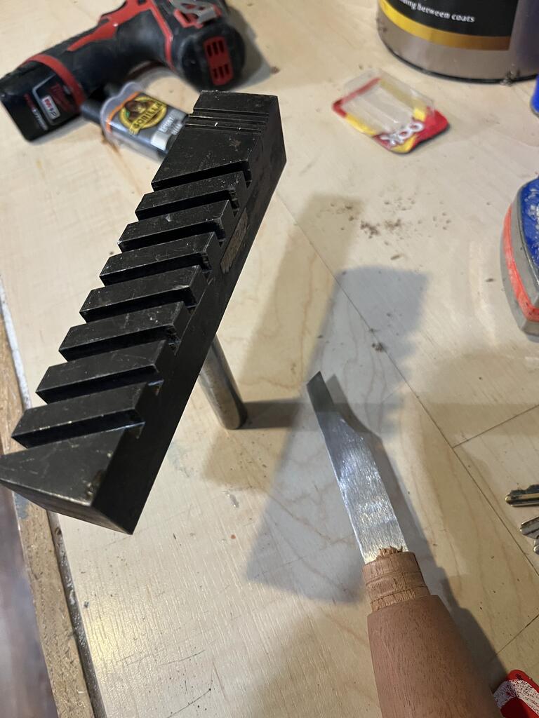

    I have this Marrison system jig, for cutting stacking rings out of a 3/4" board. The board needs attaching to a large 10-"? faceplate, so that as the rings are cut, they do not fly off. But then they need to be removed. I used to glue the board to the faceplate using thick paper, but this needs a lot of cleanup after removal. Recomend an easier method? Just finishing the dedicated cutting tool.

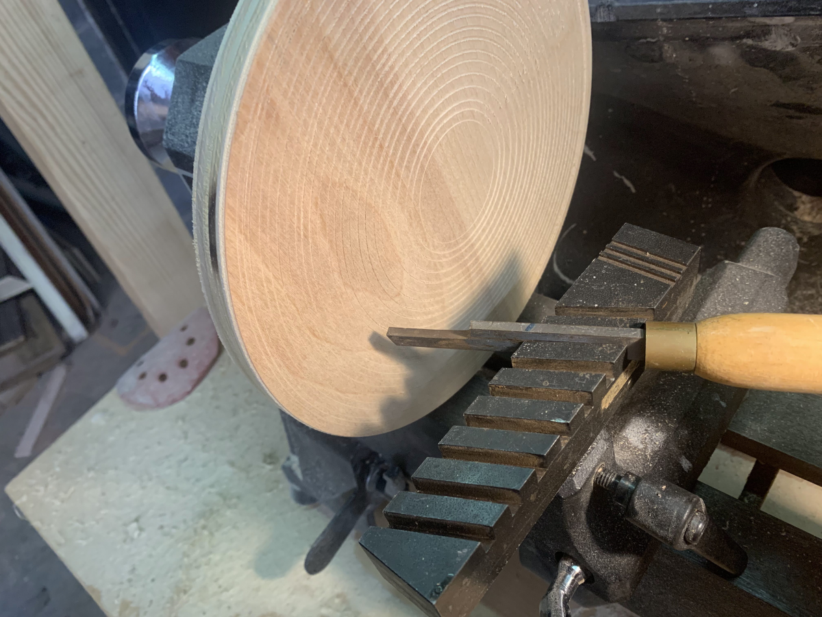

        Here it is in use, it is a tool holder for use with a lathe to get even spacing when cutting rings.
