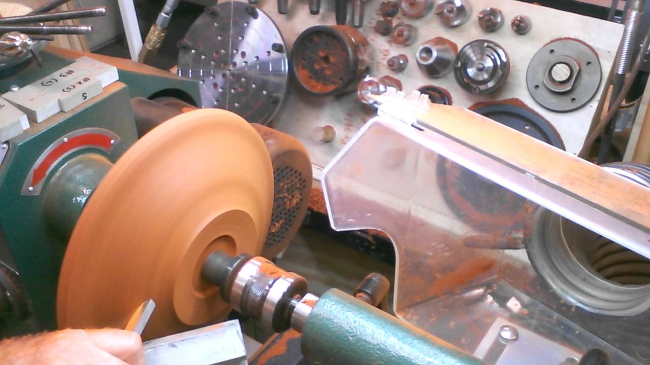

    So this is a turned, finished product. A friend of mine who moved cross-country gave me some 8/4 padauk, part of which became this platter. I also did a video on the project, on YouTube. I managed to keep this one down to about 13 minutes (video time, that is!)

          Hi Bill, I'm pretty new to turning so I've got some questions.
          --You drilled a hole on the concave side for your chuck but didn't cut in a slope to match your jaws--dovetail shape. Is that not necessary because you used the tail stock?
          --Around 3:50 you used a forstner bit to drill a recess in the bottom of the platter and then put your tail stock in. Why did you do that? (To define the platter thickness?) And why didn't you drill both sides at the DP?
          --Is it typical to completely finish one side of the platter like you did while you still have the other side to still rough out and finish? I guess you can't easily hold the bowl on the lathe once both sides are to final shape, right? I'd probably rush to finish the platter and then realize that after the fact.

              Thanks Paul, and great questions - my process:
              I have the Barracuda and "economy" chucks from PSI. These have the straight, serrated jaws, not the dovetail, so a straight sided mortise is preferrable, so you get more contact (a dovetail mortise would only contact the chuck along its outer edge, and doesn't provide sufficient hold and distribution of the jaw pressure.) I use the tailstock as an added safety measure, until it gets in the way.
              I could have cut the recess with tools instead of the forstner, but the forstner is quick and the exact size of my chuck jaws, although it takes a little more cleanup due to the divot formed by the point. This recess was in what would become the foot of the platter, and I leave the foot (some turners turn the foot away at the end, but I like them.) The mortise in the foot lets me reverse mount the piece for "hollowing" the inside of the platter. Some turners use a tenon (mostly on wet blanks), but I have seen and had tenon failures due the stresses placed on the wood fibers. I have had significantly fewer mortise failures (but I tend to leave a thicker foot for this reason.
              As for why drilling at the lathe vs. drill press - the first mortise at the DP (in the face of the workpiece) sets the center of your turning. It would be very difficult to drill a mortise on the foot side on the DP and have it be exactly centered to the mortise on the face, which will cause eccentricity in the workpiece when you reverse-mount to hollow. But drilling on the lathe leaves a hole centered to the workpiece.
              This is typical of how I turn seasoned blanks, since I don't typically "re-reverse" after hollowing to remove the foot. Easy to finish the bottom before hollowing. However, there are several methods of remounting to work the bottom; I use Cole Jaws made for my chuck, these: https://www.pennstateind.com/store/CJAWFJ2.html ; and for larger bowls, adding these: https://www.pennstateind.com/store/CRJA.html . However, you can also friction mount between a faceplate and "soft touch" live center, or use a vacuum chuck.
                Bill, thanks for the excellent explanation. It's clear to me now.
