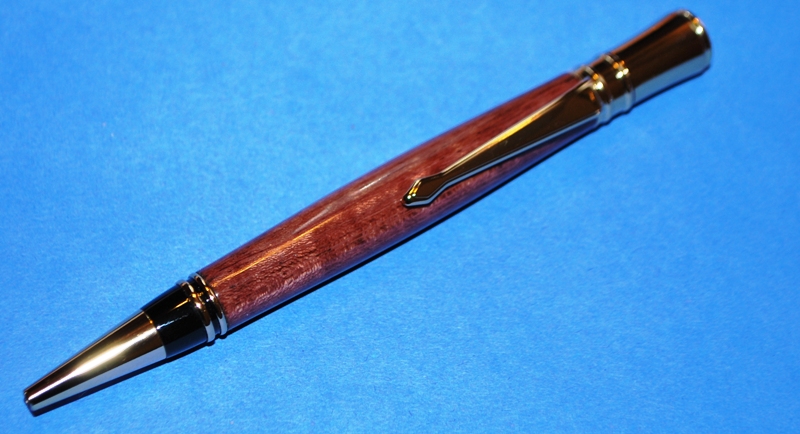

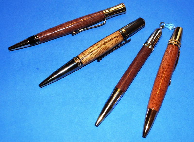

I finished all 5 in time for Christmas.. 4 are with new owners..

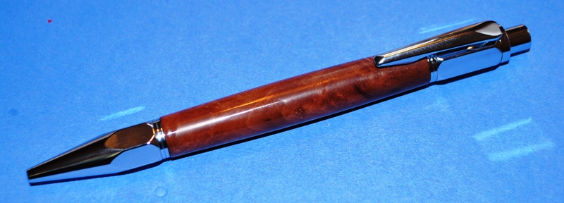

New ones are Purplehart Diva, Purplehart Executive and the last is a Madrona burl Virtex click pen.
The Executive is my cleanest one yet..
The finish on the burl is giving me fits.. it keeps doing dull in places after I get a good polish on it.William's Law--
cannot be solved by brute strength and ignorance.Comment
Great looking pens. Instead of waiting for the ca to dry, try a blo/ca combination. You can apply many coats in a short time and the finish comes out very smooth. This is a good video on applying blo/ca http://youtu.be/orcgOf4siqc.
Also, I have been using a synthetic car wax as a final polish with good results.
