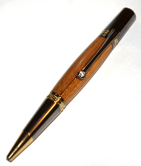

                            After finishing pen #2 I tore down the Polaris and cut it down some because I was disapointed with the shape and finish..
                            #2 is a Zebra wood Majestic Squire.
                            OMG I can't believe how Zebra wood stinks.. It smelled like the cat dropped a log in my shop..
                            I took Big Z's advice and turned it right down to the bushings then took them off and did my sanding and CA finish on the centers.. It works so much better..
                            This one has 1 coat thin CA. 4 coats thick, sanded up to 600 grit then buffed to a nice gloss with white rouge.
                            I need to work on my pen picture taking setup.. Treat it more like a macro shot and close the iris to increase depth of field.
