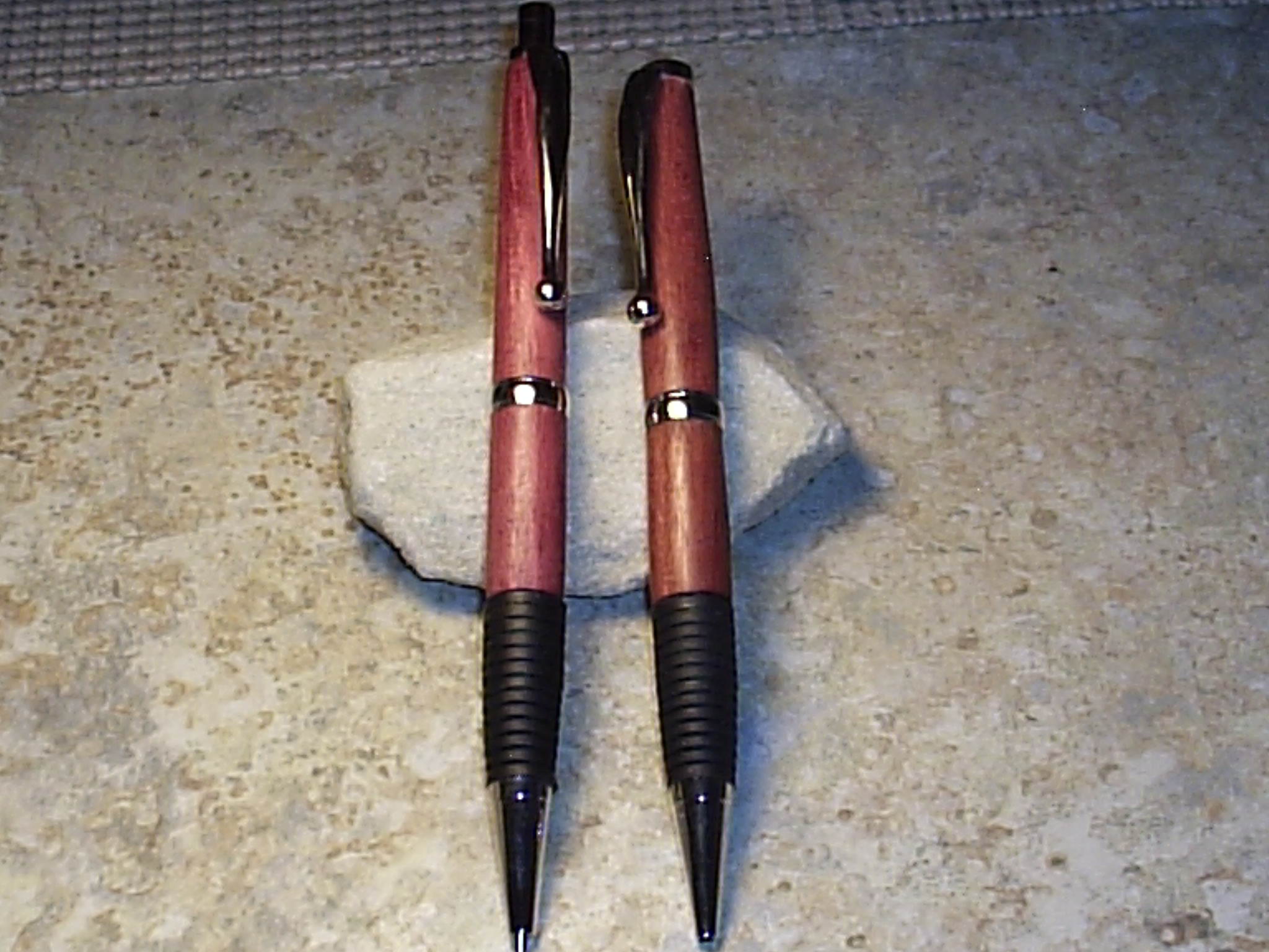

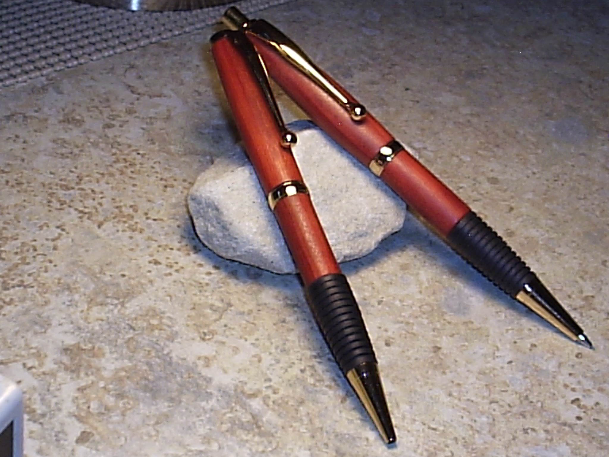

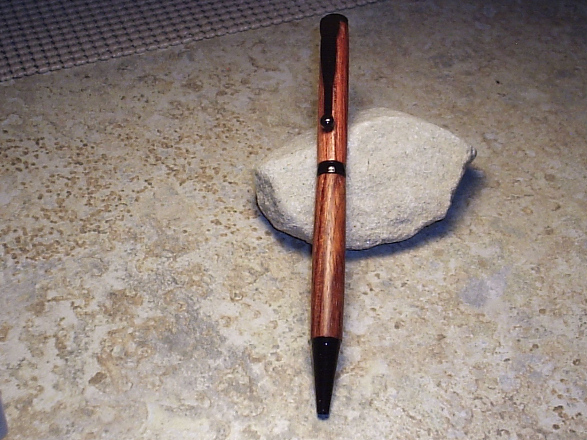

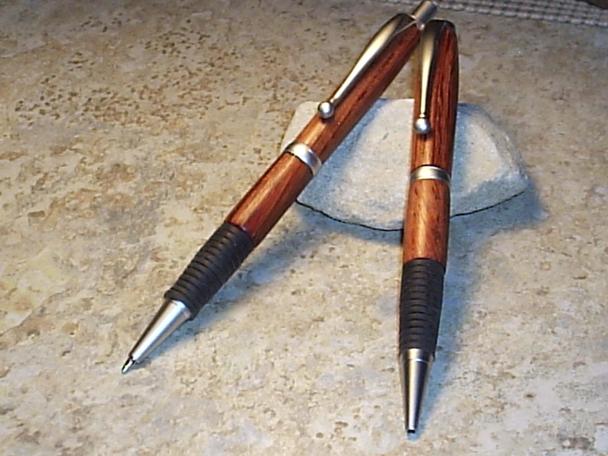

    I finally got a chance to post some pictures of my first turnings. I have some questions for the group also at this point. On my first pen, I am not happy with it because I did not take the wood down far enough (too afraid) and the wood to metal finish is not good. I feel I get better as I go along. When I get to the comfort style pen, I was having a problem when I had to cut an inch of the pen down to the brass tube, in every case, the super glue would break loose and the entire turning would start to spin and I had to take it all down and reglue it and then do it again. I am using a super glue of an in house brand from that well known supplier in Utah, has anyone else had a problem with that glue, or is it me, I don't think I wasn't using enough, I was getting run off when I glued it in the first time. That is my first question. The second is when I went to make a "click" type pen vs a twist type, I got one from WoodCraft and I was not at all pleased with the quality of the hardware. It seemed cheaply plated and I had to super glue the center band into the lower barrel and I also had to super glue the top clip into the upper barrel since the "press fit" was so loose, I could press them in with my fingers. Is this just the click pen, or should I stay away from all the WoodCraft pen kits?? Well, enough talk, time to try to get some pictures in here.
    The first is Rosewood w/24k brushed gold
    The second is Rosewood w/black enamal
    The third is Rosewood w/satin silver
    The fourth is Redheart w/24k bright gold
    The fifth is Purpleheart w/Rhodium
    I don't have pictures yet of the click one but it was of figured mesquite w/a really brassy gold. The mesquite really turned out nice.
    Bernie
