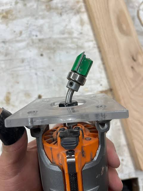

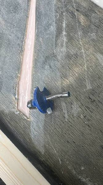

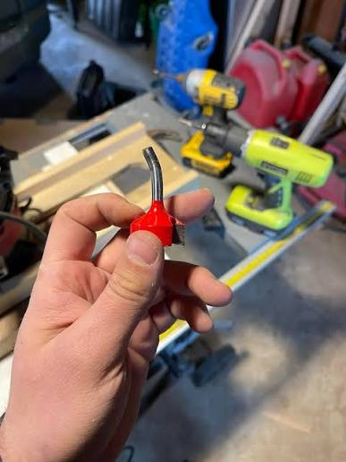

    Click image for larger version  Name:	image.png Views:	0 Size:	294.7 KB ID:	863452Click image for larger version  Name:	image.png Views:	0 Size:	317.8 KB ID:	863453Click image for larger version  Name:	image.png Views:	0 Size:	263.0 KB ID:	863456Click image for larger version  Name:	image.png Views:	0 Size:	431.2 KB ID:	863454Click image for larger version  Name:	image.png Views:	0 Size:	244.2 KB ID:	863455
    It takes a lot of energy to bend a 1/4" shank.
    My only comment is I can't find a picture of a bent 1/2" shank.
    Disclaimer - none of these is mine!

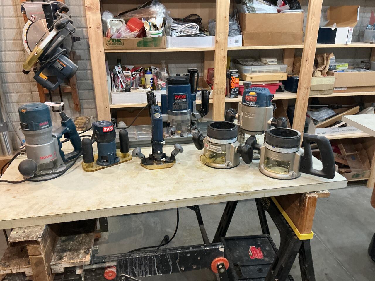

    My trim router is the second from the left.

      Most of those bent bits look like they were not installed far enough into the collet - too much shank was exposed. So the forces acting on the bit had a longer than proper lever arm to flex the bit. The collets probably didn't have a proper grip either. Collets need a minimum shank length to do their job.
      The yellow straight bit and maybe the other yellow bit look like they were installed deeper into the collet.
      My Freud bits have a line printed on the shanks showing the minimum collet insertion/depth. That line is closer to the cutting flutes than where these bits bent.
      edit: happened to notice in the Bosch 1617 manual that Bosch specifies at least 5/8ths inches (16 millimeters) of bit shank should be inserted into the collet. I'm not comfortable with anything less than about an inch based on the markings of my Freud bits.
      edit: I wonder what the operator was doing in the first picture with the green pattern bit. That bearing is quite far from the router base... was the pattern that thick?!?!
