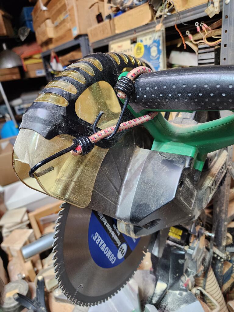

    I use a short bungee cord to retract and hold the plastic blade guard out of the way for blade changing.
    Click image for larger version  Name:	20251107_161047.jpg Views:	0 Size:	137.5 KB ID:	862180
    it also warns you if the saw is not unplugged, the bungee cord around my trigger starts the saw immediately (DAMHIKT).

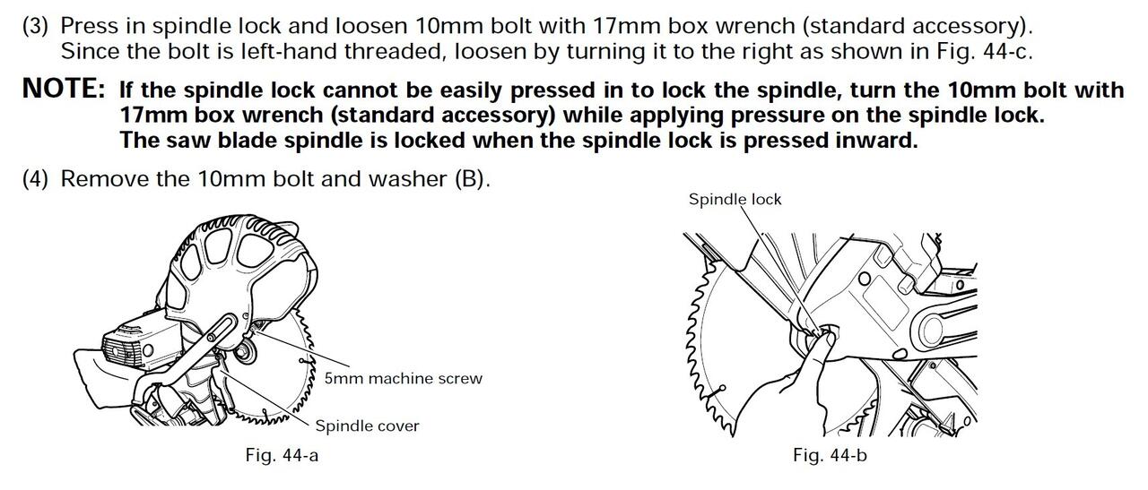

        On a previous miter saw the blade lock didn’t properly bind up the blade and would let the blade slip at the most inappropriate times. I used a pair of vice grips with a shop rag around its jaws to grip the saws blade to hold it so I could undo the nut.
          The use of the spindle lock is important... for me its mandatory to use so you don't have to hold the blade physically while wrenching on it risking getting cut if the blade moves.
          Your saw should have some form of spindle lock, it is not always obvious, check the manual.
          On mine its a tiny spring loaded button that when depressed, engages a detent in the saw spindle to keep in from rotating - you have to rotate the blade up to one full turn before it drops into the detent and the button depresses.
