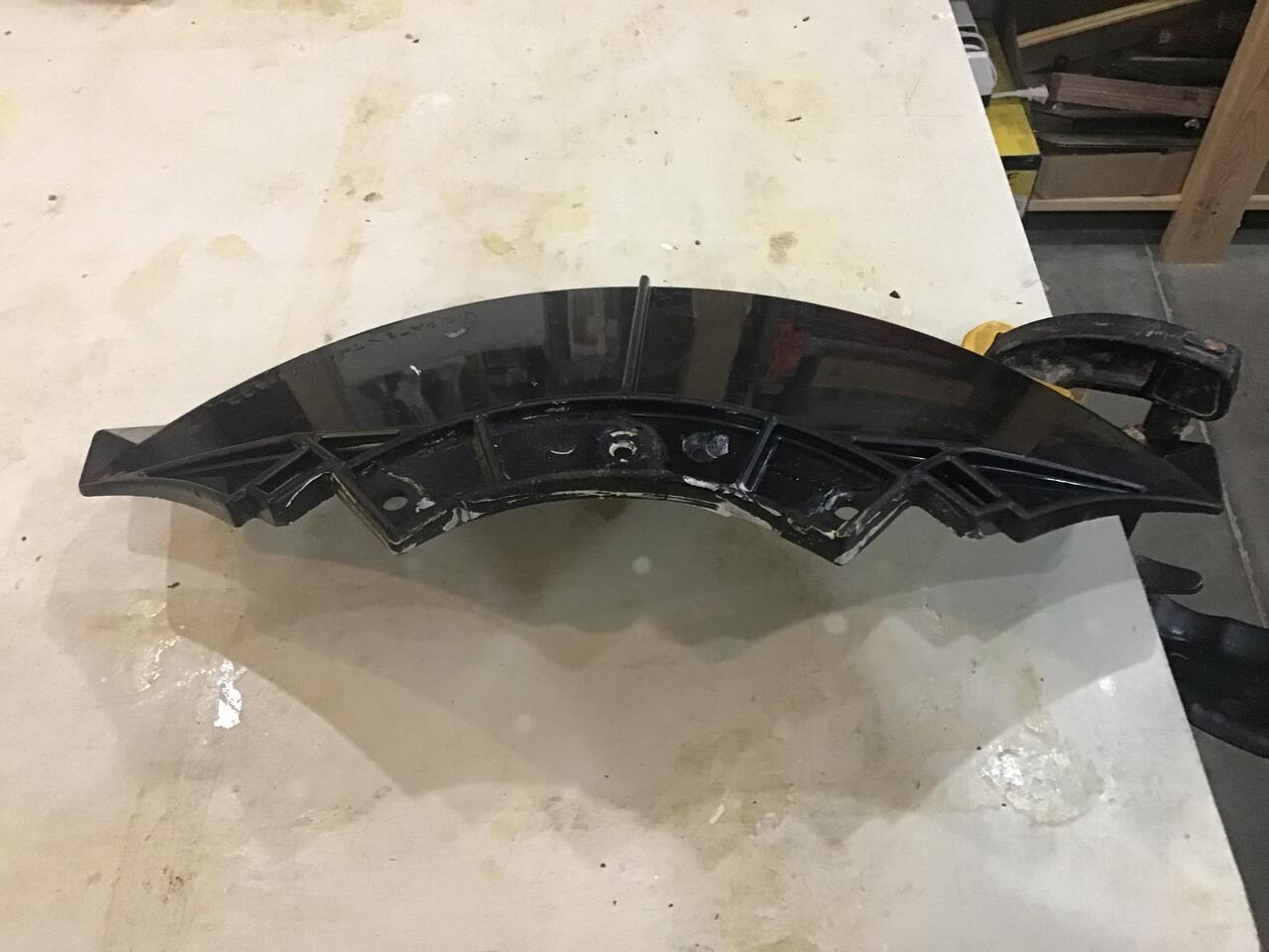

        Step One. Glued the broken parts back onto the main piece. I used Gorilla gel CA as there were some gaps from the breaks where the plastic stretched before it broke. I cleaned up the areas with a sharp knife and joined things back together. Interesting thing with the Gorilla glue. The instructions state to vigorously shake the bottle to mix the glue and then tap the capped tip sharply on a hard surface to load the glue into the tip before removing the cap. Turns out a lot of customers don't follow the instructions and claim the glue doesn't work. Click image for larger version

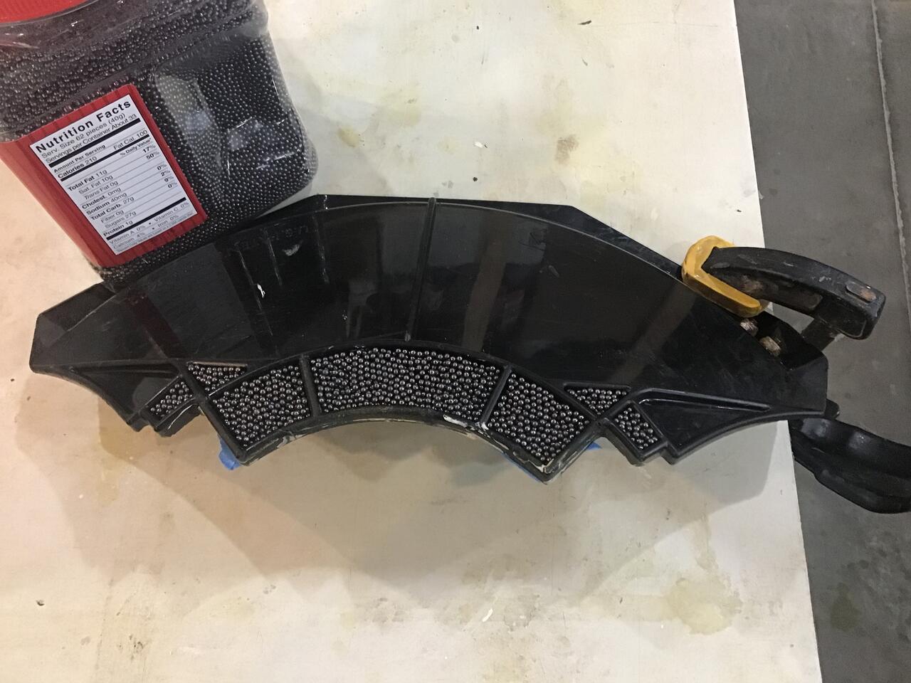

          Step Two. The lead shot/epoxy infill. The mounting holes were taped over to prevent the shot and epoxy from running out of the cavities. May have to do a follow up epoxy application as there was a wee bit of leakage through a couple of pinholes in the gel glue joints. Click image for larger version

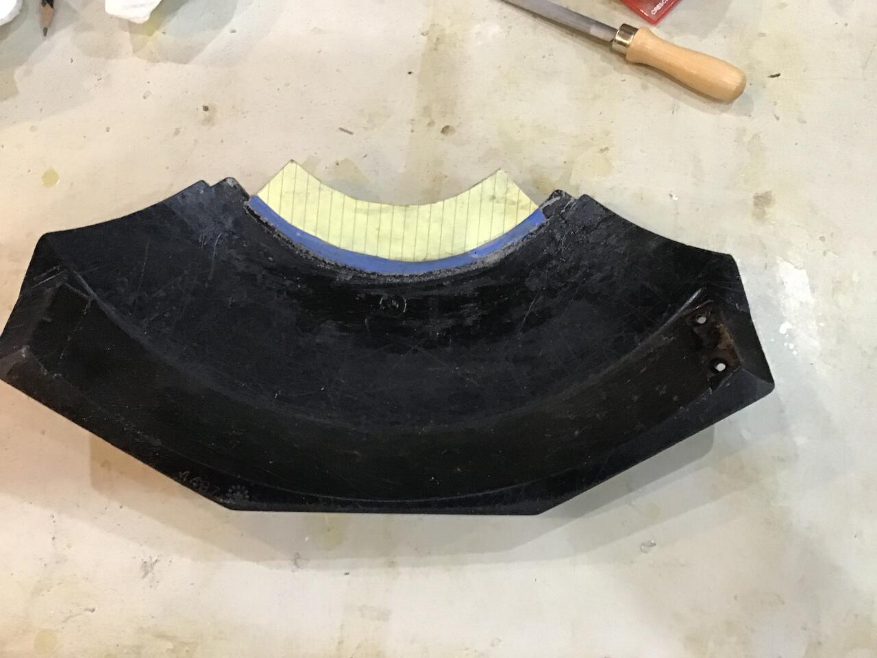

            Step 3. I spent most of the day researching prescription insurance since our current provider just told us the premiums would be DOUBLING for next year. According to the carrier, it's due to the increased costs from tariffs. All carriers have doubled their prices for 2026. Anyway, I drilled out the three mounting holes in the shield from underneath so I could use them to drill out the add on plate I will add to the underside of the shield to reinforce the mend. I made a paper template and will use it to cut the plate from some 7/64" thick plastic I have as leftover from the shipping materials from my electric riding mower.

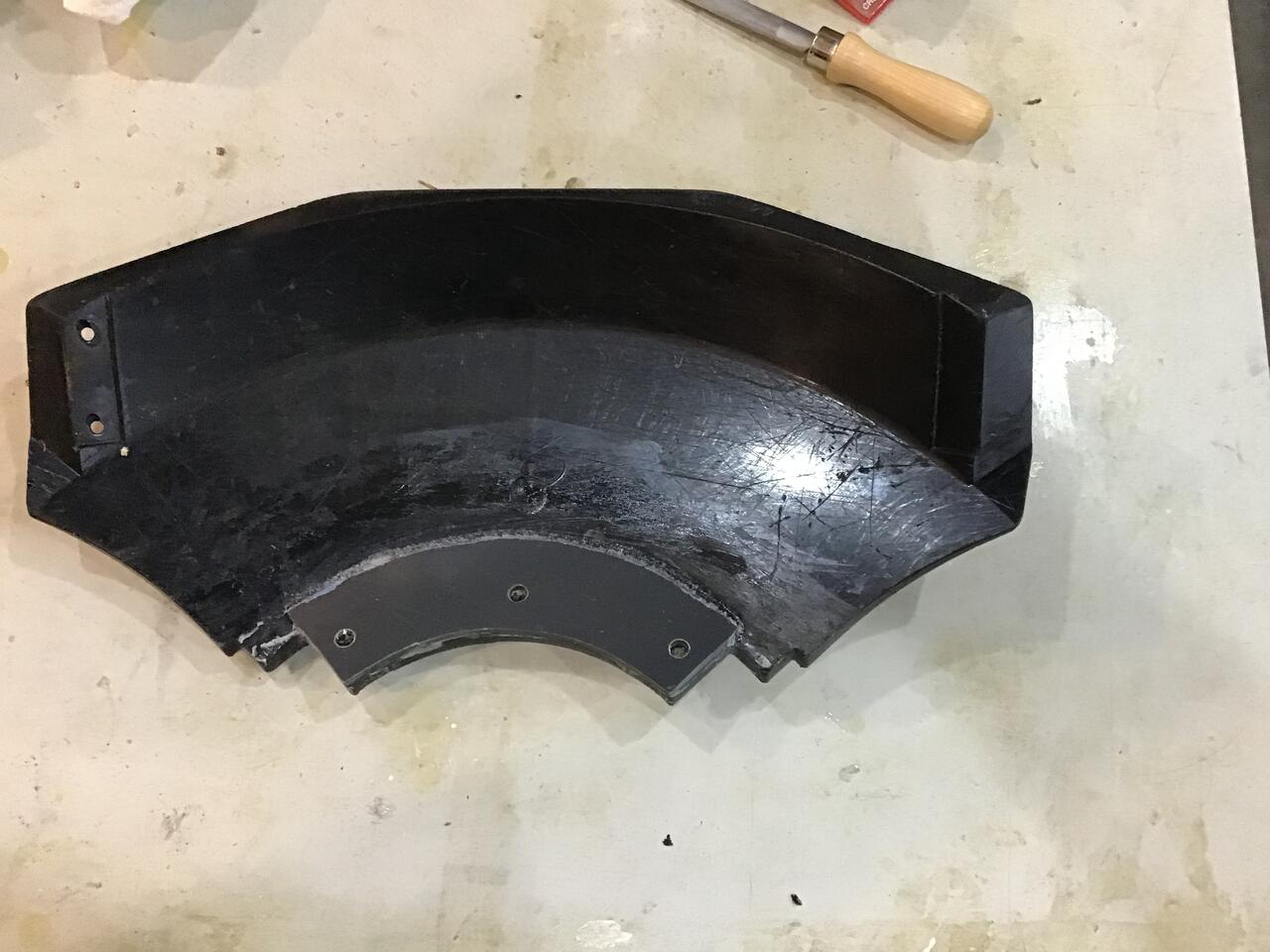

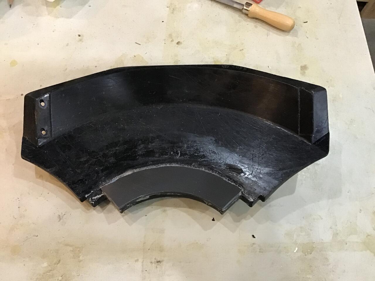

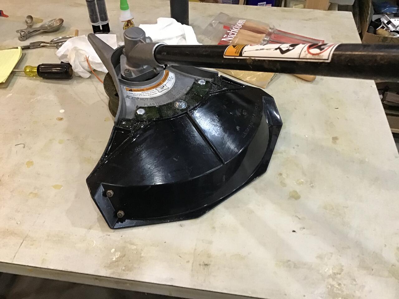

                Step four. The plastic backing piece was cut 1/4" wider on the convex side and the backside was tapered to mate with the shield to further reinforce the repair. I bonded the backing piece to the shield with e6000. This glue cures somewhat flexible and I thought it would provide some vibration protection. All of the edges were cleaned up with files and sandpaper and the mounting holes were drilled out. The shield was mounted with new, longer bolts as the mounting base on the shield is now thicker. While I as at it, I sharpened the line cutter, and re-lubed the gearbox. Maybe the rebuilt trimmer will outlast me.
