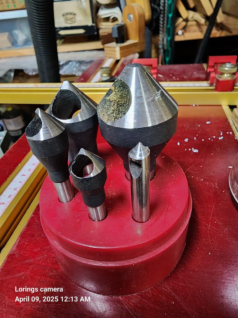

    Bought these a few years back, they are the best, cleanest cutting countersink I know. I call them zero flute or wormhole countersinks. AKA Single end countersink, cross-hole countersinks.
    Left - normal fluted countersink, right, zero flute Countersink:

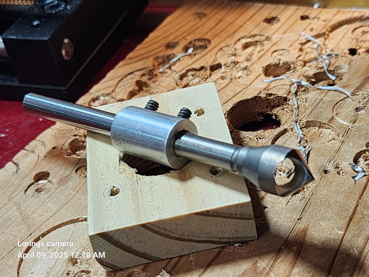

    They don't chatter so they leave a very clean bevel. I put one on an extension to match the length of regular bits so I wouldn't have to adjust table height (and possibly change the drill axis centering) when switching to the countersink.
    Work well on wood of all kinds and aluminum. Matches the 82° bevel of standard flat head screws.
    Just used the real skinny one to countersink some mounting holes on a T-track.

        Never seen countersinks like that before. Have you ever had to sharpen them? I'm curious how hard/easy it would be.
          LCHIEN commented
          never felt the need to sharpen them.

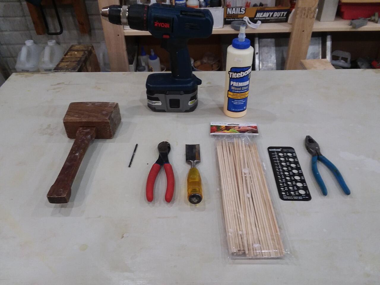

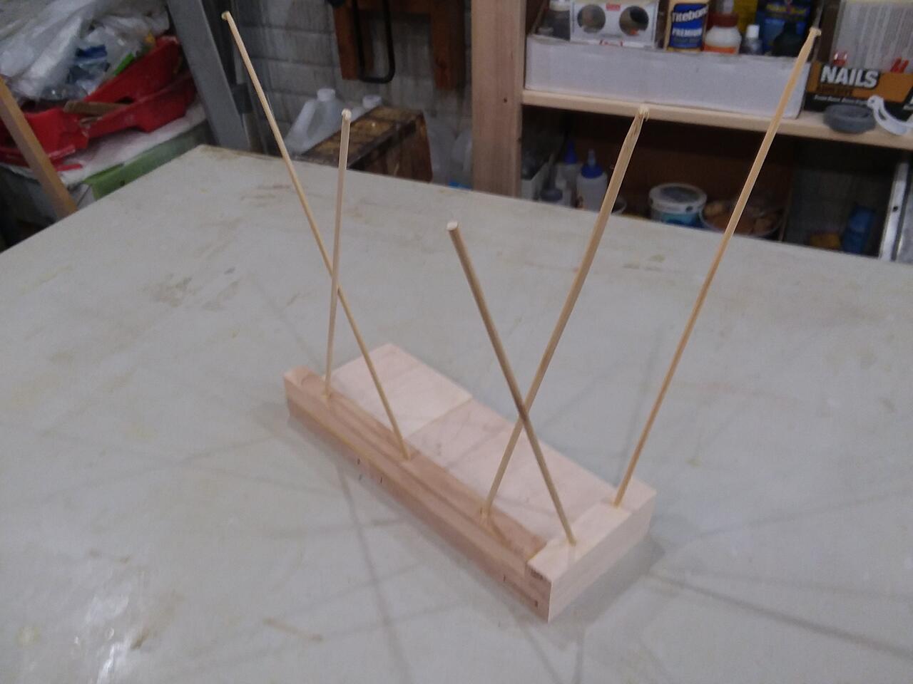

          Originally posted by leehljp
          Curious about one thing: What do you use for fastening - nails, pegs, biscuits?
          I started using screws and quit using nails (hand hammered nails that is) about 30 years ago, and use the pocket screws when possible. I quit pegs after banging my thumb when trying to over-tap a peg into a hole about 30 years ago. Man, that hurt!
          I use bamboo pegs (skewers) inserted after the glue joint cures to lock the joint from coming apart. It's time consuming, but so far, seems to be an alternative that works. The method can be used on virtually any wood joint. I've even used it to lock dovetail joints. I do use biscuits for panel glue ups and carcass construction, but will use the pins to lock carcass assemblies even with biscuits.

            OK several questions were asked.
            First of all, I do use the all-in one countersinks when drilling for holes for screws. Enough holes to make it worth setting the length and stops. They work well. And frankly the screw covers the bevel so it really doesn't matter how clean the bevel looks.
            Click image for larger version  Name:	image.png Views:	0 Size:	23.8 KB ID:	860977
            I use the zero flute ones where making holes that show. Holes in handles for hanging tools and fixtures. Holes in peg board games to make it easier to enter the hole with the peg and also look clean and finished. Also for equipment like jigs and adjustable stands where a peg can be put in a series of holes to adjust height or depth.
            Never had to sharpen them, so I don't know. DOn't seem to need it yet.
            As for finding them, they are everywhere. Google Zero Flute Countersinks:
