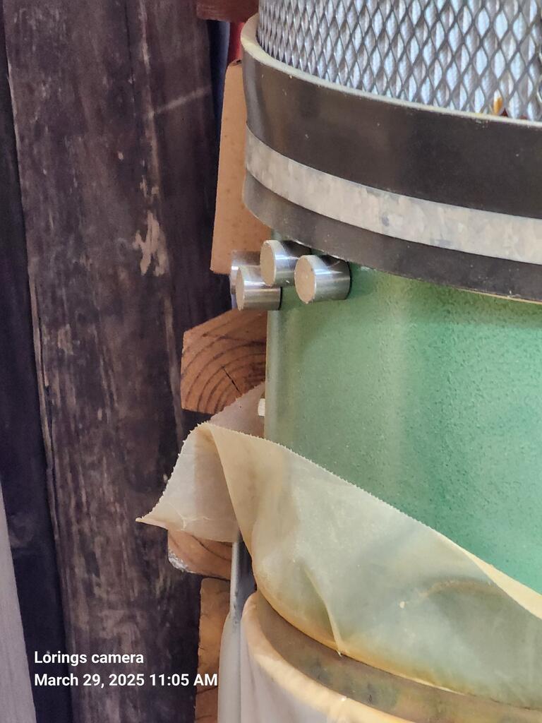

    I have a set of strong magnets. Probably at least 8. Neodymium. You can get stacks from Amazon, temu, banggood etc.
    Anyway position the new bag uniformly on the ring leaving enough room for the band after you get it in place with magnets evenly distributed. I just leave them stuck to the ring for next time. You can easily tighten the band because you have 8 more "hands" holding the bag in place.
    Click image for larger version  Name:	20250329_110521.jpg Views:	0 Size:	88.4 KB ID:	860848

        I do the same thing as LCHIEN does. The magnets really work well for a quick and easy bag change.
