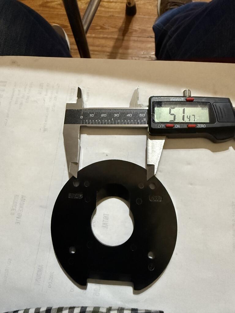

    In this thread: ( https://www.sawdustzone.org/forum/di...afu#post860597 ) I posted some picts of a jig for my DeWalt Compact router and also for my Makita Compact router. BUT I learned something strange about the Makita Compact! The Makita Compact holes are irregularly spaced. In the jig for the Makita in the above link, I had to use 3/16th slots in order to accommodate M4 screws into the base due to the different spacing between the front vs rear screws.
    The front two screws are 51.47 mm apart. I measured from the hole inside to the other hole inside. With shake hands, I could have been off 1/2 of an MM or more if I had tried to measure center to center of the holes and eyeballing it, but it was easy to clasp the holes inside to inside.

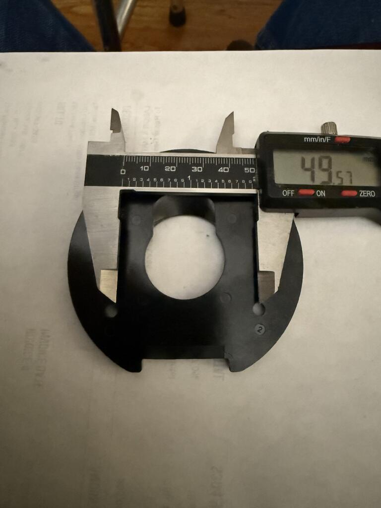

    The back two holes are 49.57 mm apart.

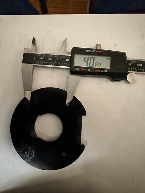

    The side to side are the same at 40.84 mm apart.
    Why in the world would they make such irregular spacing? It buggers the sliding slots up just enough that planning ahead is a real necessity. Maybe they expect the router to be mounted in slots from the side view! Well, maybe that what I should have done . . . but it would have messed up the accessory mounts and knobs.
Name:	Makita Compact Frt holes 51.47mm.jpg

Name:	Makita Compact Rear holes 49.57mm.jpg

Name:	Makita Compact side 40.84mm.jpg
