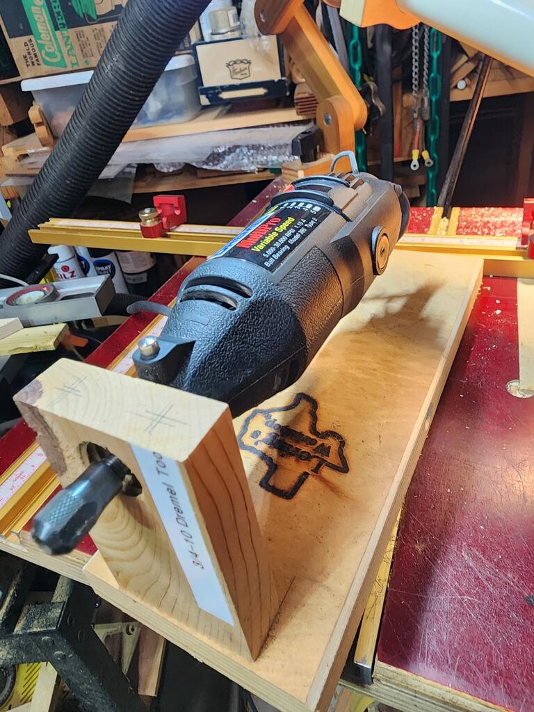

    Most people use Dremel tools handheld.
    But sometimes its nice to be able to mount the Dremel motor solidly.

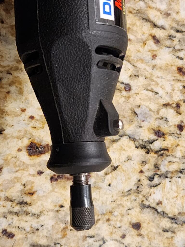

    The tool does have a mounting thread under a screw ring on the nose that can be removed.
    The thread is 3/4"-10TPI. I have a tap I got for this. Can make a mounting block for anyone needing it if you don't want to get a tap.
    https://www.amazon.com/dp/B00FXMF974?ref_=ppx_hzod_title_dt_b_fed_asin_title _0_0&th=1
    Having a fixed tool and moving the work piece is often better than having a moving tool and a workpiece that is fixed or also moving.

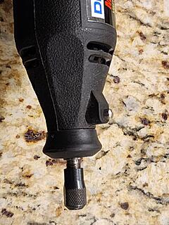

    Good way to mount the Dremel. I’ll like to point out something that may not hold true to all models and brands. I don’t think that the dremel should be used without the screw ring unless it is mounted inside a tool holder. The dremel casing is a 2 piece split unit and this screw ring holds the front together. I sometimes use one of my dremel’s quite often and they make my hands hurt for days.
      The case is split but on mine, at least, there is clearly a set of screws holding the case halves securely together.
      The nose screw is also used for mounting a mini-router base and some other accessories. So it's not really logical that its holding the tool together!

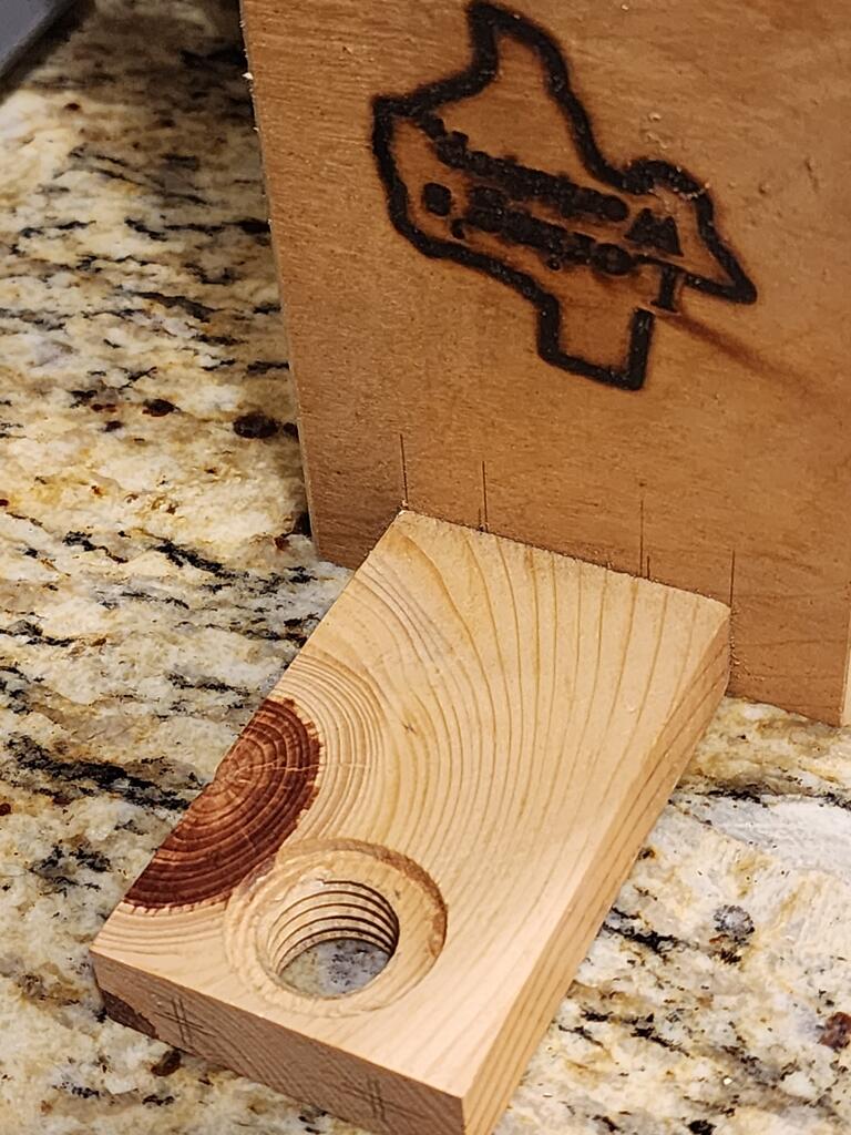

        A little more detail on how to make the holder piece for a dremel.
        Click image for larger version  Name:	20250121_232241.jpg Views:	0 Size:	119.9 KB ID:	860263 Click image for larger version  Name:	20250121_232221.jpg Views:	0 Size:	155.2 KB ID:	860264

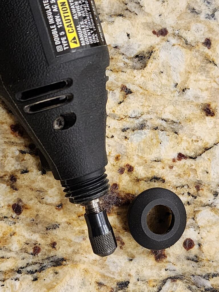

        As stated the trim ring around the nose is removed exposing the thread.

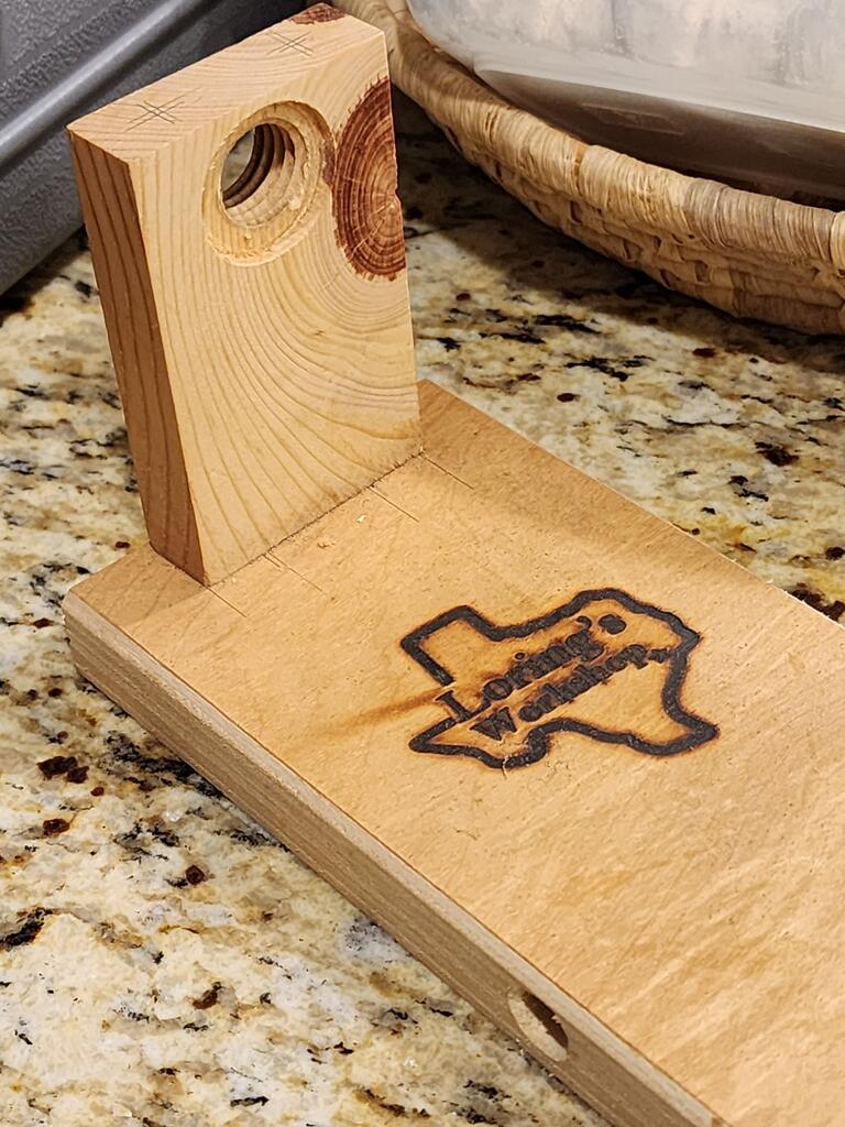

        I used a piece of 3/4" thick pine. Probably a scrap of 1x3; a 1x2 will probably work.

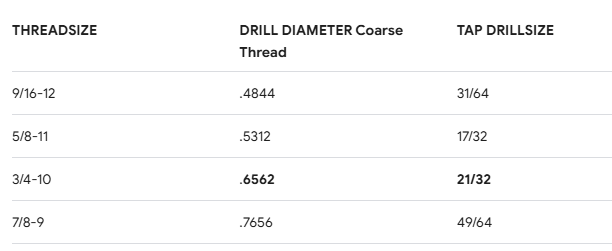

        I advise drill a 1/8"-1/4" deep 1" diameter hole first. Because the threaded part of the tool is only about 1/2".
        Then counterbore that all the way through with a 21/32" drill (the correct tap size), I didn't have one (a 16.5 mm will work, too) so I just used a 5/8" forstner which is 1/32 undersized, it seems to work fine when tapping and using it.
        Click image for larger version  Name:	image.png Views:	0 Size:	5.8 KB ID:	860265
        Then use a 3/4-10 Tap drill. I used a sub $10 tap (OK it was 2-3 years ago) from Amazon to thread it all the way through.
        Metalworking taps work just hunky dory on wood. MAke sure you enter the tap perpendicular to the face of the wood.
        Usually I remove the drill press belts, chuck the tap in the drill. clamp the workpiece to the table then carefully lower the tap with the drill quill handle and rotate the tap by hand to enter the hole while pressing gently on the press. Once you get a few threads by hand, you can remove everything and finish by hand easier but all square.

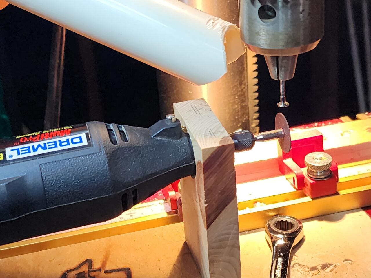

        Here I used it to position the Dremel tool under my drill press for precision lowering an item onto the spinning bit.
        The base was clamped with a T-track clamp that held it firmly to the drill press table t-track, although I did not capture that in the picture.
        Click image for larger version  Name:	20250117_175138.jpg Views:	0 Size:	130.7 KB ID:	860268
