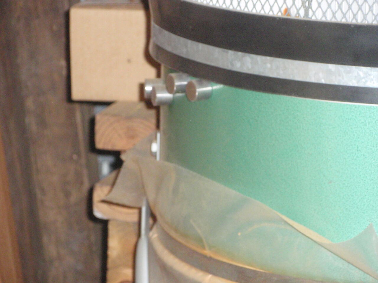

      The way to do this I learned, is to have a series of magnets to hold the bag in place, before tightening the cinch strap. 20 inch ring is 64 inches dia. and a magnet every 10 inches means 6 magnets. Better than having 6 hands!!! You get to make the bag nice and level and even out the excess few inches of bag circumference instead of having it all bunched in one place.
      I have a series of magnets stuck to the ring housing for the bag and filter. Ready for the next change of bags which might becoming soon.
      These are a lot bigger than they need to be, but easy to handle. They're the magnets out of seismic sensors.
      You can get stacks of the Neodymium disc magnets on eBay or Amazon really cheap.
      Click image for larger version  Name:	P9271346.jpg Views:	0 Size:	111.7 KB ID:	856326
