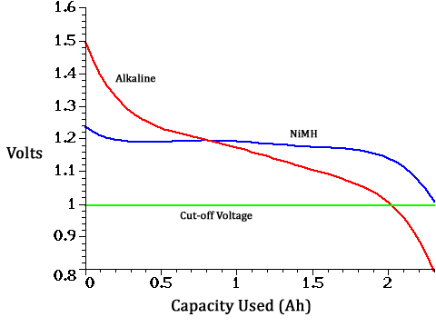

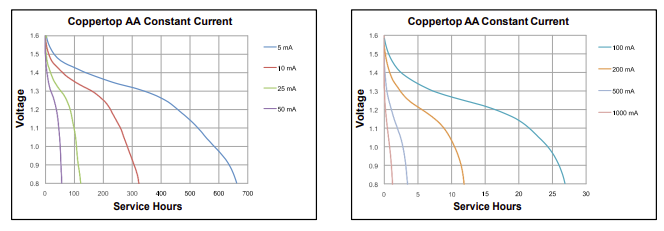

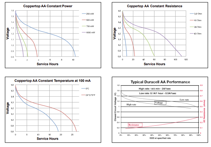

    professional battery testing labs usually don't have one instrument that does this. THey have programmable loads (with constant resistance, constant current and other current modes) and system voltmeters, and a system controller which monitors a number of loads and batteries for simultaneous testing and produces plots that look like this along with a computed capacity value
    Click image for larger version  Name:	image.png Views:	0 Size:	37.3 KB ID:	855751Click image for larger version  Name:	image.png Views:	0 Size:	85.2 KB ID:	855752​
    Yeah I know these are for Alkalines.

    and alkaline vs NiMH
    Click image for larger version  Name:	alkaline vs NiMH cell voltage under discharge.gif Views:	0 Size:	4.7 KB ID:	855754​
    ​Clearly such lab instruments can be used to test capacity of single cells as well as battery packs of multiple cells.
