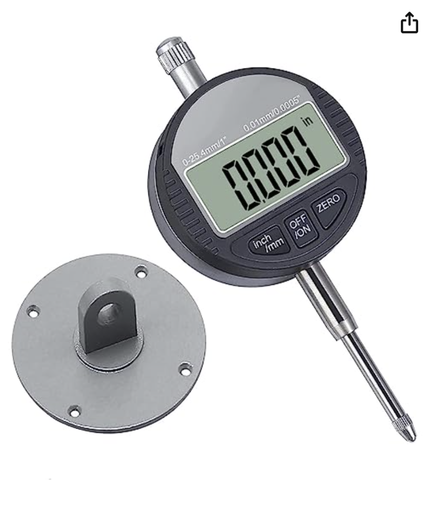

    Always wanted to have a dial indicator around the shop for various alignments. Bought this digital indicator on Amazon on Prime day but I am thinking of returning it. Main reason is I feel the response time is too slow. I believe an analog indicator might be much more responsive.
    Of course, I won't get features like inches/mm mode switching or data capture. But I think both of these features are probably not much use for my hobbyist workshop application.
    Do you guys think I am correct in assuming that a mechanical/analog indicator is much more responsive and useful? Or are there reasons for going digital? Click image for larger version

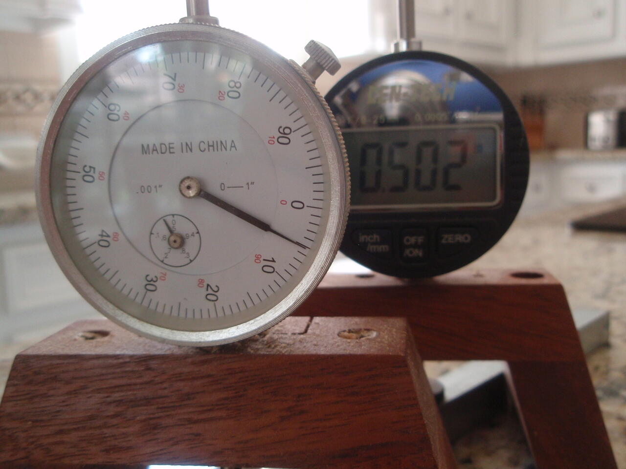

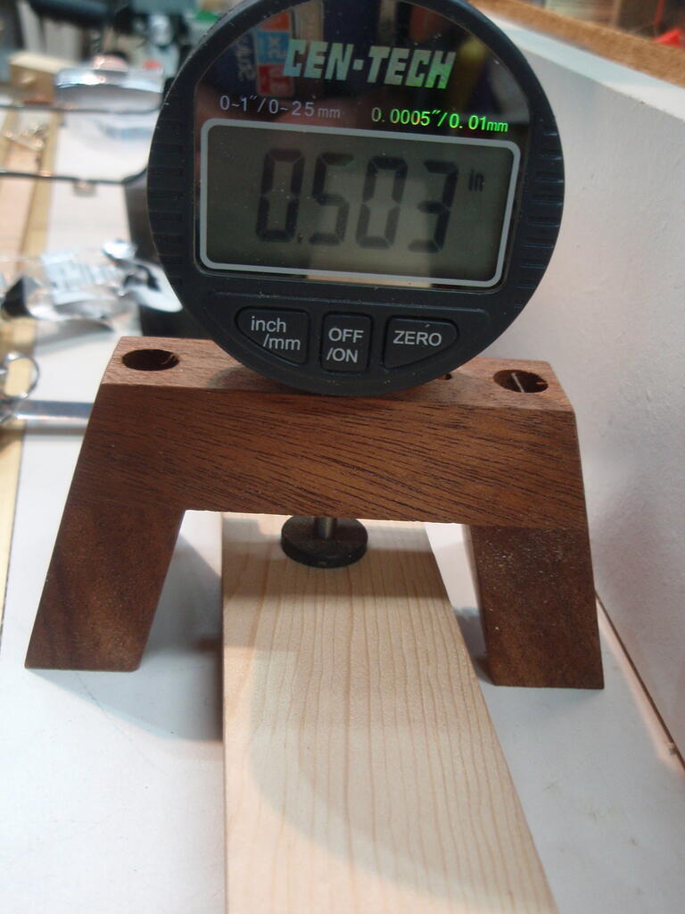

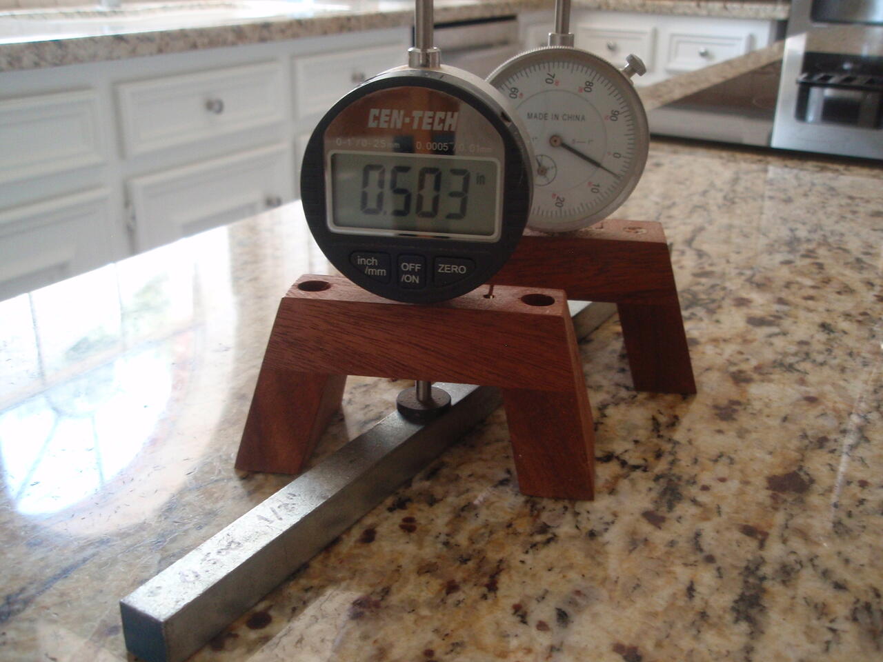

    Here are two of them on my DIY height stands over a 0.500" square stock.
    Click image for larger version  Name:	P8031305.jpg Views:	0 Size:	99.8 KB ID:	855691
    One is reading 0.5025 and the other 0.505 but the counter may not be totally flat.​
    I find them invaluable for setting router bit and table saw cutting height... as they are spring loaded they will follow the bit as I adjust the crank up or down. One key is the flat contact point. which allows you to follow a point on the blade or bit. You don't have to set and measure and correct and measure iteratively, you just go right to the setting.
    The flat contacts are a bit hard to find - they are specially designed for the stems on these indicators and have a 4-48 screw stud. Amazon has some now but they are $10 apiece.
    Ashok, ask me and I will send you a height gage stand and flat contact by mail. The stand will fit either analog of digital as they have a standard 3/8" bushing diameter. It's one of the more useful DIY jigs I have made. Very carefully made to keep everything square and flat.
    download and Look at the attached video clip of it in use.
    In use you want to set the height of the gauge in the holder so that the zero stop of the measuring tip is just below the bottom of the feet so that when the unit is on a flat surface the spring is depressed just a small amount, we're talking .020" or so. Set it on a flat surface or with the contact on the throat plate and press "ZERO" (or set the Bezel to zero). When you lift it up it should be free to go slightly negative.

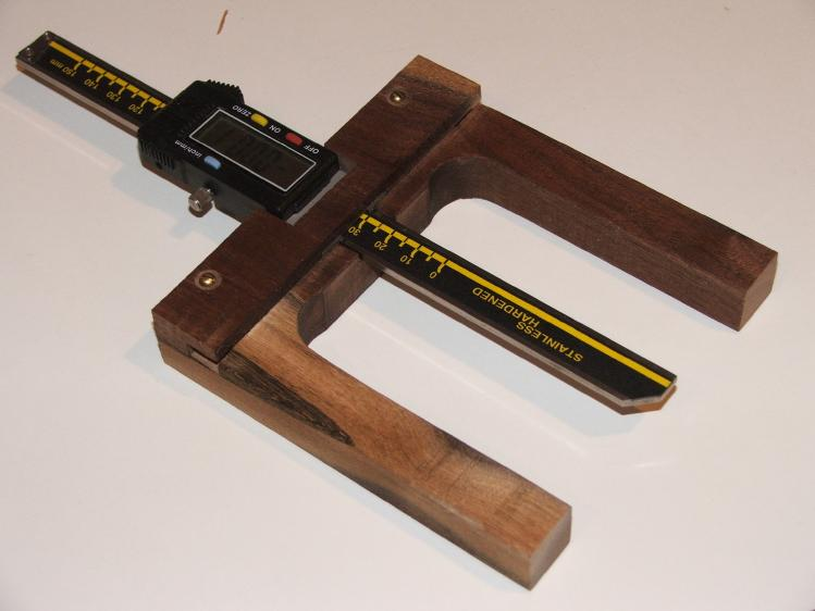

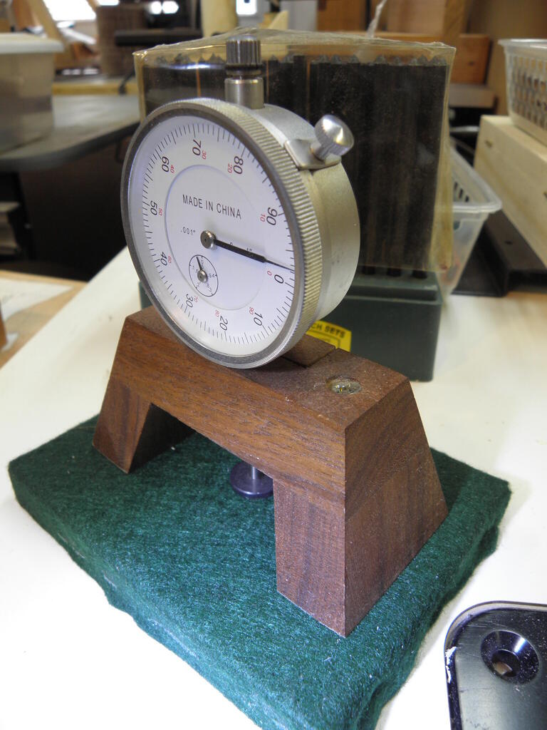

        I've made my share of height gages
        This one a copy of the One Way gauge:
        Click image for larger version  Name:	image.png Views:	0 Size:	269.3 KB ID:	855704
        Click image for larger version  Name:	image.png Views:	0 Size:	59.2 KB ID:	855708​

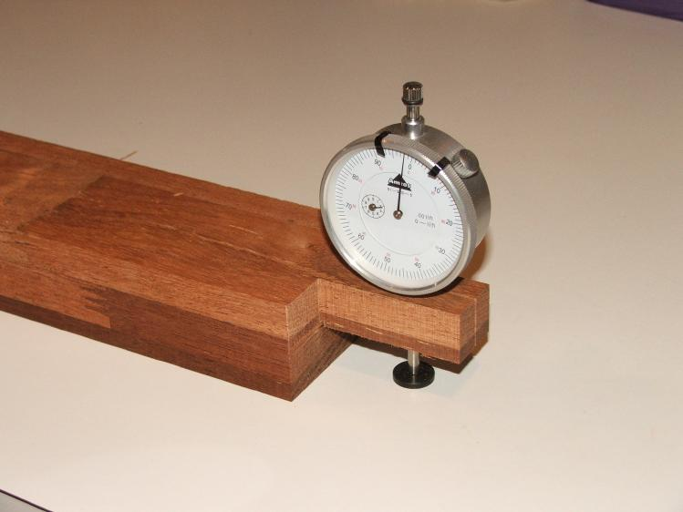

        This one for setting the jointer blades:
        Click image for larger version  Name:	image.png Views:	0 Size:	264.6 KB ID:	855705​
        This one for items up to four inches high:
        Click image for larger version  Name:	image.png Views:	0 Size:	305.8 KB ID:	855706
        plus the ones shown in this thread
        Click image for larger version  Name:	P4220980.jpg Views:	0 Size:	79.5 KB ID:	855702 Click image for larger version  Name:	P1052381.jpg Views:	0 Size:	106.4 KB ID:	855703

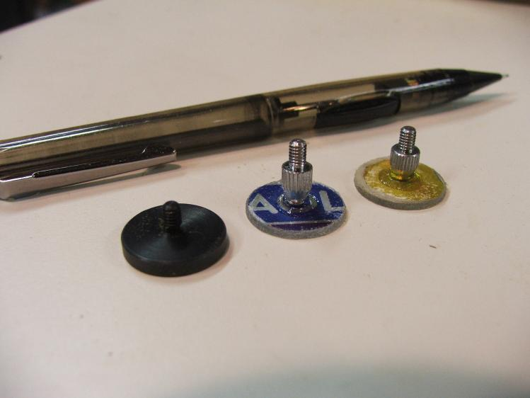

        and some homemade flat contacts
        Click image for larger version  Name:	image.png Views:	0 Size:	244.6 KB ID:	855707
        Before I found some commercial contacts, I only had the round tip ones that come with the gauges. They have a not really widely found​​ 4-48 UNF fine thread. I cut some disks using a 1/2" plug cutter from the old CDs (very flat) and then used the dial gauge in my holder which I knew was quite perpendicluar to drop the point squarely onto the disk with a dab of superglue. If your dial indicator is not perpendicular to the flat contact you get an edge error of 4 thou per degree on a half inch dia. disk.

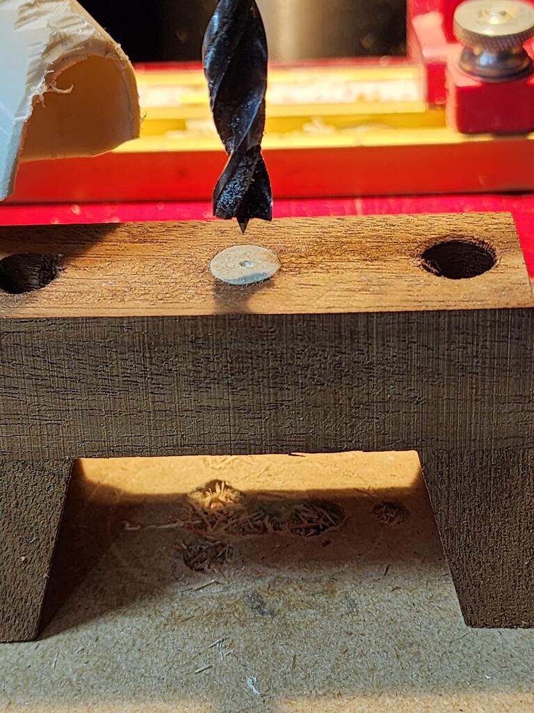

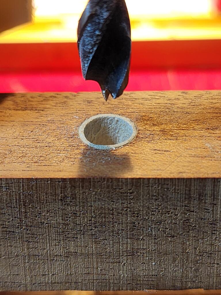

              Plug and redrill for DIN gage
              Click image for larger version  Name:	Plug & redrill for 8mm DIN gage 1.jpg Views:	0 Size:	143.6 KB ID:	855720 Click image for larger version  Name:	Plug & redrill for 8mm DIN gage 2.jpg Views:	0 Size:	140.7 KB ID:	855721
