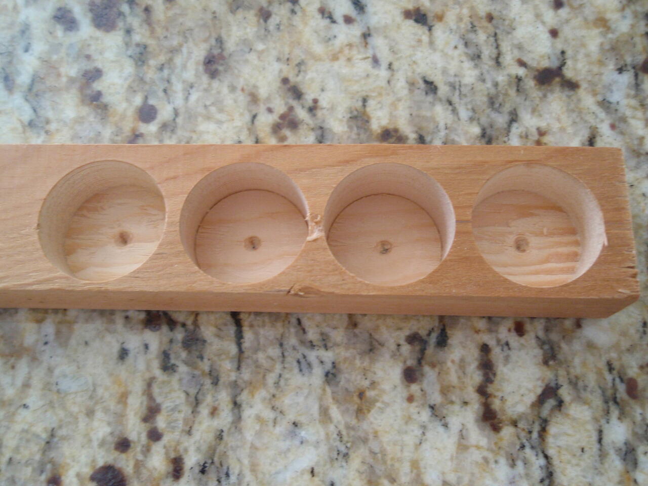

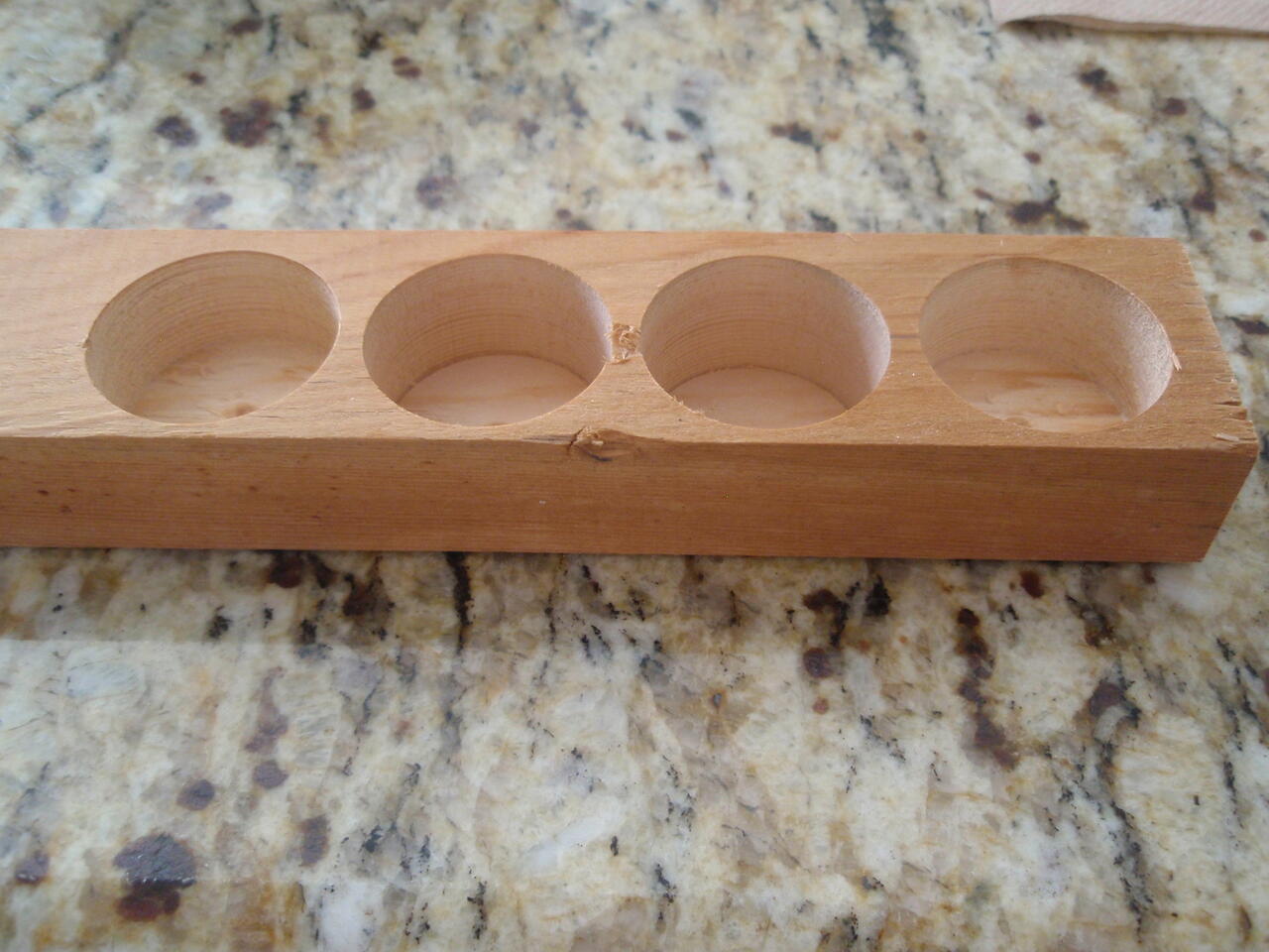

                I ran a quick comparison test...
                1-1/8" Freud brand new vs my Drill Master (Harbor Freight) set's 1-1/8" bit that's maybe 20 years old.
                Click image for larger version  Name:	P7261294.jpg Views:	2 Size:	135.6 KB ID:	855615 Click image for larger version  Name:	P7261293.jpg Views:	2 Size:	132.3 KB ID:	855616
                I just did a real quick test in a piece of scrap pine, two holes with each. Shown above.
                I can't really see any difference in the holes quality wise, in the bottom or the side or the entry. I did not check for splintering on the exit which I should have.
                The middle two holes are the Freud which you can really only tell by the sharper corner left by the spurs. The Drill Master actually leaves a flatter bottom as its spurs dont' cut so deep. I am impressed that the quality of the holes is pretty close. Maybe the longer spurs prevent tearout on exit.
                What is a big difference is the cutting effort. Applying what I thought was a reasonable and similar amount of pressure on the quill handles, the Freud cut the hole in about 6 seconds while the Drill Master took about 16 seconds! That's a major difference in sharpness!

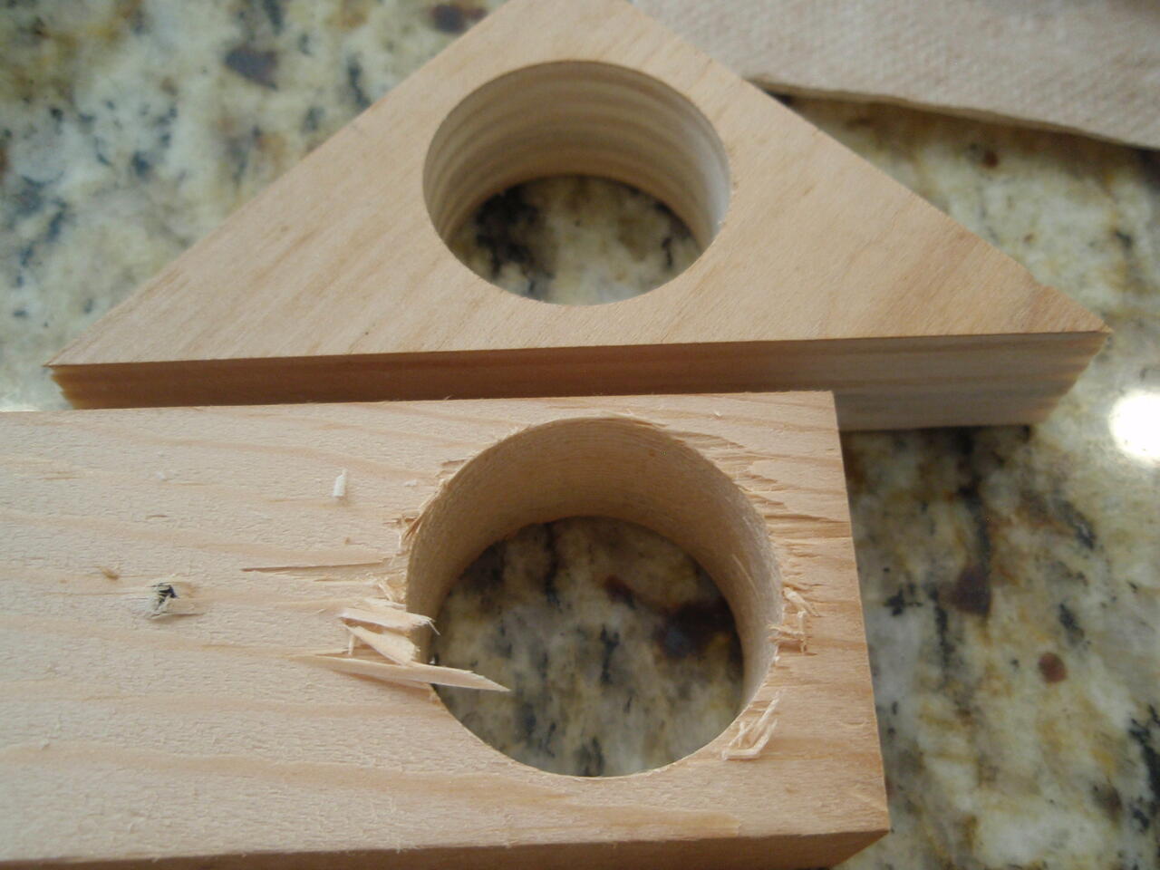

                    Oh, wow.
                    As I expected the slightly deeper spurs of the Freud make the exit holes very clean.
                    I had been used to tearout on the exit of my old forstners, I would cut until the center point exited the bottom, then flip and enter the hole from the bottom using the center point to align and get better exit holes.

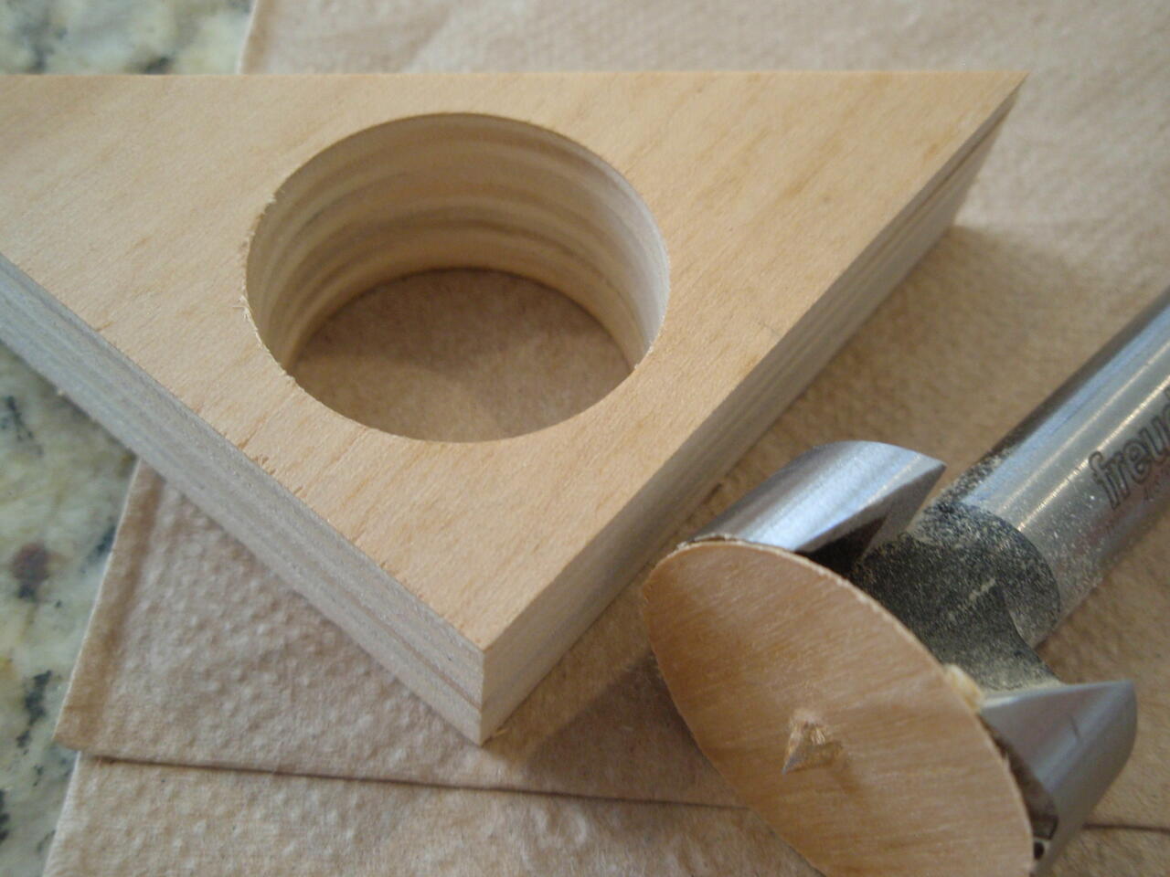

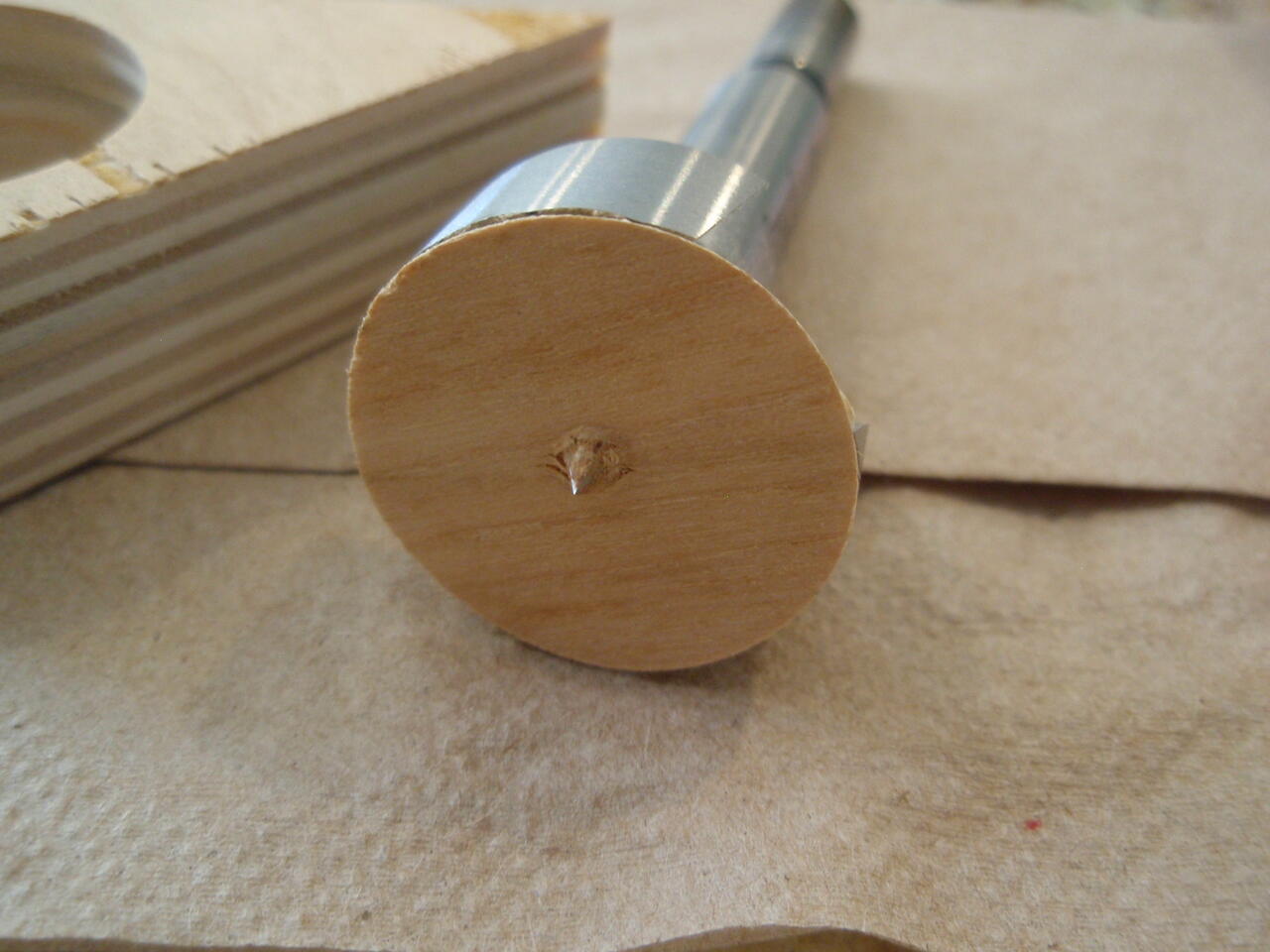

                    Here is the Freud forstner and the piece it separates using the spurs.
                    Click image for larger version  Name:	P7261297.jpg Views:	0 Size:	97.2 KB ID:	855619​
                    And here is the exit side of a piece of plywood with the Freud:.

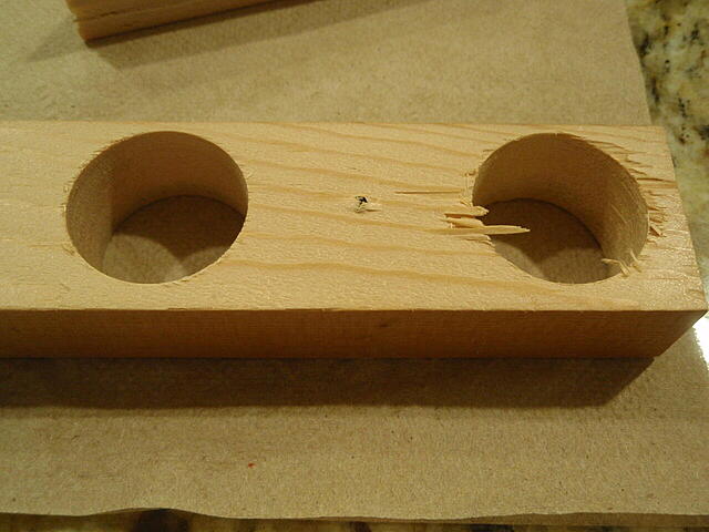

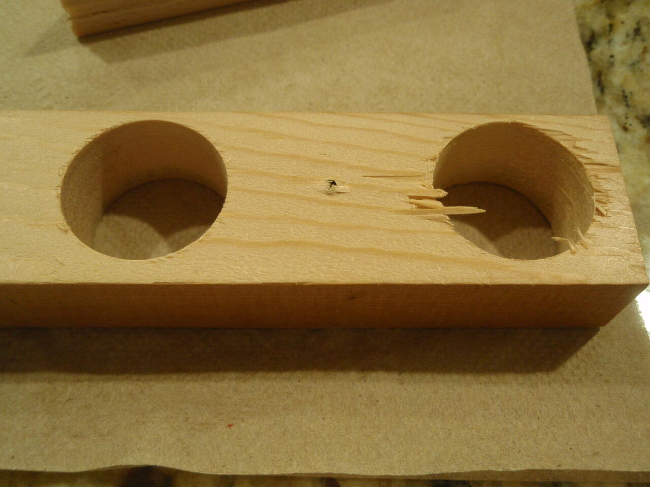

                    ​Side by side comparison exit side tearout on the same piece of Pine wood:
                    ​ Click image for larger version
                    Left: Tearout from Freud, ​
                    Right: Tearout from Drill master (HF)
                    All holes are at 990 RPM using Drill press and a backup piece of wood.
                    Yeah, I'm definitely going to treat myself to a set.
                    Faster cutting (sharper) and no tearout on exit.
