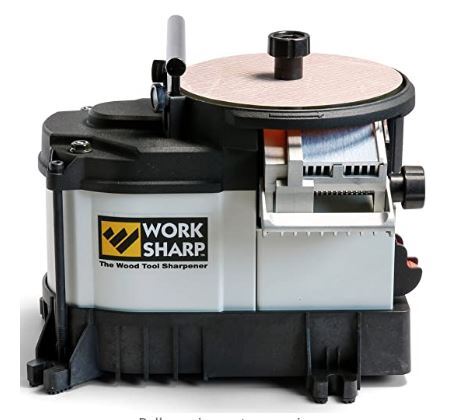

      You can almost buy a Worksharp for that kind of money. Click image for larger version

        You're telling me! I can get a Wen sharpening system (Tormek clone) for less money new.
