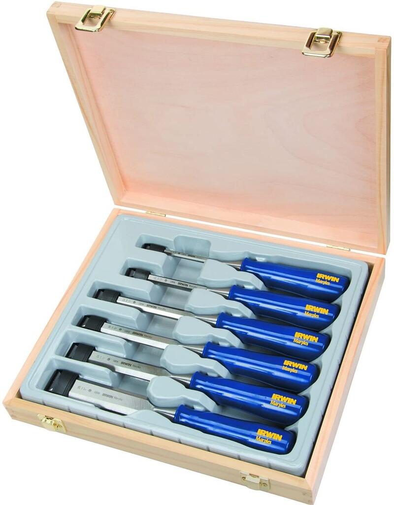

    I am considering the Irwin Marples M444 6pc set. It has sizes 1/4, 3/8, 1/2, 3/4, 1 and 1-1/4in which would easily replace the Stanleys, the handles and blades look to be a good bit longer than the Stanleys which should make for a more comfortable operation.
    I know my local Lowes has them, but I am kind of hoping to hear from the person that owns one as it were. How is the metal on them? I can check for comfort / fitment in store but I don't want chisels that will flake apart as I use them...

    And the Irwin / Marples chisel set.

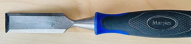

    Since Irwin bought Marples, they changed the handles first, then moved the production to China. Reviews of the current chisels are that they aren't any better than any other inexpensive set you can buy on Amazon.
    If you can find a set new or used that is stamped with Sheffield England on them then you'll have a quality chisel. The one below came in Irwin packaging, but was purchased right after the sale of the company and nothing had yet changed. Look at the full size picture and you still make out the Sheffiled engraving on the blade.

      I bought a set of four Marples chisels several years ago when they were still being made in Sheffield, England. The handles are steel capped and they've held up well with my occasional use. However, shortly there after, the manufacturing went to China and the steel quality suffered. I recall a few posts at the time from owners disparaging the poor quality. One posted picture showed a blade that actually split down the middle.
