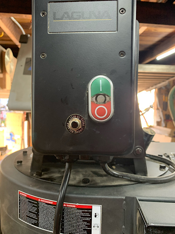

    I bought a used laguna cflux 1 on Craigslist. I stupidly assumed it was 240v because it had a 240v twit lock plug and plugged it in. Motor turned on briefly and the onboard circuit breaker tripped. Realization dawned and I realized it was wired to 110. Initially planned to rewire to 240 but found out you need to order a new switch assembly which weren't cheap. So I decided to keep it 110 and added a 30 amp breaker (10gauge) wiring and hooked it up. Now the switch lights up when I turn it on but nothing else. No smoke and I don't see any burnt parts. Any hope , suggestions on what to test or am I sol and need a whole new switch assembly?

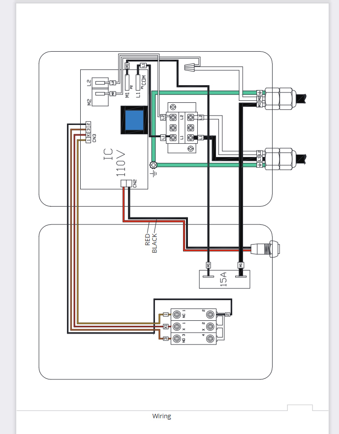

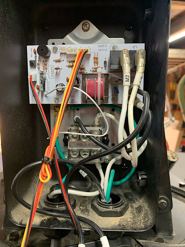

      Loring... Laguna devices typically use an electronic equivalent to a "magnetic switch" rather than a plain switch like the BT3. Once turned ON by the operator, magnetic switches need ACpower to remain ON. If power fails the switch automatically reverts to the OFF state. The idea is that a tool will not turn ON after a power failure; the BT3 would restart as soon as power was restored unless you remembered to hit the OFF switch while the lights were out. Laguna uses different electronic circuits for 120 versus 240 volts... besides any motor parallel versus serial wiring changes you find on many tools. I don't have good schematics of Laguna's electronics board to figure out what might have fried. If the whole electronic board plus motor assembly were in my shop I might be able to debug it as I have basic electronic test equipment and thus could test most of the components individually.

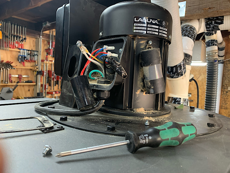

        If it was mine I would build a test 110 v extension cord and wire straight to the motor circuitry, skip all of the motor starter and circuit board stuff, just to see if the motor was ok. That done the rest of the board could be tested, and you can sleep better. If the board is fried you can always build your own box with a contactor and remote start just so you can use the collector while you find replacement parts.

          If they had separate control boards for 120 and for 240 then I suspect that the board is fried. Capncarl's suggestion to test the motor is a good one.

            Thanks for the replies. As you guys suggested the board is probably fried. I shorted the L2 and M2 wires and motor turned on as soon as I flipped the breaker. Laguna service rep says I can order a replacement board and can get it for either 110 or 220. Normally I would have gone 220 right away to gain the benefit of lower current draw but I already spent all the time and money to wire it 110 so I'm undecided. Any other benefit going 220?

                  Yes I replaced the board and it fired right up. I decided to go with a 110v. Ordered a remote as well. It works great and am happy with it except for the size dust bin. It’s smaller than my previous dc
