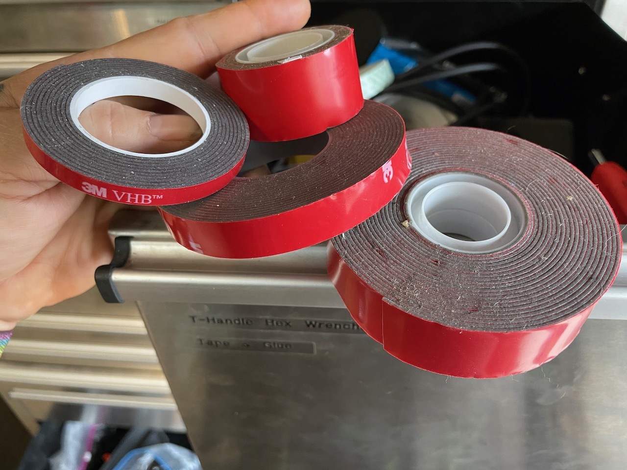

        3M VHB is a very important item in my solutions arsenal, but pretty sure it can't do a levered load like that for long either. Though I might be surprised. The thicker the shelf, the more likely it will succeed. I'd consider it possible if you could apply two 1" strips, so that the load becomes a straight pull against the top one, not a peel pull. These tapes are specifically designed to be able to be peeled without leaving anything behind. I have VHB holding light outdoor stuff just fine, even on concrete walls and stucco.

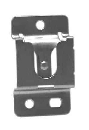

          I've used THIS 3M tape for many years in applications that have surprised me. Years ago, when installing marine electronics, I was going to attach a microphone clip near the helm, but coulddn't reach the owner to ask if he would prefer it to the right or the left of the helm. I cut two pieces of that tape and fit it to where the screws would mount it. and stuck it where I would have wanted it.
          Years later, it's seen a lot of use and is still stuck there by the same tape.

            My boats have been full of VHB, even in splash areas, or a wet hot bilge, with nearly perfect results.

              • Carlos
                • 1893
                • Phoenix, AZ, USA.
                As far as I know, all of the gray tapes with red cover are VHB. I have no idea if there are differences, but I just used them interchangeably. Keep in mind that Scotch is a 3M brand and at least one of my rolls was branded that way.

                    I'm jealous. Looks like at least $100 worth of tape, there, and thanks for the clarification.
                    It looks like the same product I buy at Home Depot, but I notice that there are two similar 3M products, now. I am used to the gray stuff, but there is now extra heavy duty black tape with the same red release film on it.
