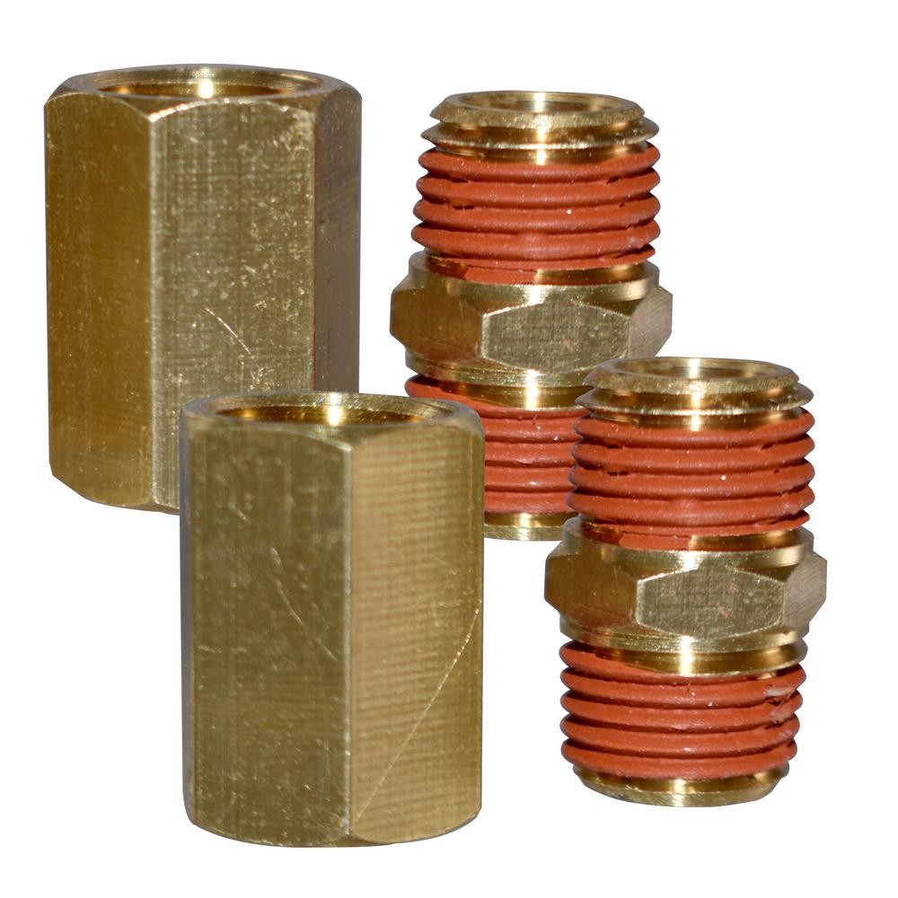

    Have any of you use the fittings with the factory pre-applied reddish-brown dry thread sealant on the threads?
    Click image for larger version  Name:	husky-air-tool-fittings-hda31400-64_1000.jpg Views:	0 Size:	135.5 KB ID:	840234
    My understanding is that you don't need to apply thread sealant like Teflon tape and that you can reuse the sealant up to five times.
    But some professional mechanic says its not very reliable and he avoids them.
    Anyone used these and have experience with them good or bad?

    I have not seen that before. I will keep that in mind in the future but I am happy with my blue HD teflon tape for now.

      I have a lot of these, and have never had an leakage issue with them.
