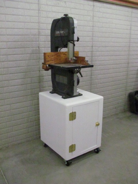

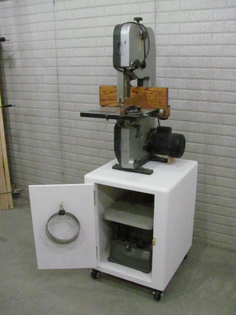

        I've had an 1120 since the late 90's. I really like it. It tracks well and has plenty of power. I've used for resawing as well regular work. I made a tall resaw fence that clamps to the table and I also made a taller miter gauge fence for the saw. I have a metal cutting blade for it and on slow speed, it cuts mild steel fine. My saw sits on a shop built roll round base as I have a small shop. My OSS stores inside the cabinet. I made my own blade guides from white oak soaked in Watco Danish Oil for several weeks. They last a really long time and can be buried in the blade if necessary. The only replacement parts I've needed was a belt. The original broke and I took it to a local belting and gear shop. They matched it to a Gates part. I bought three and still have two spares. I filled the plastic knobs with #7 1/2 shot and epoxy, so they will never break. Tires should be easy to find, but since I'm very careful not to leave the bands tension-ed when not in use, mine are still like new. When new, I had to balance the wheels some to get it vibration free. The wheels were coplaner out of the box. I also ran a small round bar around the wheels under the tires to make sure they were evenly stretched on the wheels with no high spots to cause issues. Click image for larger version  Name:	IMG_1802.JPG Views:	0 Size:	62.7 KB ID:	837363Click image for larger version  Name:	IMG_1803.JPG Views:	0 Size:	65.2 KB ID:	837364

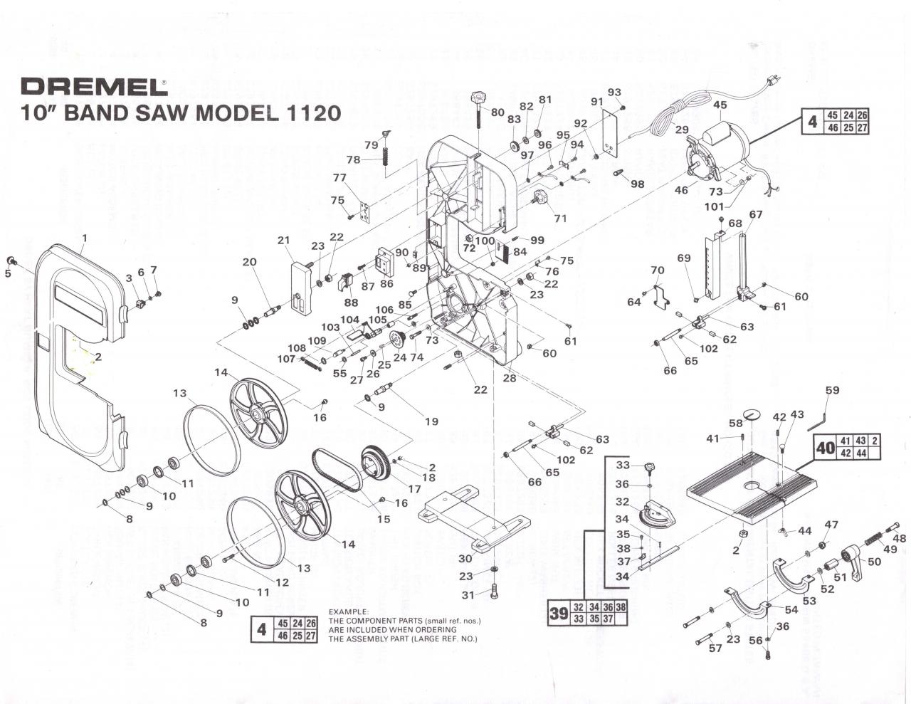

          You mentioned that your saw was coplanar out of the box. That is one problem I am still having with this one..its not and I haven't been able to find a good way to adjust the lower wheel. Its out far enough that I'm having trouble getting the blade to track. With the blade centered on the upper wheel its almost over the front edge on the bottom wheel. I tried shimming the bottom wheel out with washers on the 3 studs, but that threw the belt off....
          Any advice would be much appreciated
            • 3755
            The first thing that comes to mind, you don’t center the band on the wheel.
            The bottom drive wheel should not be adjustable. The top wheel has plenty of adjustment to track the band. If the wheels can’t be made coplanar, check to see if one wheel is not far enough, or too far on its axle. The drive wheel should have a key slot and the top wheel should be locked on its axle via the bearings.

                Remove the table and place a straight edge against both wheels. If they are out of kilter it will show up.
                I can’t think of any reasons the top wheel couldn’t be on backwards. They are usually attached at the factory and don’t come off easily.

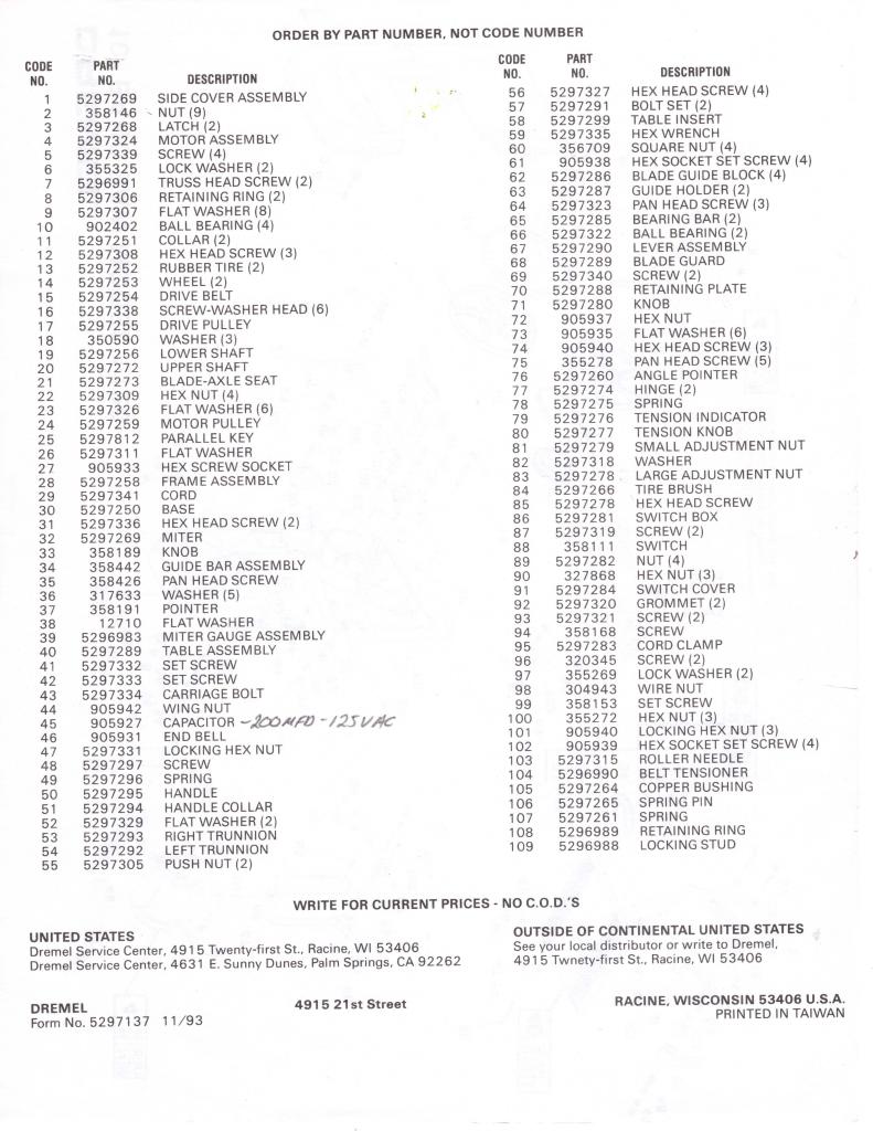

                  Don't know if this will help, but here are the parts list and the exploded assembly diagram for the 1120. There's nothing in the OM about setting up for coplaner alignment. Note the washer stacks on each side of the upper wheel. These are used to move the upper wheel in/out on the shaft. As for parts, if Dremel doesn't have anything anymore, perhaps Delta, Grizzly, or Rikon might as they made 10" 2 wheel saws that were duplicates of the 1120. Click image for larger version  Name:	Dremel 1120 Parts List Small.jpg Views:	0 Size:	130.0 KB ID:	837370Click image for larger version  Name:	Dremel 1120 Diagram Small.jpg Views:	0 Size:	136.6 KB ID:	837371

                    • 3755
                    Ken.
                    put the lower wheel with the drive pulley/belt back to factory spec and try to adjust the top wheel coplanar and the band should track properly. Do small adjustments without the drive motor operating . That’s probably the most important hint.

                      Jim, I do have that exploded view of parts. It does look as though there is no good way to adjust the lower wheel.
                      MPC, thanks, hey it was worth a shot! Brought to mind that commercial for MLB with the framing gun that goes on the attack.....
                      Carl, thank you for your suggestions. I am not actually new to band saws and their set up, just this particular band saw. (Before retiring I was a professional woodworker, now I work in smaller scale)
                      I cannot adjust the upper wheel to coplanar as it already projects outward further than the lower wheel. I will have to live with it. Yes, you would normally center the gullet but that isn't an option with a 1/2" blade on this saw. (This saw will be dedicated to resawing). Most saws out there have little quirks that owners find ways to work around and tweak things as needed and that info is usually easy to find.
