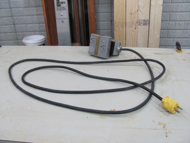

          I used to have a ShopVac that had a tool triggered outlet on it, but it was limited to something like 12 amps. If you plugged a tool into it that drew more, the vac would slow down so much that it didn't suck. It was good for sanders, but the BT3000, routers, and my Ryobi 10" CMS not so much. Since I use the ShopVac for all of the dust/chip collection in my shop, I made a tool triggered extension cord using a Craftsman tool triggered switch, an exterior duplex box, 12 ga. wire, and a magnetic plate. Normally, it's stuck on the frame of the BT3000, but easily moveable for other tools. ShopVac sells a universal adapter (p/n 906-87-00) that can be cut to fit an application. I've used these to adapt sanders to different hoses. It has diameters of 1" to 2 1/2".
          Click image for larger version  Name:	Tool Triggered Extension Cord.JPG Views:	0 Size:	61.4 KB ID:	836863
