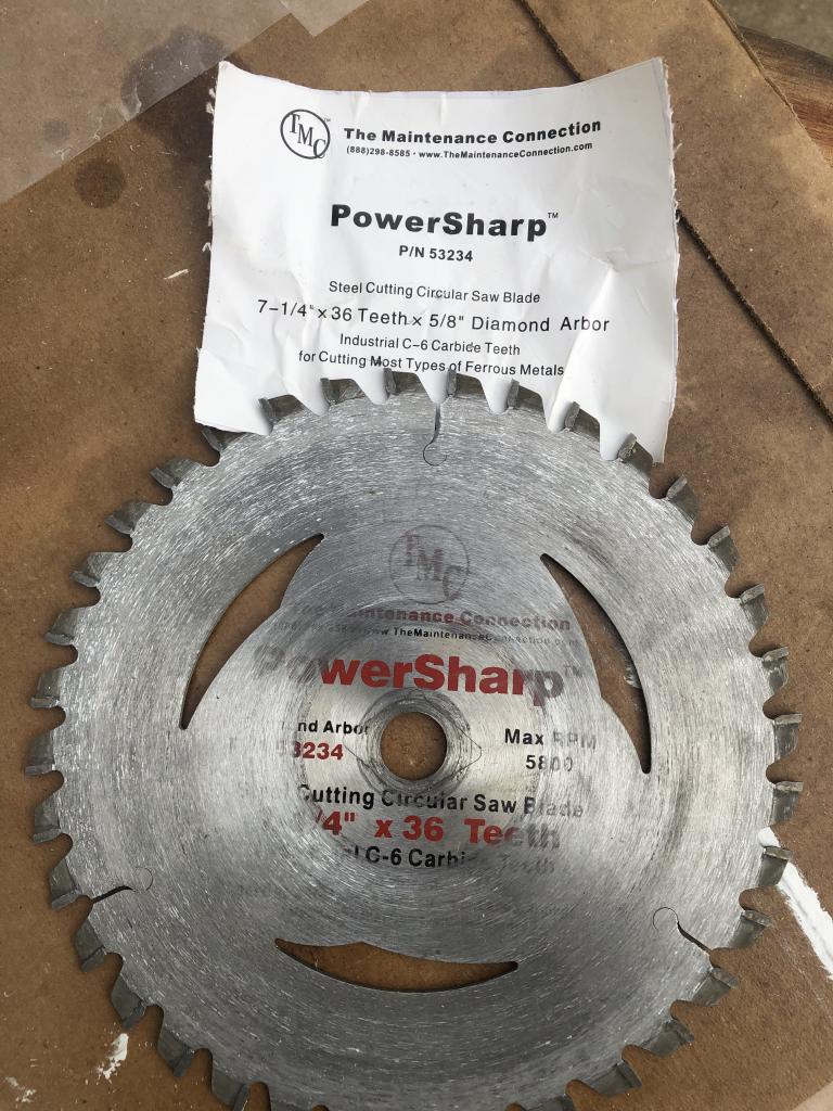

    I have a 7 1/4 blade made for cutting steel. The first demonstration I saw for this blade scared the heck out of us. One of our tool contractors on the Marine base I was working on put on a dog and pony show for our engineering group giving a demonstration on a carbide tipped metal cutting saw blade. He chucked a large piece of large carbon steel bar stock in a vice and started to cut it with a cheap looking orange Black and Decker circular saw. We gave this fool plenty of room! This cheap saw with its special blade cut through a steel bar the size of a car trailer hitch like it was pine. I made several cuts with this blade myself and was satisfied that it was not a hoax. I purchased the saw package that included the saw and 3 blades, which I shared with 2 co-workers, where I got 1 blade and the cheap orange b&d saw. I kept the saw because I’d didn’t want to submit my good saws to metal but I liked the cheap orange black and decker saw so much better than my Milwaukee or Skill saw that I put the metal blade in the Skill saw, put the Milwaukee in the duplicate tool closet and made the B&D my everyday saw. I use this blade any time I need to cut steel. I since learned that Lowe’s and other box stores offer simular metal cutting blades. With the proper blades and proper PPE cutting metal with a circular saw is nothing more than a brief “picker moment”, but after you get through that, ain’t nothing to it.
    If you like, I’ll photo the blade for you so you might be able to locate something simular.

            Photo of my metal cutting blade. It shows quite a bit of wear but is still incredibly sharp. I’ve cut numerous 1/4” wall square and rectangular tube carbon steel, several feet of 1/2” plate and the last time I used it was to cut about 1000 lf of 18 ga standing seam roofing. This is handy thing to have in the shop if you ever have to cut steel and need more than a hacksaw. I wouldn’t worry about damaging the saw either, I can’t tell and adverse wear on my Skil. The chips just shake out, I’ve not noticed any metal dust that might damage the bearings.

                I checked the web site on the TMC paper, they still have the same 3 blade and saw offer I purchased. Now it is $200, I’m not sure how you would order it as they previously were government sales only. If you could it wouldn’t be a bad buy.
