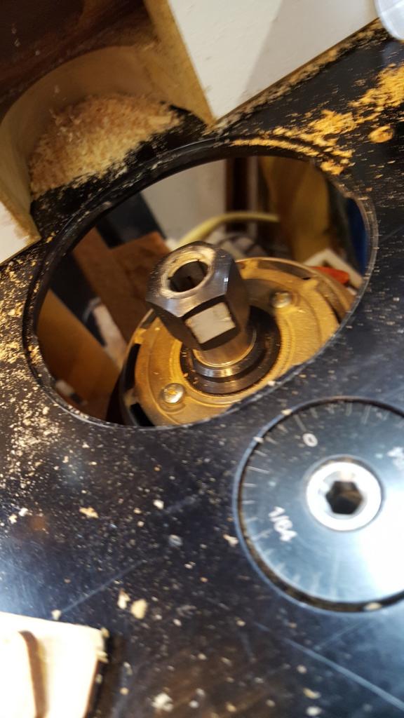

      Here's pics of the reflective tape mounted on a cordless screwdriver and a 1/2" Bosch 1617 collet.. I'm sure these have been there at least 5 years each with no signs of falling off or being worn out. Like I said, smaller would probably work fine as well.
      Click image for larger version  Name:	20190102_015456_resized.jpg Views:	1 Size:	53.9 KB ID:	835636
      Click image for larger version  Name:	20190102_015448_resized.jpg Views:	2 Size:	77.7 KB ID:	835637

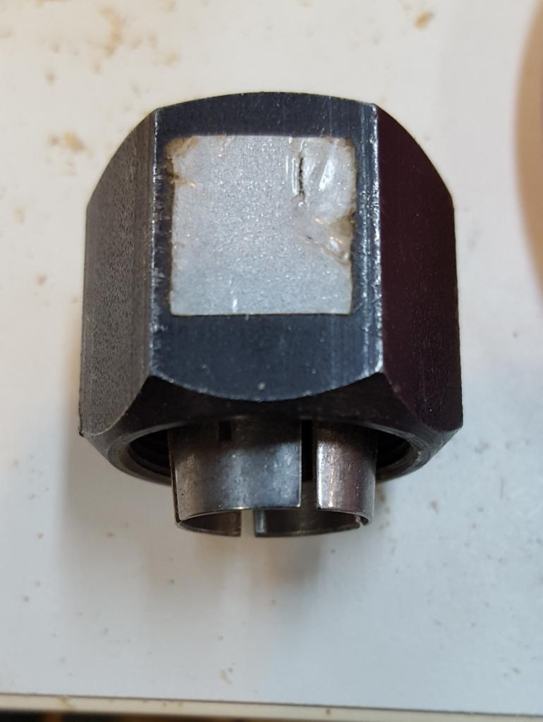

          Evidently the tape has been on my router for 11 years now and still hasn't fallen off.

                  Here's a better picture of the tape on the collet with 11 years of wear and tear. I was embarrassed by all the sawdust on it in the previous picture.
