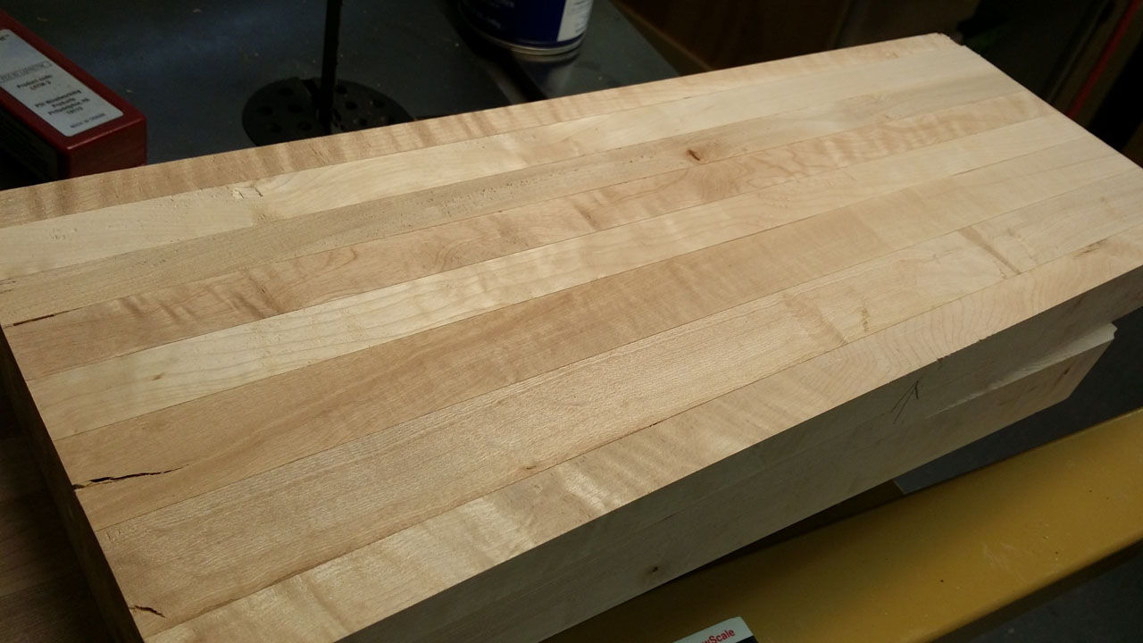

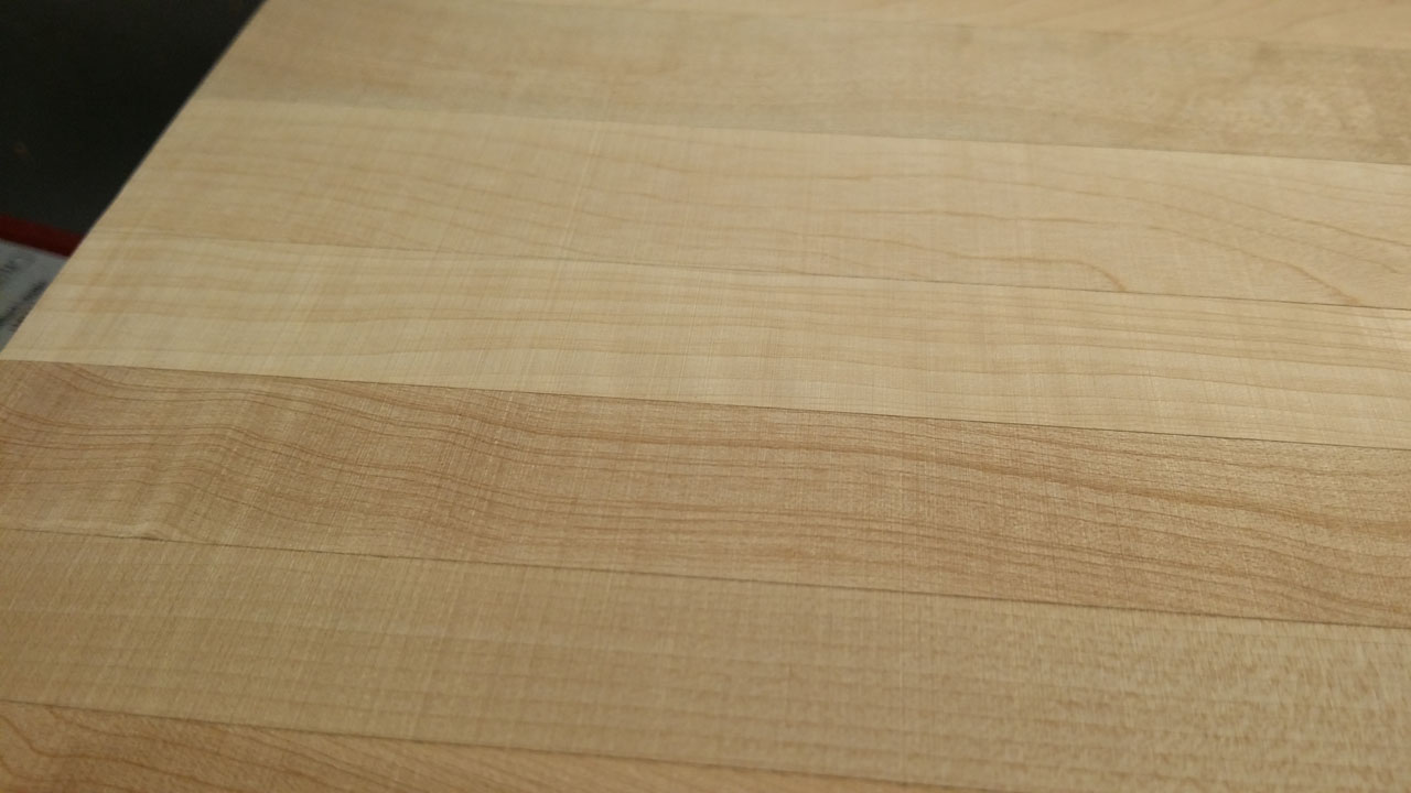

                        I didnt quite get the full test done but did get some glue ups through the sander with 80 grit. Here are some pics of before/after. its really hard to tell in this light maple especially in the before which is the one with the 2 boards stacked. You can see the planer tear out. the close up is after and you can see the marks running down the grain. I ran them through cross grain and it really shows up there. I didnt get a chance to run any higher grits and I did just order a roll of 36 grit to mill down some hard end grain oak board I just glued up. Not sure it will arrive before the weekend but will try it out as soon as I get it.
                        I did give it a good clean before I started and also blew some air through as it was sanding, I also found a few threads online from folks who had cut off/out the old 2.5" port and made up a 4" using some HVAC parts. I have them in hand so will add that to my shop todo list.
