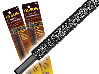

    In one of Loring's posts concerning getting the finish to the insides (cut-outs) of letters, there was one suggestion of using sandpaper strips that attached to the scroll saw in place of the blades. Anyone know of these?

    I have used the sanding strips that fit in the blade holder. They work good but teach you to slow down, maybe put in a finer tooth blade and not gap it up as much, Anything to reduce sanding. I've also clamped cloth sandpaper strips in my saw, that works also, but not as well as the commercial strips.

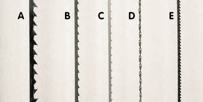

        As far as sanding, I have no good answer for you. I have not tried those sanding pads. Maybe I need to. My big problem is "fuzz" on the backside of the cut, similar to tiny blowout, if you will. If I'm doing a lot of stack cutting (which I do a lot of) I will put a sacrificial piece of 1/8" plywood on the bottom, which helps.

          Try a google search like this:
          https://www.google.com/webhp?sourcei...nding%20strips

            The backside fuzz can be reduced at the cut by using blades that have teeth that cut on the downstroke at the top of the blade and teeth that are inverted and cut on the upstroke on the bottom half inch of the blade at the table surface. See blade "A" below, it's called a reverse skip tooth blade
            1. Reverse Skip-tooth Blades. This blade is exactly like the regular skip- tooth blade, except the last few bottom teeth point upward. This is great for preventing tear- out or splintering on the bottom of the cut and for use with plywood. When using a reverse skip-tooth blade you must set the blade in the clamps so that only two or three teeth are pointing up above the tabletop when the saw arm is in its highest position. You may have to trim a little from the bottom of the blade to accomplish this.
            It's crucial you install this in the correct orientation!
            Also the backside fuzz can be taken off with an aggressive cut on a coarse belt sander. The fuzz will be of course on the very edge, taking a few mils (less than .005"?) off the backside of the finished piece with a 4" beltsander running 80 or 100 grit will clean it up pretty good in my experience.

              I just did a quick check and I see that Lee-Valley has sanding belts for scroll saws, along with a few other products. ( http://www.leevalley.com/us/ )
              Edit correction - Here's the link to the Lee-Valley page for sanding strips: http://www.leevalley.com/US/wood/pag...65&cat=1,42500
              and to the general scroll saw interest catagory: http://www.leevalley.com/US/Wood/Search.aspx?action=n

                There is one blade that I read about Saturday somewhere (and cannot find it now) that had teeth on the front and back side, not spiral either. This helped when going forwards and backwards (I am guessing) in some cutouts. I must look for that blade again.

                  Woodcraft sells sanding strips (but I have not tried them)
                  http://www.woodcraft.com/product/127...it-4-pack.aspx

                      • tfischer
                        • Jul 2003
                        • 2349
