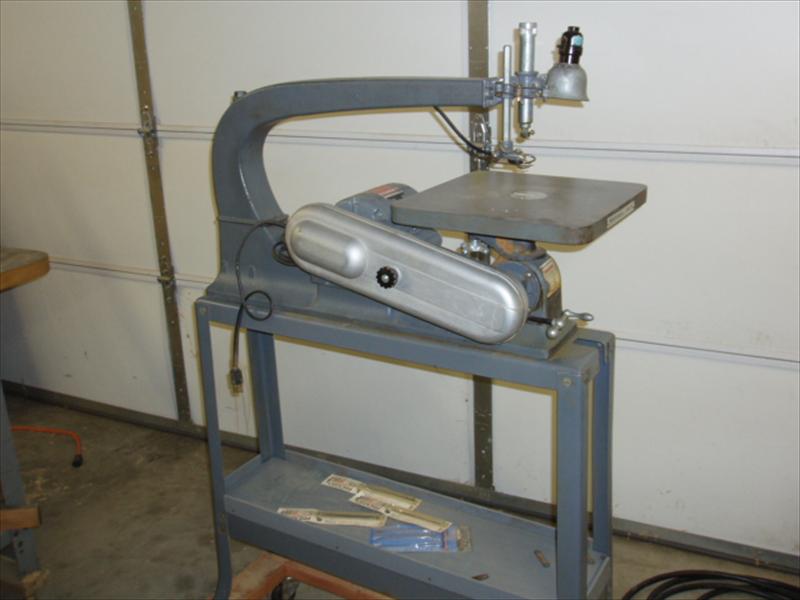

            I have an older (1940's) Delta scroll saw that I don't use that much. At a scroll saw demonstration somewhere I remember seeing a leg activated switch like the ones on cabinet model sewing machines. I liked that, no diddling with a switch or having to keep your foot in one place. I like to have my stool set close to the saw when I use it so it would fit my style perfect! Click image for larger version
              I have a deadman foot switch but don't use it for any tools.
              What I found is that you have to maintain a balance with the wood being fed and your weight on one foot and the other keeping pressure on the pedal and its all very fatiguing and uncomfortable (causing cramps like you say) and possibly even unsafe when using it with larger pieces that require shifting the body to feed the workpiece or move the saw.
              Frankly when I ordered that switch I went thru the same consideration of on-off vs deadman and decided the on-off really had no advantage.
              Just my two cents.
