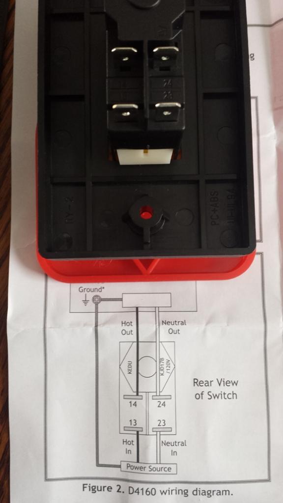

    I bought a new switch for my router table. This is probably a dumb question, but want to clarify. There is no ground on the switch and the diagram calls to run the ground from the power source to the "machine" which will be an outlet in my case.
    I assume I can connect the power side ground to the ground wire going from the switch to the outlet, then just ground that to the outlet?Click image for larger version
    Yes, you basically just connect all the grounds together.

        Your question makes no sense to me. YOu stated that the switch has no ground connection. Then you ask if you can connect "to the ground wire going from the switch to the outlet".
        from what you show there is no grounding on the switch, it does not have a metal enclosure.
        You can run a ground wire in the cable with the other interrupted wires at the switch, just running the ground past the switch without making a connection.

          I in this case All plastic encloser Plastic switches,No ground terminal on switches.You would just join the line& load Side grounds together.Capncarl it is never allowed to have 2 wires under1 screw.
