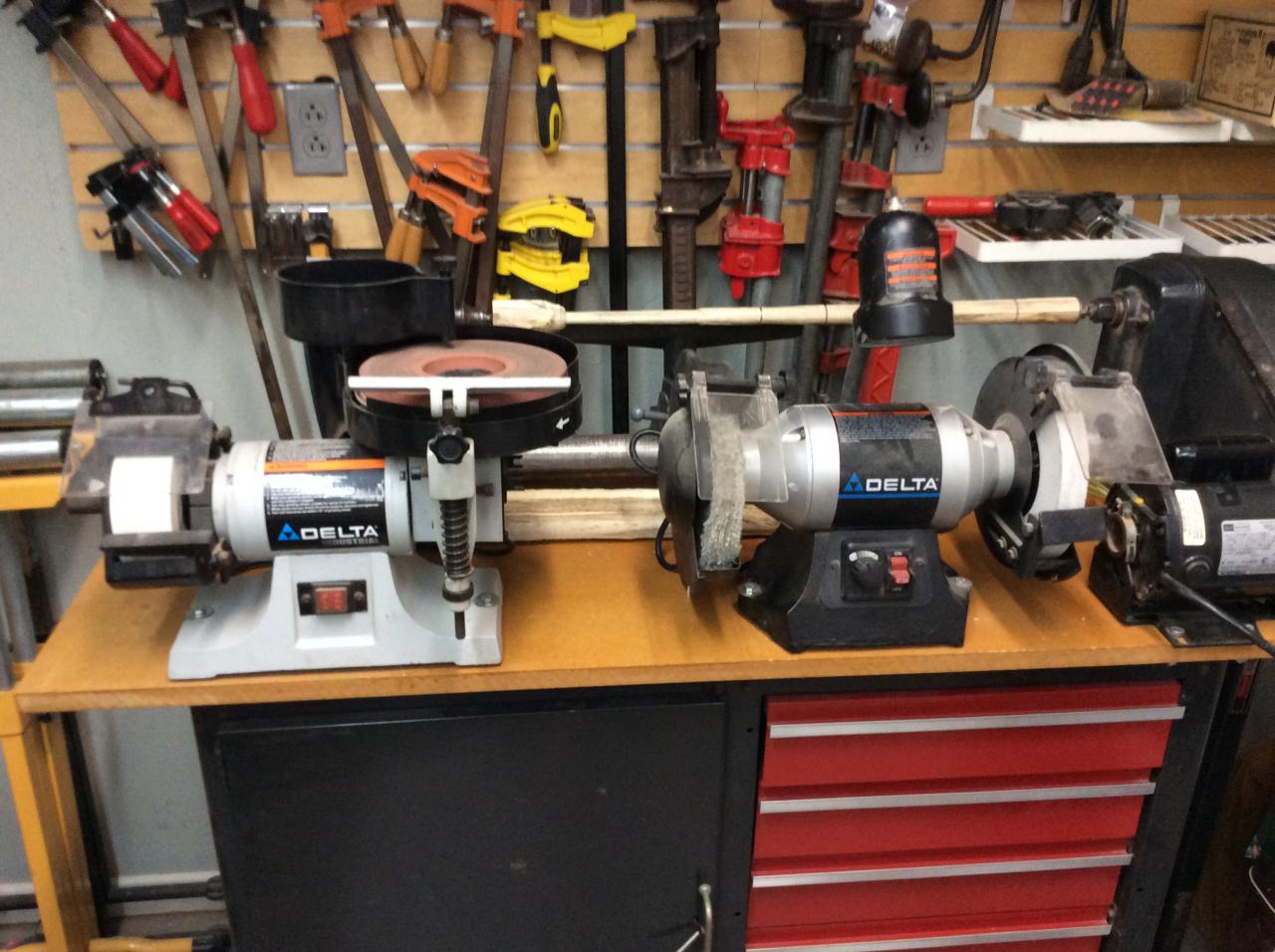

              I found these 2 Delta grinders on online for about $75 each and seem to be well made and suited for this purpose. Mod 23-710, dry wheel speed 3450, wet wheel speed 400. The other is mod GR450, variable speed 1725-3450.
