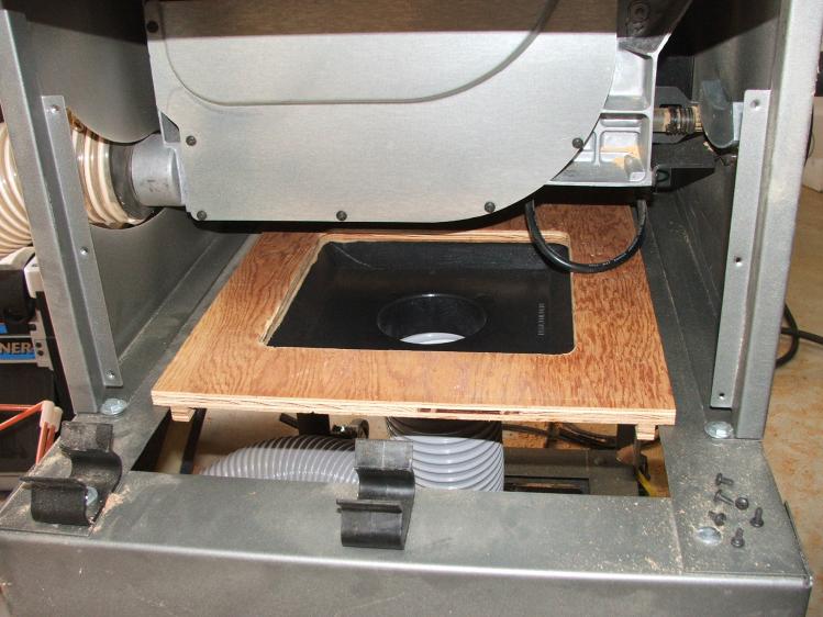

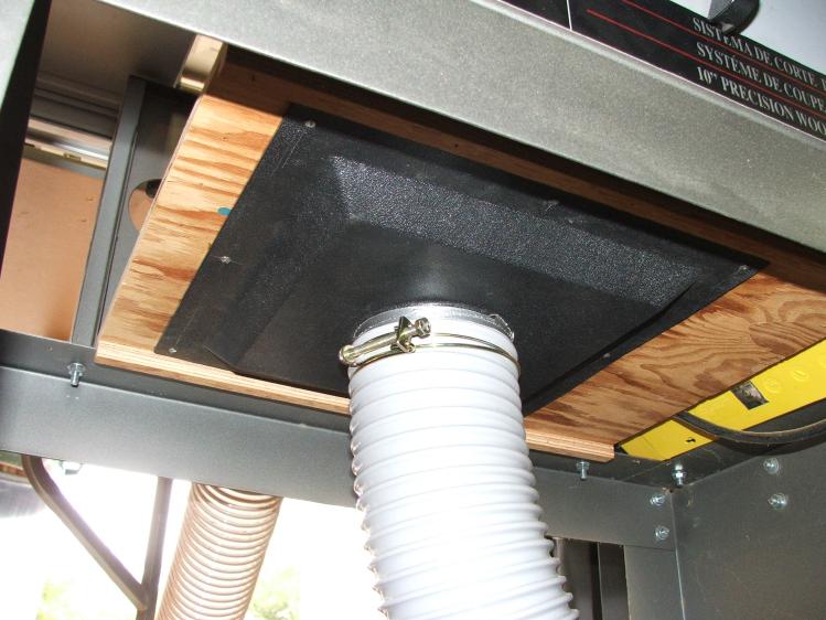

            The above link is all the pictures, below are copies of the ones where split at the HF 2HP DC to two 10-ft 4" hoses, one to a 2.25" reducer at the back and the other to a belly pan I loosely mounted under the saw.
            Really works great. I've thought about splitting the 4" hose to the rear to get a 2.25" hose to an overhead on my shark guard but I haven't done this yet.
            The cleanliness shown is after running this saw with the DC. The little pile of dist in the lower right web of the locker bracket was from before I installed the DC system.
            It keeps the internals of he saw real clean and I don't ever have to unjam the elevation screw.

              I like what you have done. Especially with the belly pan. Years ago I placed the saw in a cabinet I built. There is a dividing wall directly underneath the center of the saw which would create a problem for me. But I may have to rethink and remove the wall. Thanks for the pics.
